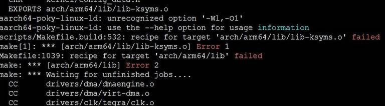

When you get error like below
run command then rebuild
$ unset LDFLAGS
The kernel image file, Image, is located in the directory "./arch/arm64/boot/". Start building kernel modules
