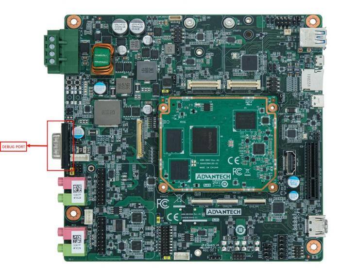

DEBUG Port Connection
1.Connect the debug port cable on AOM-DB3500.
2.Connect it to your PC with a USB to COM Cable.

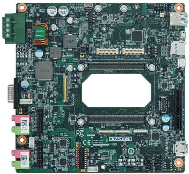

RS232——COM1_2
_img003-abaeae7460c966d5ef6b680c58d9d3c6.jpg)
| COM1_2 Connector, RS232 Mode Pin Definition |
| Pin |
| 1 |
| 2 |
| 3 |
| 4 |
| 5 |
| 6 |
| 7 |
| 8 |
| 9 |
| 10 |
| 11 |
| 12 |
| 13 |
| 14 |
| 15 |
| 16 |
| 17 |
| 18 |
| 19 |
| 20 |
