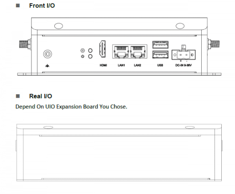

EPC-R7300 接口布局圖 Board Dimension Layout

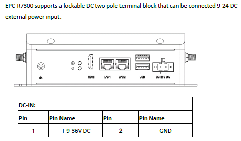

DC in
RTENOTITLE

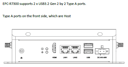

USB Ports
RTENOTITLE
RTENOTITLE

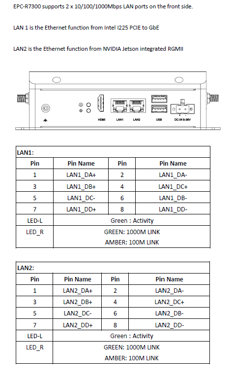

LAN Ports
RTENOTITLE

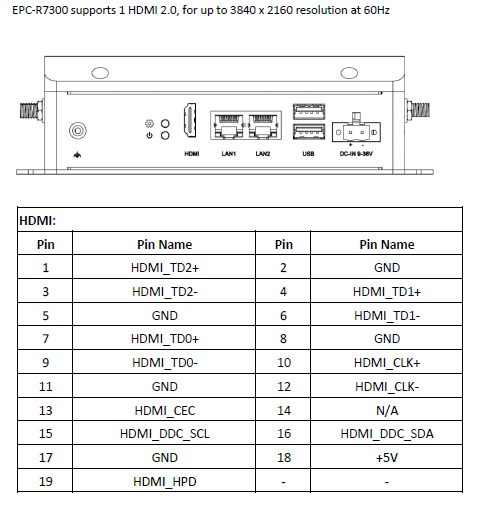

HDMI
RTENOTITLE

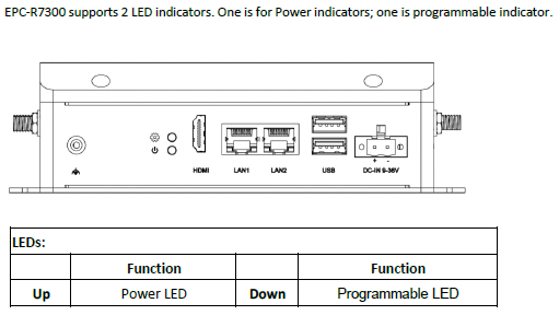

LED Indicator
RTENOTITLE

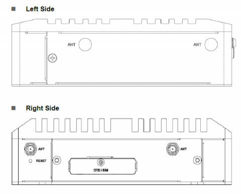

Side Door
RTENOTITLE

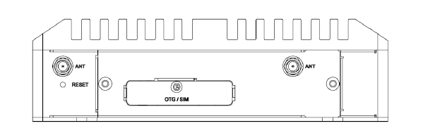

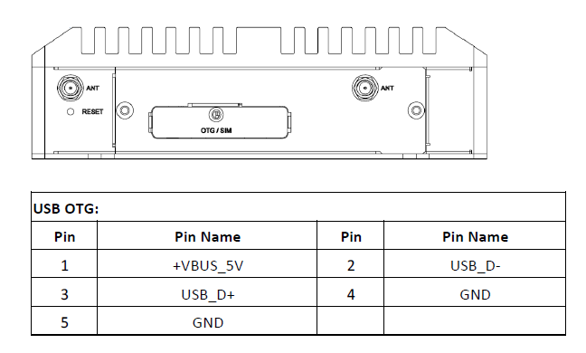

OTG Port
RTENOTITLE

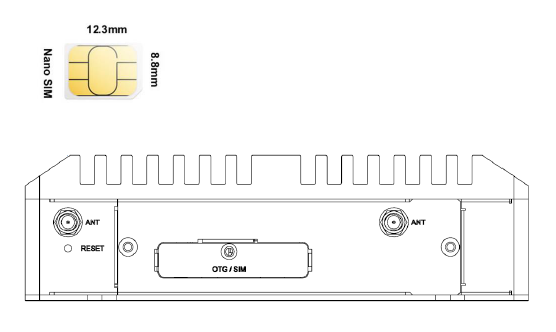

Nano SIM
RTENOTITLE

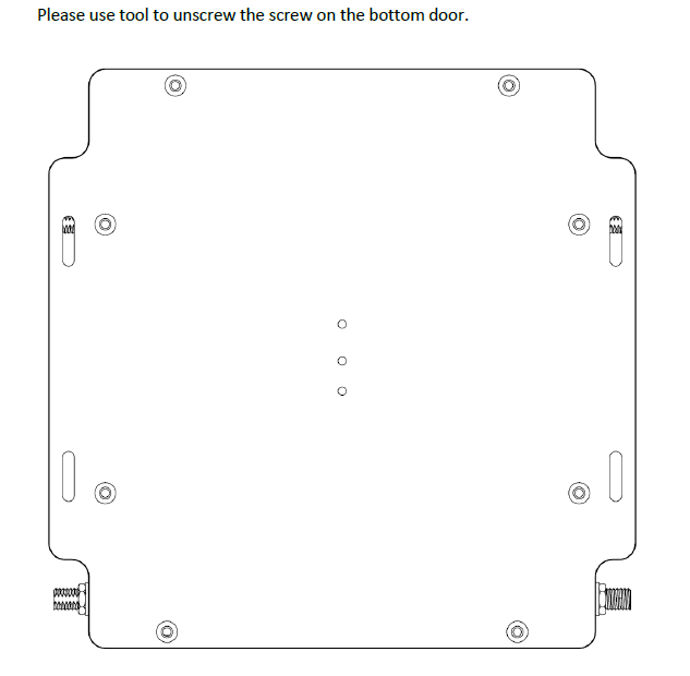

Bottom Door
RTENOTITLE

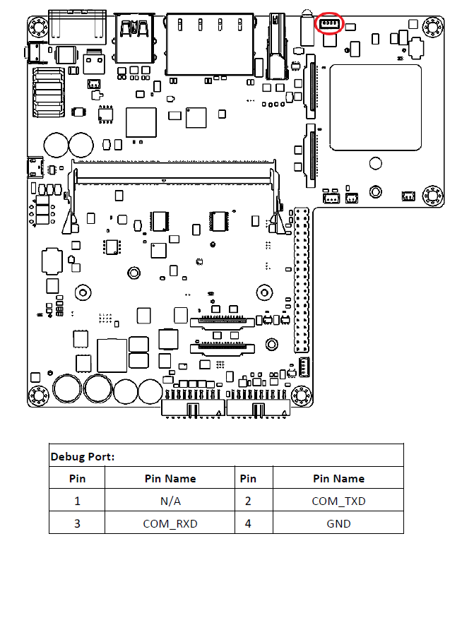

Debug Port
EPC-R7300 provides one Debug Port for development used. Debug cable P/N: 1700021565-01 4P-1.25 to D-SUB 9P (F) 60cm
RTENOTITLE

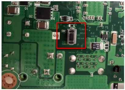

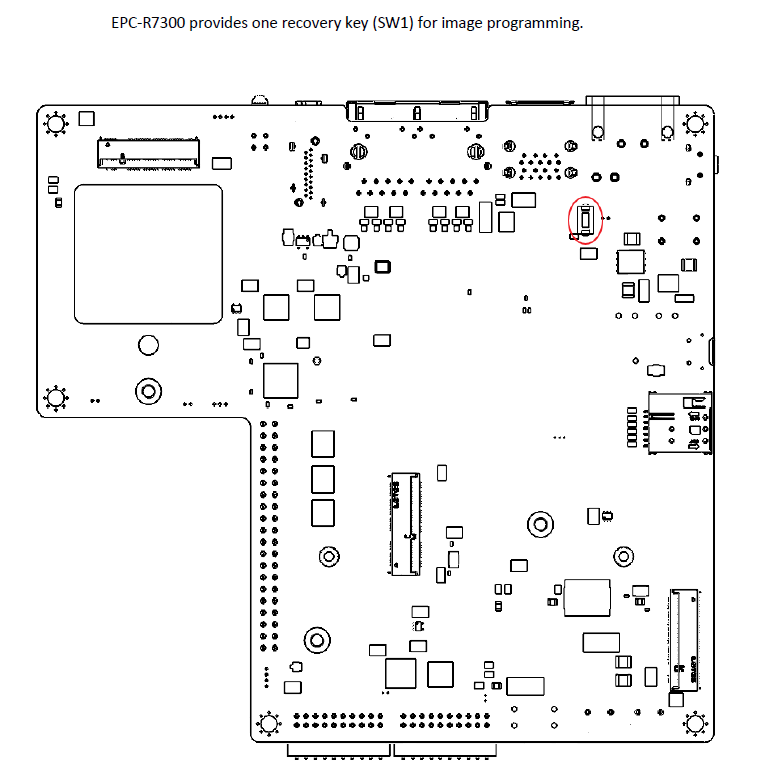

Recovery Key
RTENOTITLE

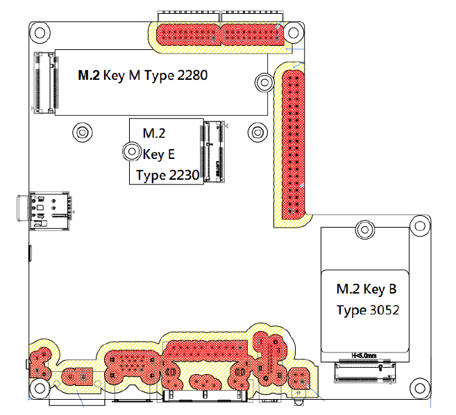

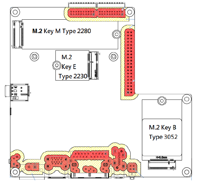

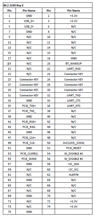

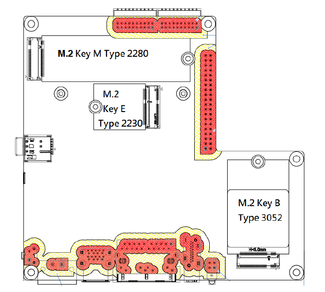

M.2 2230 Key E Slot
EPC-R7300 provides one M.2 2230 Key E Slot for WLAN card. P/N: EWM-W159M201E 802.11 ac/a/b/g/n + Bluetooth 5.0 M.2 2230 (A-E Key) Card
RTENOTITLE
RTENOTITLE
M.2 3042 Key B Slot
EPC-R7300 provides one M.2 3042 Key B Slot for WWAN card. P/N: AIW-355 DQ-E01 5G M.2 3052 (B Key) Card
RTENOTITLE
RTENOTITLE

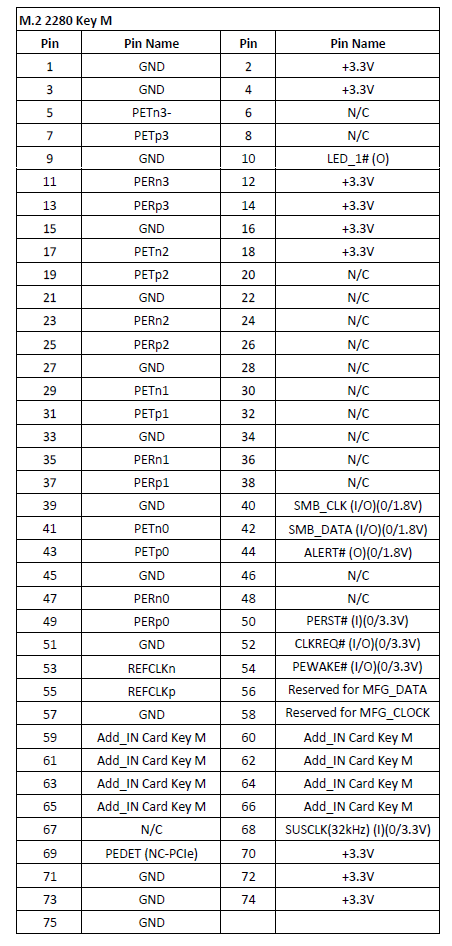

M.2 2280 Key M Slot
EPC-R7300 provides one M.2 2280 Key M Slot for NVMe card. P/N: SQF-C8MV2-128G-EDE 128G M.2 2280 (M Key) Card
RTENOTITLE
RTENOTITLE

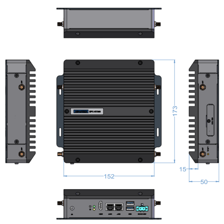

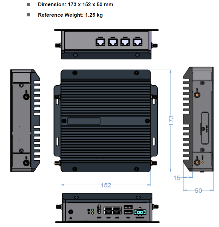

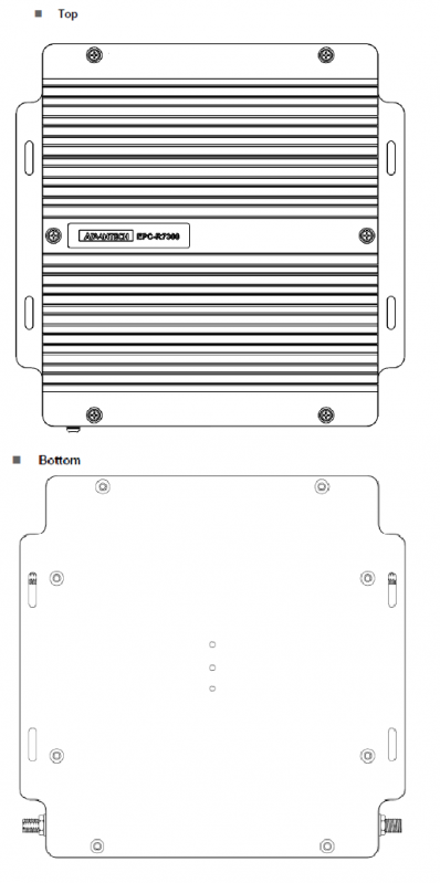

机械尺寸 (Mechanical Characteristics)
RTENOTITLE
RTENOTITLE

  1. Enter to recovery mode by holding the recover button (SW1) and plug power to boot. Release recover button around 3 seconds after plug in power.
RTENOTITLE

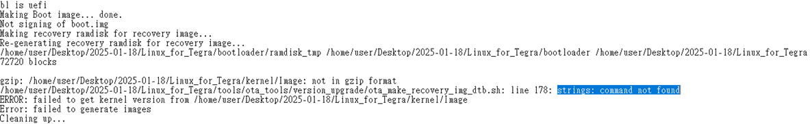

  1. Wait around 10~15 minute to flash image to device:
If you get the below "strings: command not found" error, please install "binutils"
$ sudo apt install binutils
RTENOTITLE

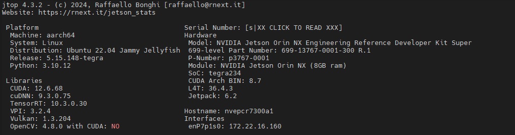

  • Install jtop
$ sudo apt update
$ sudo apt install python3-pip
$ sudo pip3 install -U jetson-stats
$ jtop
