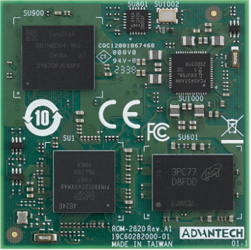

產品介紹
產品特性(Features)
  • NXP i.MX 93 Cortex-A55 Dual-core (up to 1.7GHz)
  • 1 x Arm Cortex-M33 core
  • 1 x Ethos®-U65 microNPU
  • 1 x 2GB LPDDR4X up to 3733MT/s
  • 1 x 4 lane MIPI-DSI
  • 2 x USB 2.0, 5 x UART, 4 x I2C, 16 x GPIO, 2 x PWM, 2 x CAN-FD
  • Compact size form factor - OSM Size L (45 x 45 mm)
  • Support Ycoto Linux

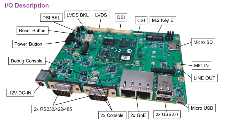

ROM-2820

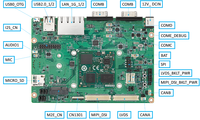

接口布局和尺寸(Layout and Sizes)
ROM-2820 接口布局圖 Board Dimension Layout
RTENOTITLE
ROM-ED93 接口布局圖 Board Dimension Layout
RTENOTITLE

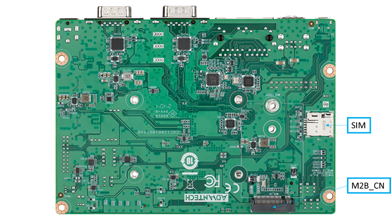

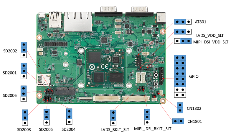

主板内置插针式引脚排序方式 (Pin Header defination)
Internal I/O, Jummper/Switch List:
PositionDescription
[AT801](./ROM-2820_Yocto42_User_Guide_wiki_data/AT801 "AT801".md)AT/ATX select header
[AUDIO1](./ROM-2820_Yocto42_User_Guide_wiki_data/AUDIO1 "AUDIO1".md)Line Out Connector
[BAT601](./ROM-2820_Yocto42_User_Guide_wiki_data/BAT601 "BAT601".md)Battery Connector
[CN1301](./ROM-2820_Yocto42_User_Guide_wiki_data/CN1301 "CN1301".md)Camera FPC connector
[CN1801](./ROM-2820_Yocto42_User_Guide_wiki_data/CN1801 "CN1801".md)CANA terminal resistor enable jumper
[CN1802](./ROM-2820_Yocto42_User_Guide_wiki_data/CN1802 "CN1802".md)CANB terminal resistor enable jumper
[CANA](./ROM-2820_Yocto42_User_Guide_wiki_data/CANA "CANA".md)CAN Bus Connector
[CANB](./ROM-2820_Yocto42_User_Guide_wiki_data/CANB "CANB".md)CAN Bus Connector
[COMA](./ROM-2820_Yocto42_User_Guide_wiki_data/COMA "COMA".md)RS232/422/485
[COMB](./ROM-2820_Yocto42_User_Guide_wiki_data/COMB "COMB".md)RS232/422/485
[COMC](./ROM-2820_Yocto42_User_Guide_wiki_data/COMC "COMC".md)COM A port wafer
[COMD](./ROM-2820_Yocto42_User_Guide_wiki_data/COMD "COMD".md)COM D port wafer
[COME_DEBUG](./ROM-2820_Yocto42_User_Guide_wiki_data/COME_DEBUG "COME DEBUG".md)Debug console wafer
[CN1601](./ROM-2820_Yocto42_User_Guide_wiki_data/CN1601 "CN1601".md)RJ45 1x2
[DCIN701](./ROM-2820_Yocto42_User_Guide_wiki_data/DCIN701 "DCIN701".md)12V DCIN connector
[DSI](./ROM-2820_Yocto42_User_Guide_wiki_data/DSI "DSI".md)DSI connector
[DSI_BKLT_PWR](./ROM-2820_Yocto42_User_Guide_wiki_data/DSI_BKLT_PWR "DSI BKLT PWR".md)DSI blacklight wafer
[DSI_BKLT_SLT](./ROM-2820_Yocto42_User_Guide_wiki_data/DSI_BKLT_SLT "DSI BKLT SLT".md)DSI blacklight power select
[DSI_VDD_SLT](./ROM-2820_Yocto42_User_Guide_wiki_data/DSI_VDD_SLT "DSI VDD SLT".md)DSI VDD power select
[GPIO](./ROM-2820_Yocto42_User_Guide_wiki_data/GPIO "GPIO".md)GPIO header
[I2S_CN](./ROM-2820_Yocto42_User_Guide_wiki_data/I2S_CN "I2S CN".md)Audio expander pin header
[LVDS](./ROM-2820_Yocto42_User_Guide_wiki_data/LVDS "LVDS".md)LVDS connector
[LVDS_BKLT_PWR](./ROM-2820_Yocto42_User_Guide_wiki_data/LVDS_BKLT_PWR "LVDS BKLT PWR".md)LVDS blacklight wafer
[LVDS_BKLT_SLT](./ROM-2820_Yocto42_User_Guide_wiki_data/LVDS_BKLT_SLT "LVDS BKLT SLT".md)LVDS blacklight power select
[LVDS_VDD_SLT](./ROM-2820_Yocto42_User_Guide_wiki_data/LVDS_VDD_SLT "LVDS VDD SLT".md)LVDS VDD power select
[M2B_CN](./ROM-2820_Yocto42_User_Guide_wiki_data/M2B_CN "M2B CN".md)M2 Key B connector
[M2E_CN](./ROM-2820_Yocto42_User_Guide_wiki_data/M2E_CN "M2E CN".md)M2 Key E connector
[MIC](./ROM-2820_Yocto42_User_Guide_wiki_data/MIC "MIC".md)MIC Connector
[SD_CARD](./ROM-2820_Yocto42_User_Guide_wiki_data/SD_CARD "SD CARD".md)Micro SD slot
[SD2001](./ROM-2820_Yocto42_User_Guide_wiki_data/SD2001 "SD2001".md)SDIO device select jumper
[SD2002](./ROM-2820_Yocto42_User_Guide_wiki_data/SD2002 "SD2002".md)SDIO device select jumper
[SD2003](./ROM-2820_Yocto42_User_Guide_wiki_data/SD2003 "SD2003".md)SDIO device select jumper
[SD2005](./ROM-2820_Yocto42_User_Guide_wiki_data/SD2005 "SD2005".md)SDIO device select jumper
[SD2004](./ROM-2820_Yocto42_User_Guide_wiki_data/SD2004 "SD2004".md)SDIO device select jumper
[SD2006](./ROM-2820_Yocto42_User_Guide_wiki_data/SD2006 "SD2006".md)SDIO device select jumper
[SIM](./ROM-2820_Yocto42_User_Guide_wiki_data/SIM "SIM".md)SIM card connector
[SPI](./ROM-2820_Yocto42_User_Guide_wiki_data/SPI "SPI".md)SPI pin header
[SW1001](./ROM-2820_Yocto42_User_Guide_wiki_data/SW1001 "SW1001".md)Boot select switch
[SW1002](./ROM-2820_Yocto42_User_Guide_wiki_data/SW1002 "SW1002".md)Reset button
[SW1003](./ROM-2820_Yocto42_User_Guide_wiki_data/SW1003 "SW1003".md)Power button
[SW1104](./ROM-2820_Yocto42_User_Guide_wiki_data/SW1104 "SW1104".md)COMA UART setting switch
[SW1103](./ROM-2820_Yocto42_User_Guide_wiki_data/SW1103 "SW1103".md)COMB UART setting switch
[USB1201](./ROM-2820_Yocto42_User_Guide_wiki_data/USB1201 "USB1201".md)USB2.0 2x1 Connector
[USB0_OTG1](./ROM-2820_Yocto42_User_Guide_wiki_data/USB0_OTG1 "USB0 OTG1".md)Micro USB Connector
RTENOTITLE
RTENOTITLE
RTENOTITLE

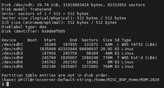

Step0: 檢查SD卡在Linux 環境的代號 (check SD card symbol in Linux system)
RTENOTITLE

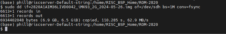

Step1: 創造一張可開機的SD 卡 (Create a bootable SD card)
Command :
sudo dd if=2820A1AIM36LIVD0042_iMX93_2G_2024-05-26.img of=/dev/sdh bs=1M conv=fsync
RTENOTITLE

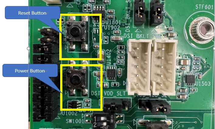

Step 5:  按下Power 開關 (Turn on Power , open terminal , then press the Power Button )
SW1003 : PWR_Button , SW1002: Reset_Button
RTENOTITLE

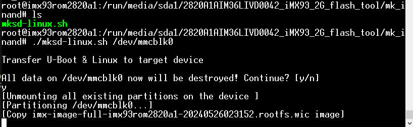

     4. 進入flsah tool下的mk_inand資歷夾, 執行指令./mksd-linux.sh /dev/mmcblk0燒錄image到eMMC(Connect USB Disk to ROM-2820 system, extract the flash tool and browser to mk_inand folder and execute flash shell script "./mksd-linux.sh /dev/mmcblk0"
解壓縮後如果沒有mksd-linux.sh檔案, 可以到以下連結下載並複製到mk_inand資料夾下(If there is no mksd-linux.sh file in mk_inand directory. Please download from the link below and place it in mk_inand directory:
下載 mksd-linux.sh
ROM-2820Device node
SD card/dev/mmcblk1
eMMC/dev/mmcblk0
RTENOTITLE

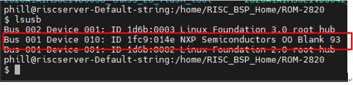

Connect OTG to Ubuntu System(x86 PC)  , make sure the device was identified
RTENOTITLE

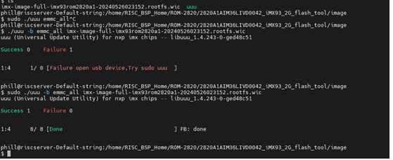

Type command below to flash eMMC:
tar -xvzf 2820A1AIM36LIVD0042_iMX93_2G_flash_tool.tgz
cd 2820A1AIM36LIVD0042_iMX93_2G_flash_tool/image/
sudo ./uuu -b emmc_all imx-image-full-imx93rom2820a1-20240321094239.rootfs.wic
RTENOTITLE

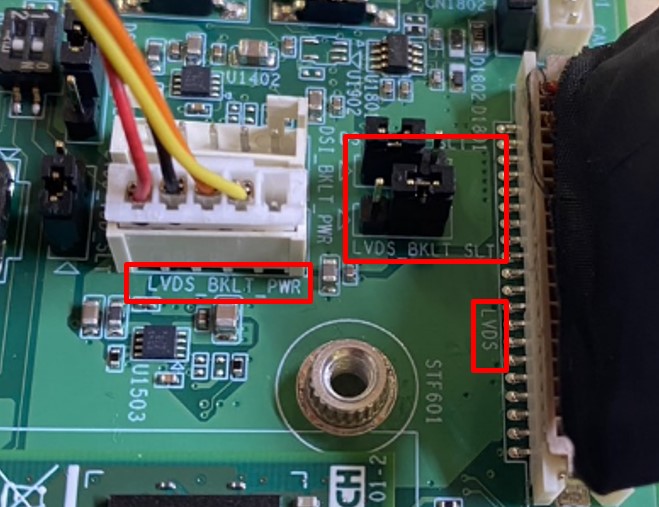

LVDS
Single Channel LVDS: G070VW01 (VDD: 3.3V, Backlight Power: 12V)
Step 1: Connect G070VW01 LVDS panel with the LVDS cable. Connect this to the LVDS. Connect the Backlight cable to LVDS_BKLT_PWR.
Step 2: Connect another 12V adapter to the DC-Jack on the backlight cable.
Step 3: Power on RSB-2820 and the extra 12V adapter.

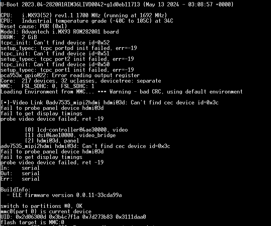

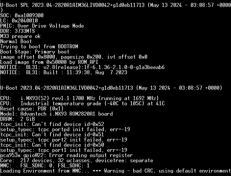

Step 4: Press enter after boot. The system will stop at u-boot as demonstrated below, enter the command in red and press enter.
RTENOTITLE
(LVDS_BPLT_SLT : 2&3 jumper short)
Normal Boot
Hit any key to stop autoboot:  0
=> setenv fdtfile imx93-rom2820-a1-lvds.dtb
=> saveenv
=> boot

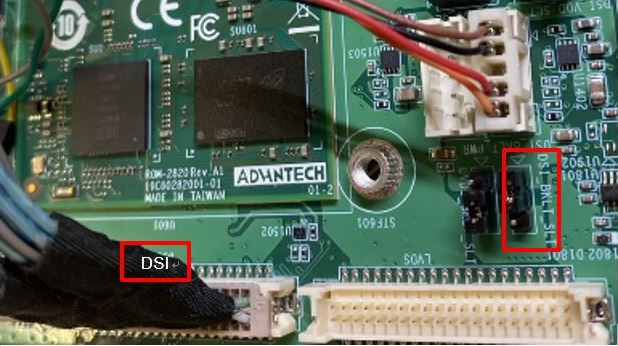

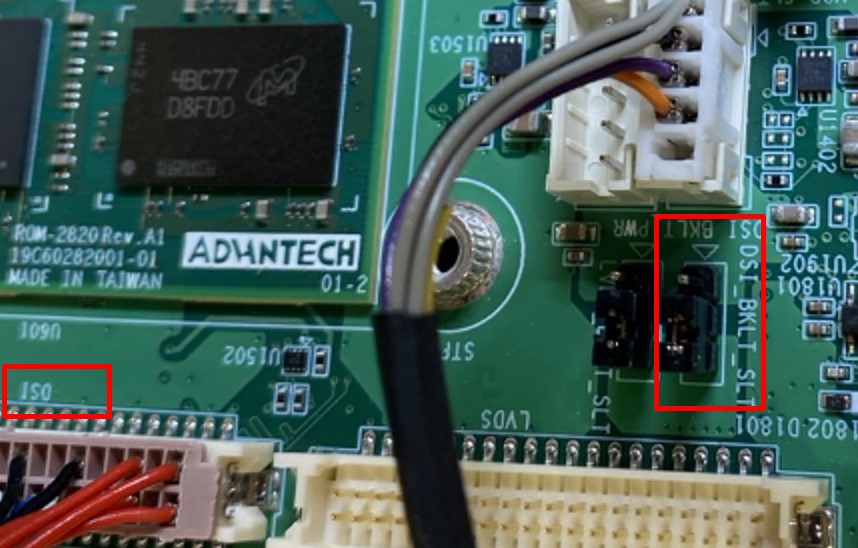

MIPI DSI
Single Channel LVDS: G101UAN02.0 (VDD: 3.3V, Backlight Power: 12V)
Step 1: Connect G101UAN02.0 LVDS panel with the LVDS cable. Connect this to theLVDS. Connect the Backlight cable to DSI_BKLT_PWR.
RTENOTITLE
(DSI_BKLT_SLT: 2&3 jumper short)
Normal Boot
=> setenv fdtfile imx93-rom2820-a1-auog101uan02.dtb
=> saveenv
=> boot

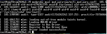

Step 3: Install driver by below command.
modprobe moal mod_para=nxp/wifi_mod_para.conf
RTENOTITLE

Step1 :You need to connect two antennas.
Step2 : Uboot command
  1. setenv fdtfile imx93-rom2820-a1-m2-sdio.dtb
  2. saveenv
  3. reset
Step 2: Install driver by below command.
#modprobe moal mod_para=nxp/wifi_mod_para.conf
 Step3: 4G test command.
# stty -F /dev/ttyUSB1 speed 115200 -echo
# cat /dev/ttyUSB1 &
# echo "AT+CSQ" > /dev/ttyUSB1
Console message:
AT+CSQ
+CSQ: 25,99
OK
# pppd connect 'chat -v -s -t 10 "" "AT" "" "ATDT*99#" "CONNECT" ""' user username password password /dev/ttyUSB2 460800 nodetach crtscts debug usepeerdns defaultroute &
# ping 8.8.8.8

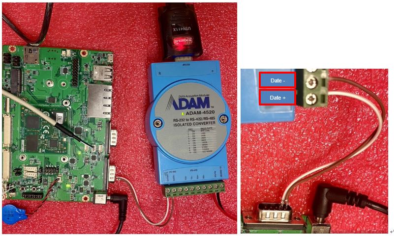

RS-485
RS-485 Test:
Step 1: Test RS-485 with Adam-4520. Connect Adam-4520 with COMA with DB9 as the following(COMA(ttyLP4)&COMB(ttyLP5))
Adam-4520 RX- ROM-2820 COMA DB9 Pin  1,
Adam-4520 RX+ ROM-2820 COMA DB9 Pin  2,
Adam-4520 TX- ROM-2820 COMB DB9 Pin   1,
Adam-4520 TX+ ROM-2820 COMB DB9 Pin  2
RTENOTITLE
Step 3: Run below command:
stty -F /dev/ttyLP0 speed 115200 ignbrk -brkint -icrnl -imaxbel -opost -onlcr -isig -icanon -iexten -echo -echoe -echok -echoctl -echoke
cat /dev/ttyLP0 &
echo "Serial Test" > /dev/ttyLP0
Step 2 :Create the following file and save it as rs485.sh
#!/bin/sh
i2cset -y -f 4 0x21 0x00 0x10
i2cset -y -f 4 0x21 0x01 0x01
i2cset -y -f 4 0x21 0x02 0xdf
i2cset -y -f 4 0x21 0x03 0xfd
i2cset -y -f 4 0x21 0x04 0x00
i2cset -y -f 4 0x21 0x05 0x00
i2cset -y -f 4 0x21 0x06 0xcf
i2cset -y -f 4 0x21 0x07 0xfc
# sudo chmod 775 rs485.sh
# ./rs485.sh
# stty -F /dev/ttyLP4 -echo -onlcr 115200
# cat /dev/ttyLP4 &
# echo "Serial Port Test" > /dev/ttyLP4
Step 4: You need to open two terminals: one to connect to the debug port of the ROM2820, and the other to connect to the Adam-4520.
Step 5:You can send data from the ROM2820's debug port to the Adam-4520, and you can also input text from the Adam-4520's terminal using the keyboard so that the ROM2820's debug port can receive it.
RTENOTITLE

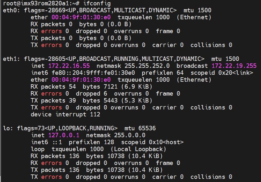

乙太網路使用方法(Ethernent Testing Method)
Command : ifconfig
RTENOTITLE

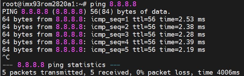

Command: Ping - I eth1 8.8.8.8  or Ping - I eth0 8.8.8.8
RTENOTITLE

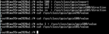

GPIO loop test:
Connect GPIO pin#3 and GPIO pin#4
root@imx93rom2820a1:/# echo 498 > /sys/class/gpio/export
root@imx93rom2820a1:/# echo 499 > /sys/class/gpio/export
root@imx93rom2820a1:/# echo out > /sys/class/gpio/gpio498/direction
root@imx93rom2820a1:/# echo in > /sys/class/gpio/gpio499/direction
root@imx93rom2820a1:/#cat /sys/class/gpio/gpio498/value
0
root@imx93rom2820a1:/# echo 1 > /sys/class/gpio/gpio498/value
root@imx93rom2820a1:/# cat /sys/class/gpio/gpio498/value
1
RTENOTITLE
Connect GPIO pin#5 and GPIO pin #6
root@imx93rom2820a1:/# echo 500 > /sys/class/gpio/export
root@imx93rom2820a1:/# echo 501 > /sys/class/gpio/export
root@imx93rom2820a1:/# echo out > /sys/class/gpio/gpio500/direction
root@imx93rom2820a1:/# echo in > /sys/class/gpio/gpio501/direction
root@imx93rom2820a1:/# cat /sys/class/gpio/gpio500/value
0
root@imx93rom2820a1:/# echo 1 > /sys/class/gpio/gpio500/value
root@imx93rom2820a1:/# cat /sys/class/gpio/gpio501/value
1

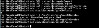

Connect GPIO pin#11 and GPIO pin#12
root@imx93rom2820a1:/# echo 506 > /sys/class/gpio/export
root@imx93rom2820a1:/# echo 507 > /sys/class/gpio/export
root@imx93rom2820a1:/# echo out > /sys/class/gpio/gpio506/direction
root@imx93rom2820a1:/# echo in > /sys/class/gpio/gpio507/direction
root@imx93rom2820a1:/# cat /sys/class/gpio/gpio507/value
0
root@imx93rom2820a1:/# echo 1 > /sys/class/gpio/gpio506/value
1
RTENOTITLE
