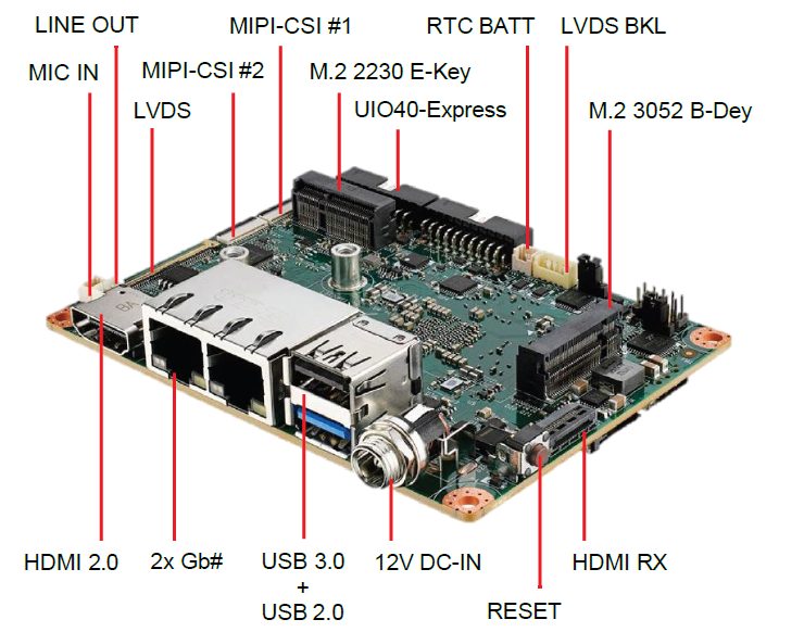

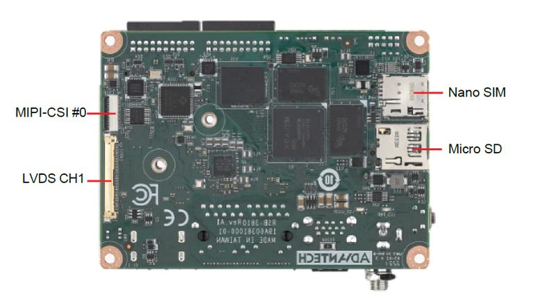

接口布局和尺寸(Layout and Sizes)​
RSB-3810 接口布局圖 Board Dimension Layout​
Jumper list:
BL0Backlight Power Select for LVDS0 (Default 5V)
VDD0LVDS VDD (Default 3.3V)
Connectot list:
BATRTC Battery CONN
BL0LVDS Backlight
COM1Debug Console + RS232/RS485
CSI0MIPI-CSI Camera Input 0
CSI1MIPI-CSI Camera Input 1
CSI2MIPI-CSI Camera Input 2
DCIN/DCIN112V DC Power Input by DC Jack/ by Pin Header
HDMIHDMI CONN
LVDS0LVDS Channel 0 CONN
LVDS1LVDS Channel 1 CONN
M2M.2 Key E CONN
MICMIC In Pin Header
M2BM.2 Key B CONN
RSTReset Button
SDSD Slot
SIMSIM Slot
UIO1UIO40-Express Pin Header 1
UIO2UIO40-Express Pin Header 2
USB1USB CONN. (USB 3.2 Gen 1 on TOP + USB 2.0 on BOT)
DL_KEYDownload Key

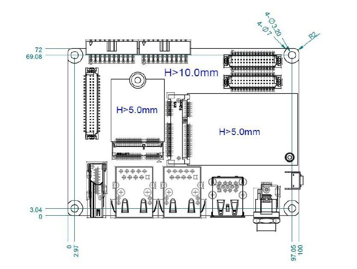

机械尺寸 ( Mechanical Characteristics)​

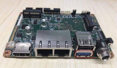

  1. RSB-3810 debug port is shared with COM1. Please connect the debug console cable 1700034345-01 & 1700019474. Then connect the USB-to-RS232 Cable to your PC terminal. Connect the cable to COM1 pin header to the nearby the HDMI connector.
2. RSB-3810 can communicate with a host server using serial cables. Common serial communication programs such as HyperTerminal, Tera Term or PuTTY can be used in such applications. The example demonstrated below describes the serial terminal setup using Tera Term on a Windows host: Open Tera Term on your Windows PC, set the Baud rate to 921600.

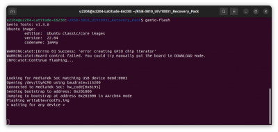

燒錄方法 (Flash eMMC Method)​
Password: ubuntu
Recovery Ubuntu:
Prepare:

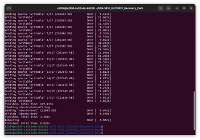

  1. Prepare a Ubuntu 22.04 recovery image.
  2. Follow the link to install the MediaTek flash tool “ genio-tools on a Ubuntu 22.04 x86 PC.

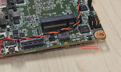

  3. USB typeA to typeA cable
  4. USB typeA port, download and reset button information (screenshot below mark by color red)

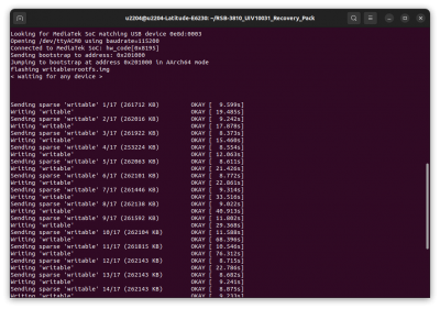

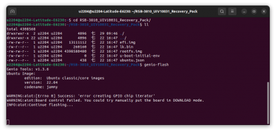

Flash steps:
  1. To connect USB typeA to typeA cable to the host computert and the RSB-3810 typeA port
  2. To extract the Ubuntu recovery image:
  3. cd recovery package
  4. Run "genio-flash"
  5. Turn the RSB-3810 board power on
  6. press Download button and hold it
  7. Press and release the reset button
  8. Release the Download button after the tool outputs "< waiting for any device >"
  9. The flash tool will continue to flash recovery image.

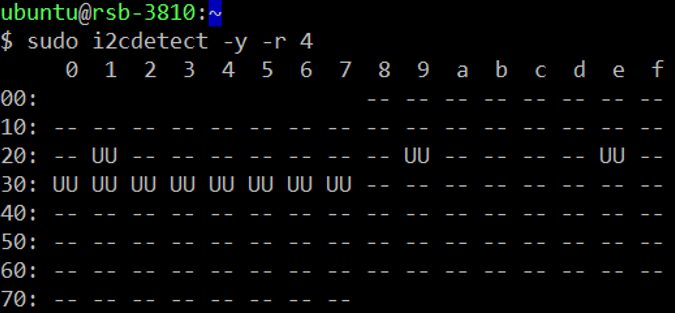

I2C使用方法(I2C Test Method):​
Step 1: Check i2c device
Step 2: I2c set and get
console:/ # i2cdetect -y -a 4

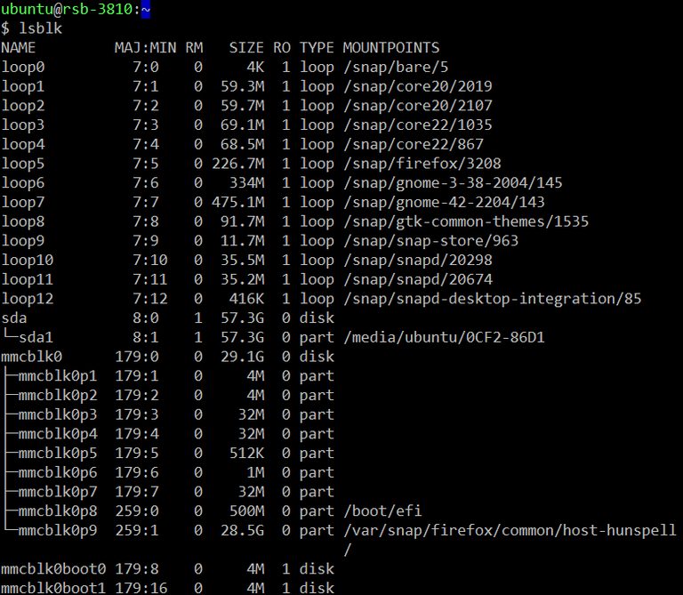

USB: USB disk test (USB 2.0/ USB 3.2 Gen 1 By 1 port)​
check if the USB device is mount automatically
lsblk
if USB device is not mount automatically
use /dev/sda1 as example
sudo mkdir -p /mnt/tmp
sudo mount /dev/sda1 /mnt/tmp

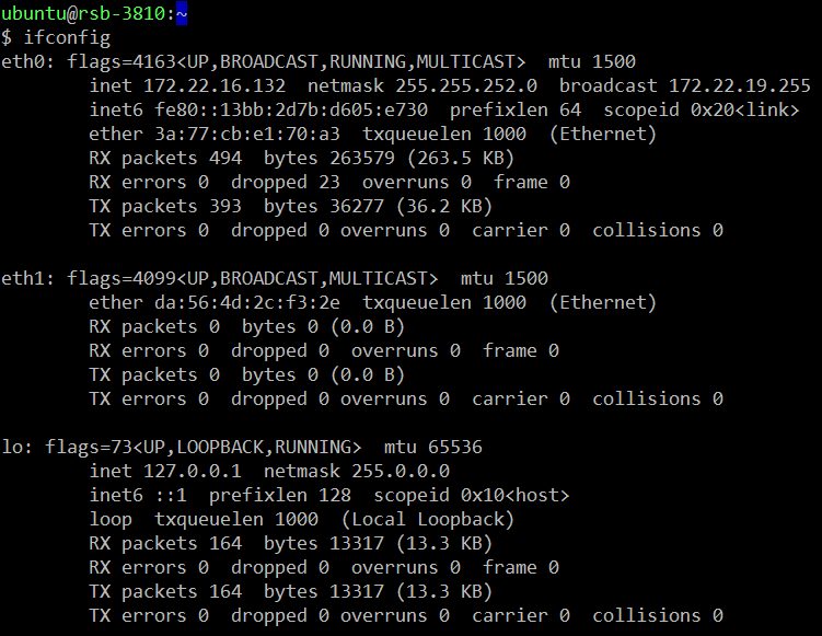

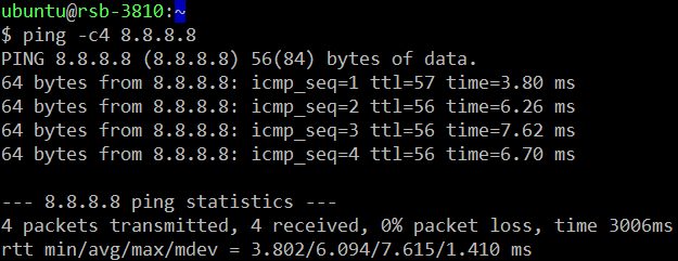

Ethernet使用方法(Ethernet Testing Method):​
Step 1: Check the Ethernet device
ifconfig
Step 2: Connect the cable and ping test (eg. Eth0)
ping -c4 8.8.8.8
