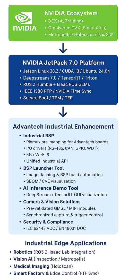

4. DeepStream, AI Inference, and Visualization Tools​
NVIDIA DeepStream 7.0 is the foundation for AI-powered video analytics on Jetson. It supports multiple neural networks, streaming sources, and sensor modalities in parallel with optimized data pipelines leveraging TensorRT, CUDA, and DLA cores.
With Triton Inference Server integration, JetPack 7.0 enables simultaneous deployment of heterogeneous models—from CNNs to transformers—while dynamically optimizing GPU resource allocation.
Advantech extends this ecosystem by offering a GUI-based AI Inference Demo Tool that:
  • Allows users to deploy DeepStream and TensorRT models without coding.
  • Provides visualization of inference results and frame latency.
  • Displays CPU, GPU, and DLA utilization in real time.
This bridges technical evaluation and business demonstration, helping customers rapidly assess JetPack’s AI capabilities in industrial environments.
5. Camera and Vision Solutions​
JetPack 7.0 delivers a robust vision stack supporting V4L2, Argus, and GStreamer, compatible with MIPI CSI and GMSL 2/3 interfaces. It also supports hardware-accelerated preprocessing through PVA (Programmable Vision Accelerator) and IPS pipelines for real-time image transformation.
Advantech collaborates with industrial camera vendors to offer pre-validated GMSL camera solutions, ensuring consistent performance and synchronized operation with Jetson Thor. Through the integration, users can control sensor synchronization, triggering, and exposure alignment, complementing NVIDIA’s Holoscan Sensor Bridge and Isaac ROS for high-precision data capture and time alignment.
6. Robotics, ROS 2, and Isaac Integration​
JetPack 7.0 is fully integrated with ROS 2 Humble, Isaac ROS GEMs, and NVIDIA Isaac Sim or Isaac Lab, enabling simulation-to-reality workflows. Developers can leverage GPU-accelerated SLAM, 3D perception, path planning, and motion control through Isaac and DeepStream.
Advantech extends this with ROS nodes for industrial interfaces such as digital I/O, UART, CAN, GPIO, and PWM, simplifying integration between robots and industrial automation systems. Through interoperability with NVIDIA Omniverse OVX and DGX AI platforms, JetPack users can perform model training with TAO or NIM, optimization through CUOpt, and real-time simulation, then deploy results directly to Jetson hardware for a consistent AI pipeline from cloud to edge.
