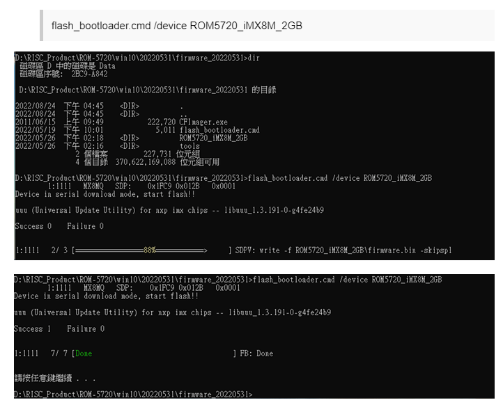

3-2. Extract the zip file (firmware_20220531.7z) in the folder 20220531 and flash firmware into eMMC.
RTENOTITLE
RTENOTITLE

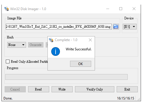

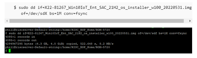

3-3. Prepare 8GB SD card for flashing OS installer in Linux operating system and Windows operating system.
A.In Linux operating system:
RTENOTITLE
RTENOTITLE
RTENOTITLE
RTENOTITLE

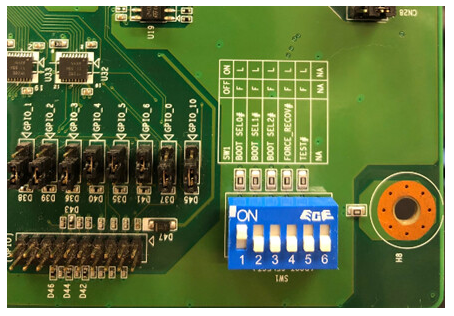

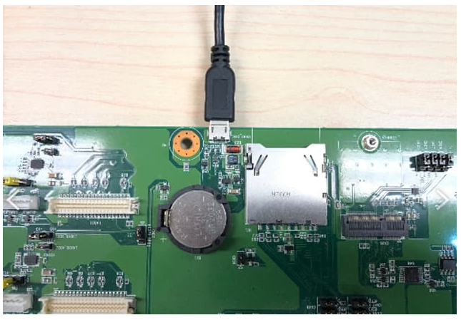

3-4. Flash boot loader to eMMC
A. Set up the jumper on the development board ROM-DB5901for SD boot. (OFF-OFF-OFF-ON-OFF-OFF)
RTENOTITLE
RTENOTITLE
RTENOTITLE

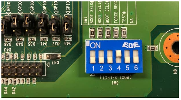

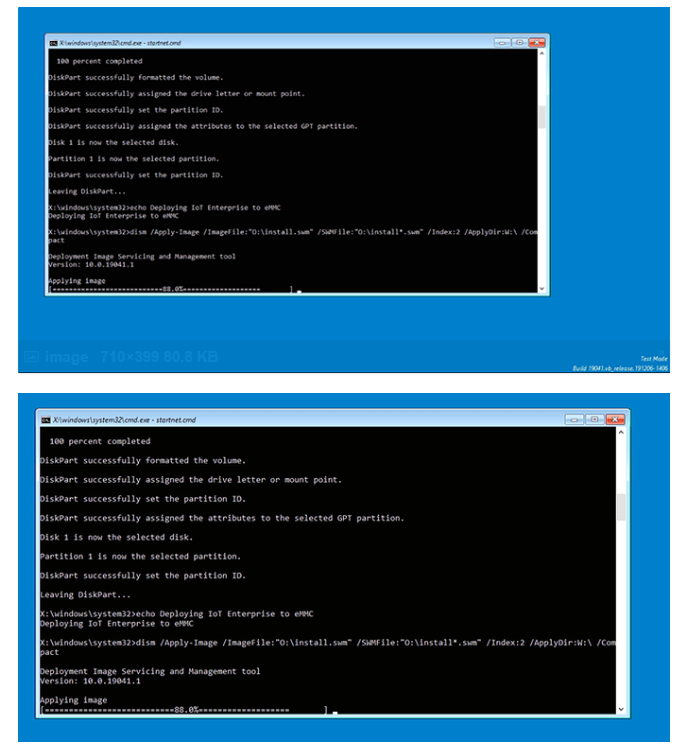

3-5. Flash Windows IoT to eMMC
A. Set up the jumper on the evaluation carrier board ROM-DB5901 to EMMC boot (ON-OFF-OFF-OFF-OFF-OFF).
RTENOTITLE
RTENOTITLE
RTENOTITLE

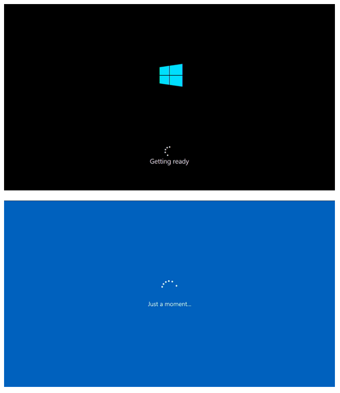

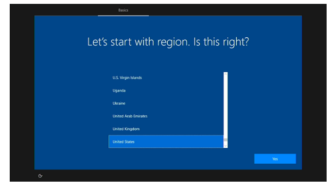

The system will reboot again and enter the setup process.
RTENOTITLE

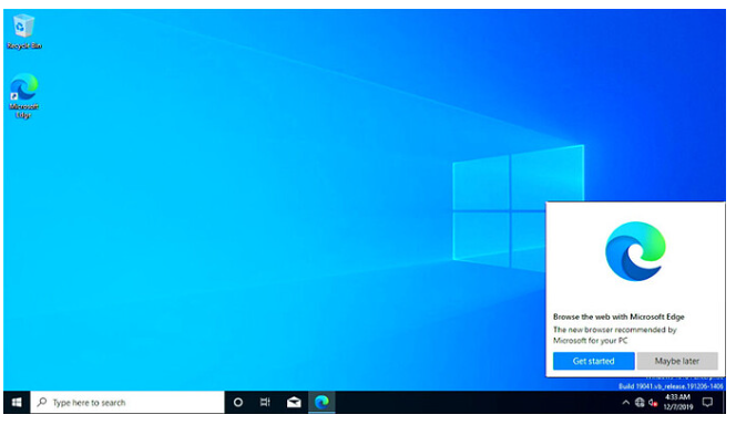

You will see the Window 10 IoT enterprise desktop on the screen after the settings are complete.
RTENOTITLE
