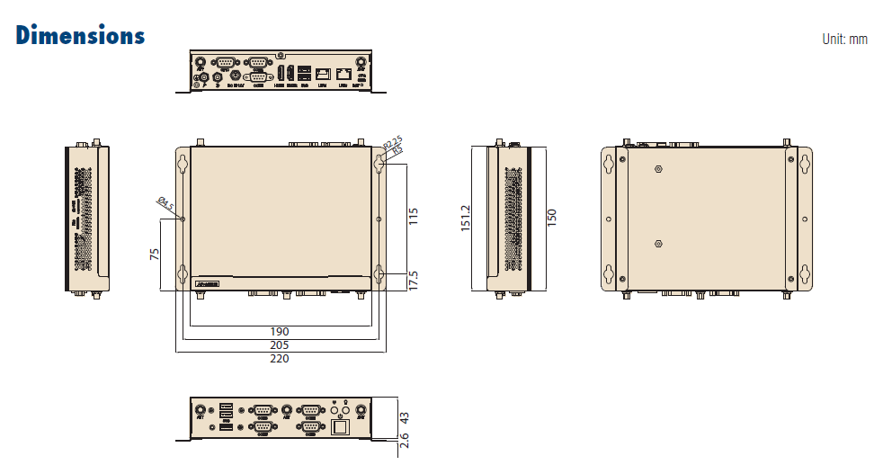

**机械尺寸  (**Mechanical Characteristics)
RTENOTITLE
RTENOTITLE
