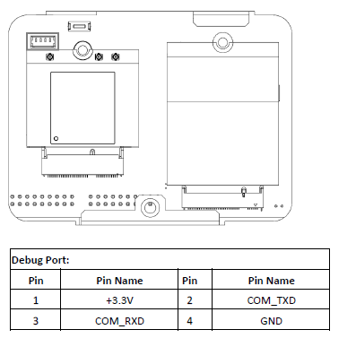

Debug Port
EPC-R7200 provides one Debug Port for development used. Debug cable P/N: 1700021565-01 4P-1.25 to D-SUB 9P (F) 60cm

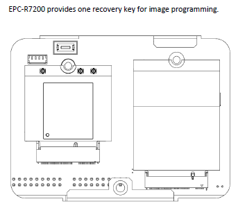

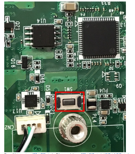

Recovery Key
圖片連結

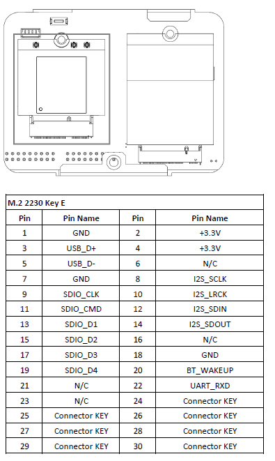

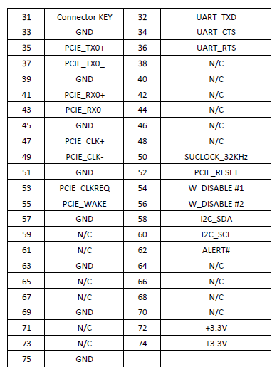

M.2 2230 Key E Slot
EPC-R7200 provides one M.2 2230 Key E Slot for WLAN card. P/N: EWM-W159M201E 802.11 ac/a/b/g/n + Bluetooth 5.0 M.2 2230 (A-E Key) Card
圖片連結

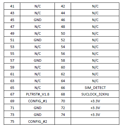

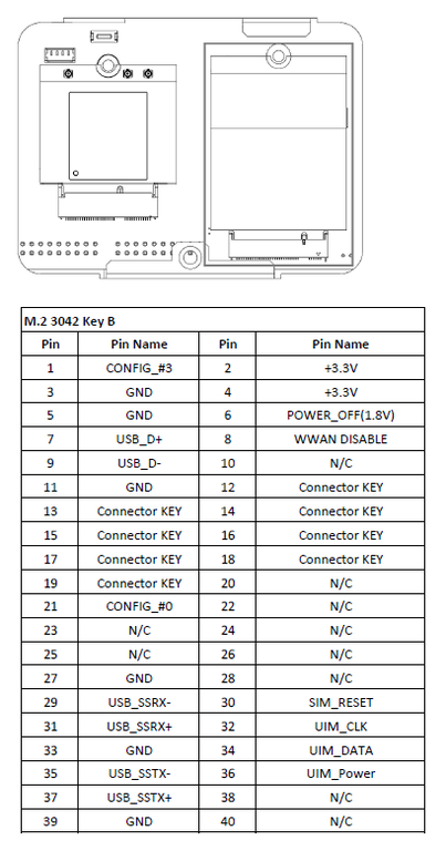

M.2 3042 Key B Slot
EPC-R7200 provides one M.2 3042 Key B Slot for WWAN card
圖片連結
圖片連結

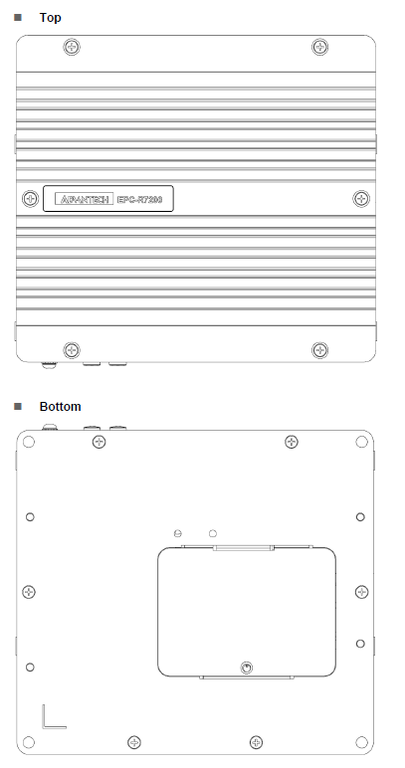

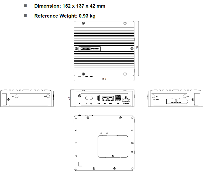

**机械尺寸  (**Mechanical Characteristics)
圖片連結

2.Enter to recovery mode by holding the recover button and plug power to boot. Release recover button around 3 seconds after plug in power.
圖片連結

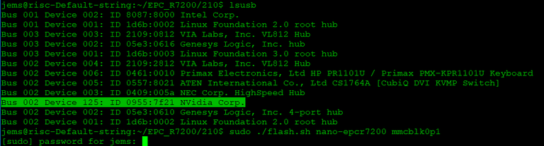

3.Connect Micro USB cable from EPC-R7200 Micro USB port to Linux host PC USB TypeA port. Check the device is in recovery mode by command “lsusb”. Will get NVidia Corp. with ID 0955:7f21
圖片連結

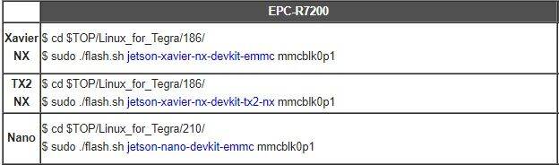

4.Execute command to flash imag:
  @risc-Default-string:~/EPC_R7200/210$ sudo ./flash.sh nano-epcr7200 mmcblk0p1
Image name: Please download the correct image version with the name below.
Where
"-v : Image version" 00001~99999
"-s : 186 - Jetson TX2 NX"
"  : 194 - Jetson Xavier NX"
"  : 210 - Jetson Nano"
Update the flash command for DIV0003:
圖片連結

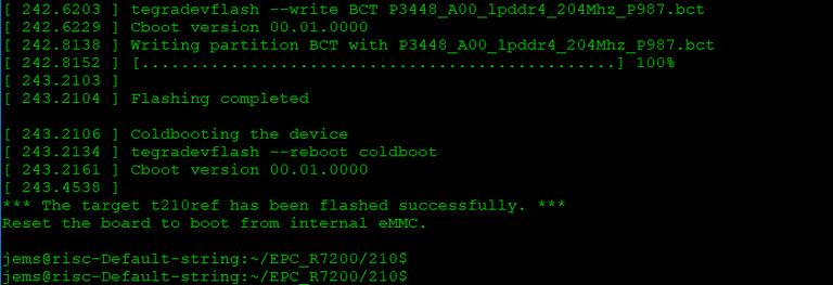

5.Wait around 10~15 minute to flash image to device:
圖片連結

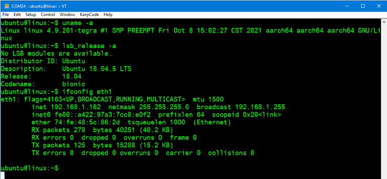

7.Check the eth1 can get the IP Addr:
圖片連結

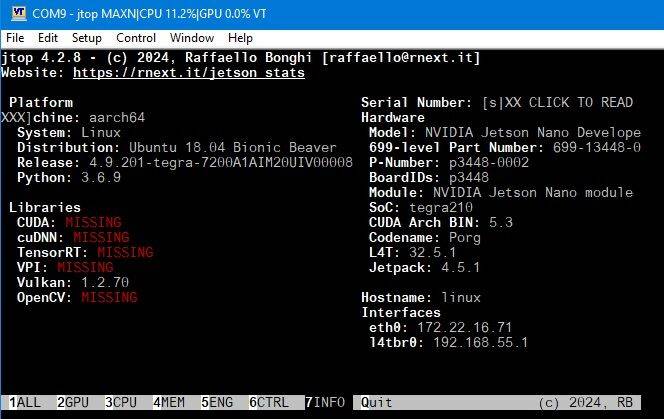

  • Install jtop
$ sudo apt update
$ sudo apt install python3-pip
$ sudo pip3 install -U jetson-stats
$ jtop

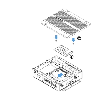

NVIDIA 模塊安裝(NVIDIA Jetson Module Installation)

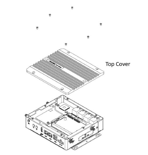

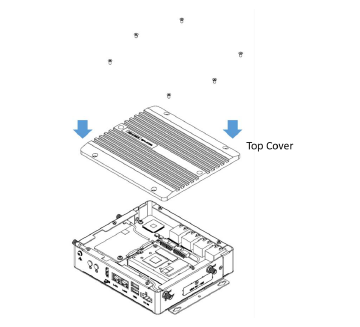

Step1: Remove 6 screws on Top Cover and then lift up Top Cover
圖片連結

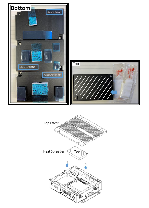

Step2: Choose the right heat spreader according the JestonTM module you used Smear grease on heat spreader (Top) Remove blue tapes from thermal pad (Bottom) Fix the heat spreader on Top Cover by two screws
圖片連結
Step3: Plug JestonTM module into Sockets of carrier board. Lock 2 screws to fix JestonTM module
圖片連結

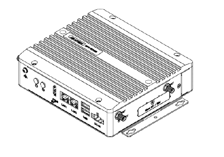

Step4: Put the Top Cover on and then lock 6 screws on top of it
圖片連結
