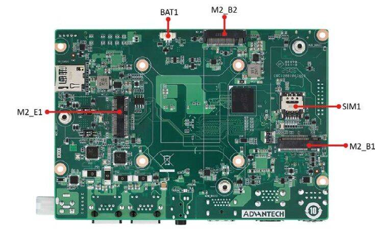

- 3x M.2 Expansions: M.2 E-Key 2230 for WiFi/BT, M.2 B-Key 3052 for 4G/LTE, M.2 B-Key 2280 for NVMe Storage

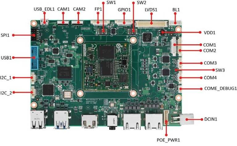

Layout
Switch / Jumper Settings
SW1
- SW1 ( 1-on ) : USB EDL Mode (Forced Recovery)
- SW1 ( 1-off ) : Normal Boot
- SW1 ( 2-on ) : AT Mode
- SW1 ( 2-off ) : ATX Mode
- SW1 ( 3-on ) : UFS
- SW1 ( 3-off ) : EMMC
- SW1 ( 4-on ) : LVDS (DVT Support)
- SW1 ( 4-off ) : eDP (DVT Support)

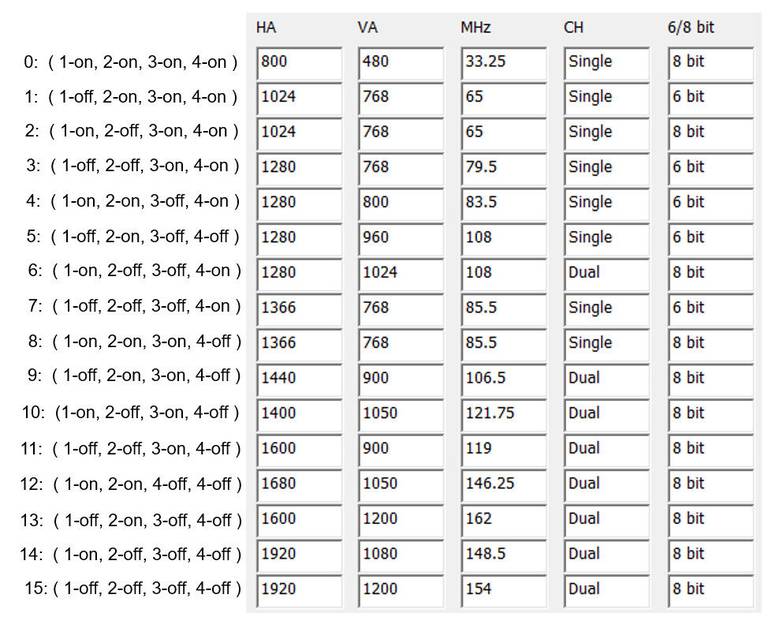

SW2
- LVDS Resolution setting
SW3
- SW3 ( 1-on ) : COM1 TERM RX Enable
- SW3 ( 1-off ) : COM1 TERM RX Disable
- SW3 ( 2-on ) : COM2 TERM RX Enable
- SW3 ( 2-off ) : COM2 TERM RX Disable
VDD1
- VDD1 ( Select 1,3 ): 3.3V
- VDD1 ( Select 3,5 ): 5V
- VDD1 ( Select 3,4 ): 12V

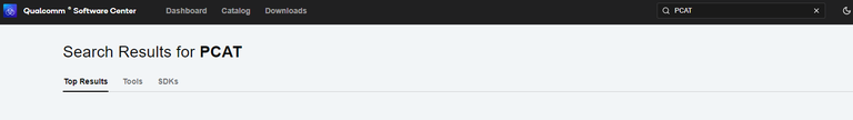

Download the Qualcomm Software Center
Open the Qualcomm Software Center

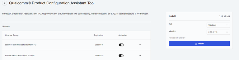

Search "PCAT" in the search bar
Click Qualcomm® Product Configuration Assistant Tool
Select Qualcomm® Product Configuration Assistant Tool version
- Version: 2.33.2.119
Install Qualcomm® Product Configuration Assistant Tool 2.33.2.119

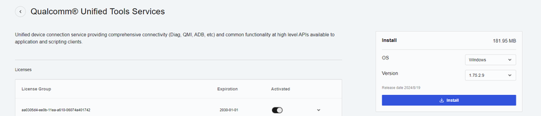

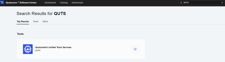

Search "QUTS" in the search bar
Click the Qualcomm® Unified Tools Services
Select Qualcomm® Unified Tools Services version
- Version : 1.75.2.9
Install Qualcomm® Unified Tools Services 1.75.2.9

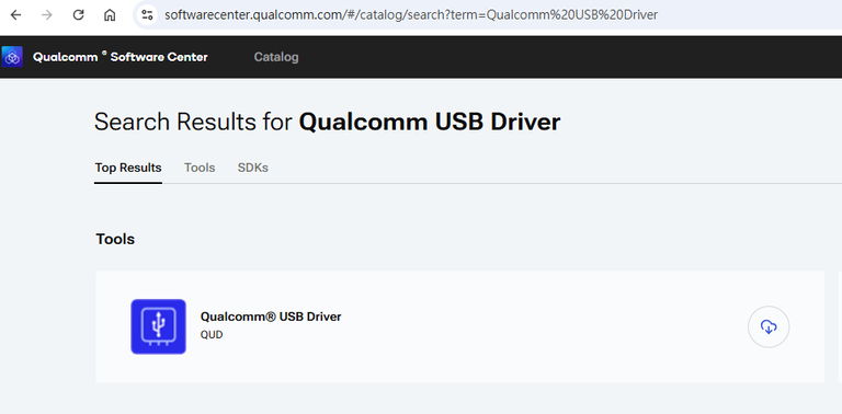

If your PC cannot identify the USB, please download the "Qualcomm USB Driver".
Search "Qualcomm USB Driver" in the search bar, then install the driver.

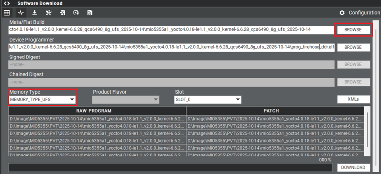

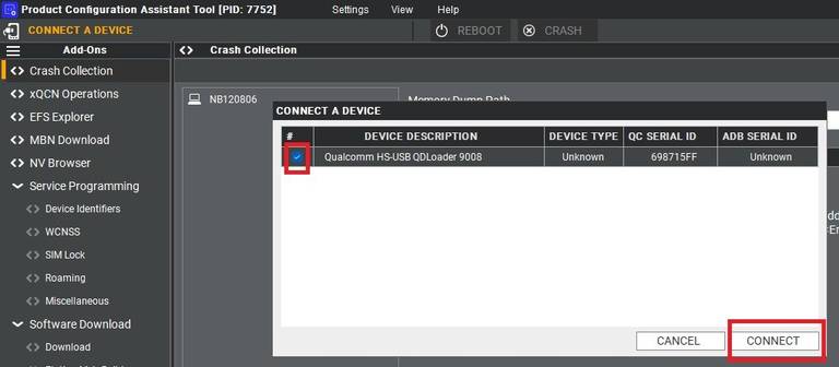

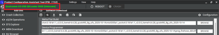

Open "PCATApp" Tool
Select "Qualcomm HS-USB QDLoader 9008" and click connect
When you connected successfully, it will show green words: Qualcomm HS-USB QDLoader 9008 (COM 11)

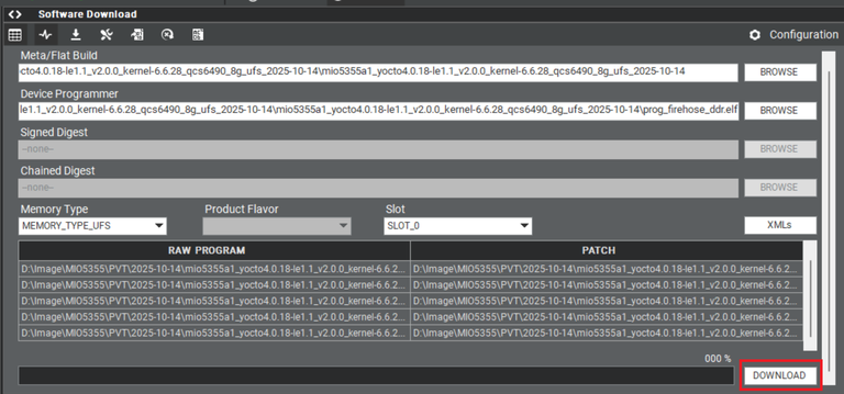

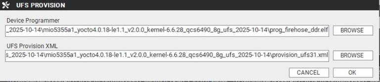

Select UFS Folder in PCAT Tool, the Tool will help load Files automatically and Select "MEMORY_TYPE_UFS"
Select provision button
Add the
prog_firehose_ddr.elfandprovision_ufs31.xmlin UFS folder.

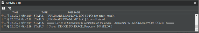

Then press "OK", it will start to do USF Provision.
When the Provision finished, you can see the result in message window.

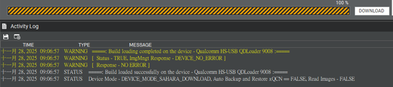

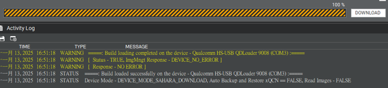

Click "Download"
UFS Download completed

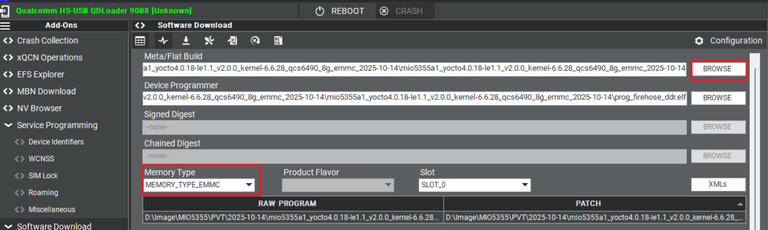

- Flash eMMC: the SW1 switch to 1-on, 3-off
Turn on the power
Make sure the device connection status.
If the device disconnects with PCAT Tool, please connect it again.

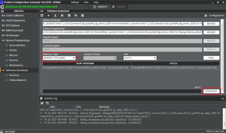

Select EMMC Folder in PCAT Tool, the Tool will help load Files automatically and Select "MEMORY_TYPE_EMMC"
Make sure the setting, then press "Download" button.
eMMC Download completed
