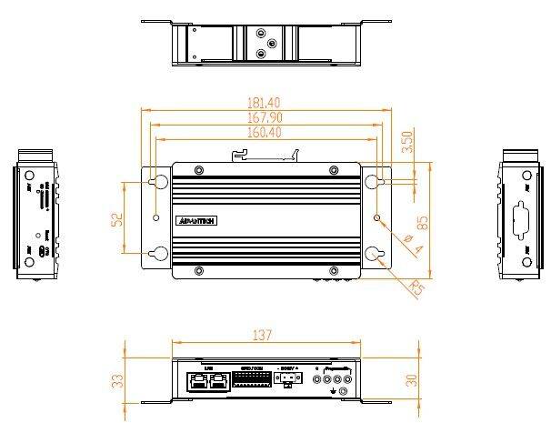

**机械尺寸  (**Mechanical Characteristics)​
EPC-R3220
RTENOTITLE

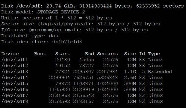

Step0: 檢查SD卡在Linux 環境的代號 (check SD card symbol in Linux system)
RTENOTITLE
RTENOTITLE

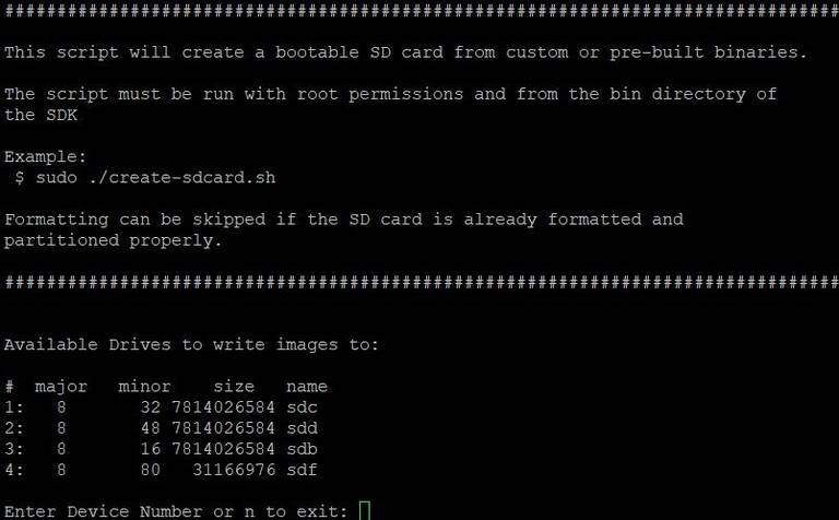

Step1: 創造一張可開機的SD 卡 (Create a bootable SD card)
 $ cd ti-sdk-XXX/bin
RTENOTITLE
$ sudo ./create-sdcard.sh

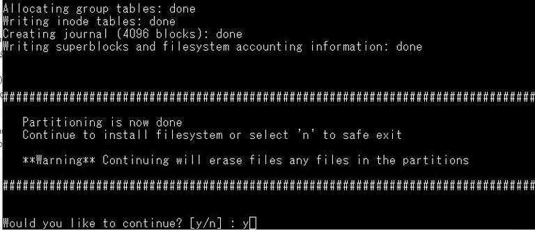

RTENOTITLE

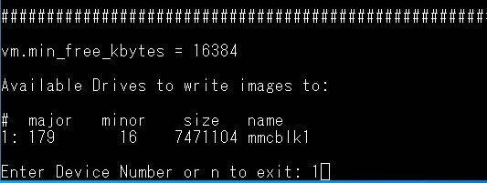

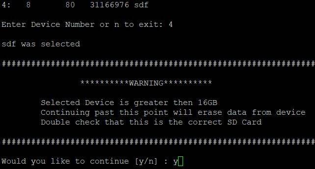

Select SD card:
RTENOTITLE

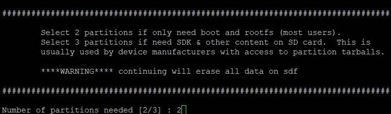

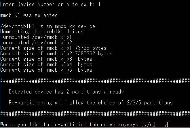

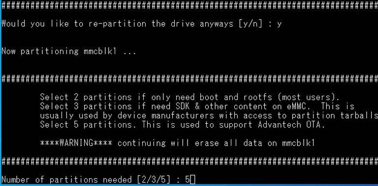

Select number of partitions:
RTENOTITLE
RTENOTITLE
RTENOTITLE

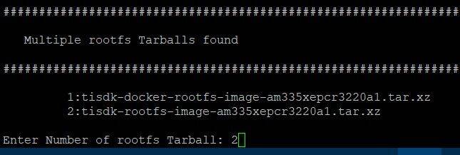

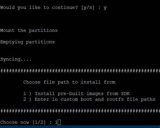

Select Pre-built System image:
RTENOTITLE

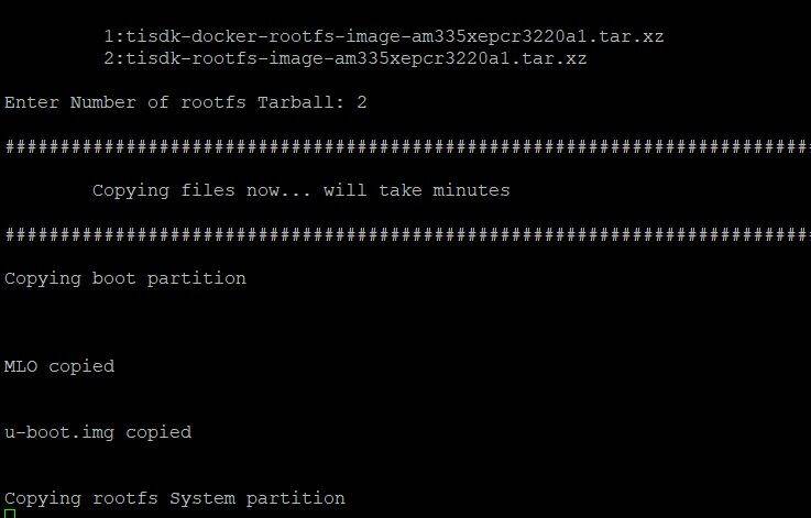

Select tisdk-rootfs-image-XXX.tar.xz(XXX represents machine name, e.g. am335xepcr3220a1):
RTENOTITLE
RTENOTITLE

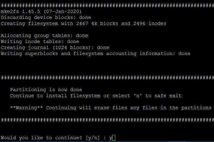

If you need to transfer whole system to on-board flash, please press y followed by Enter.
RTENOTITLE

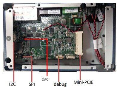

Step3: 確認開機選擇指撥開關(Check the SW1 switch)
            SPL開機模式(SPL boot mode: boot from SD/MMC, SPI...)
            1--off  2---off
            eMMC開機模式(eMMC(SPI) boot mode): The R3220 can only support SPI and SD boot in HW design. So it needs to flash the MLO file to the SPI flash, and it can boot the SPI first and then boot the u-boot from the eMMC
            1--on  2--off
            Note: After change switch setting. Unplug and plug AC power for the change to take effect.

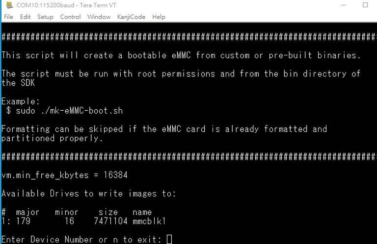

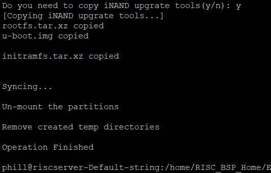

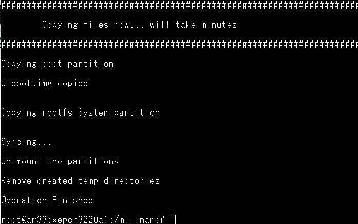

Step4: 利用mk-eMMC-boot.sh 安裝eMMC 鏡像(Flash image to eMMC Flash by mk-eMMC-boot.sh )
RTENOTITLE
RTENOTITLE
RTENOTITLE
RTENOTITLE
RTENOTITLE
RTENOTITLE
RTENOTITLE

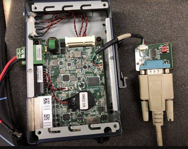

Debug port connection (串口連接)
RTENOTITLE

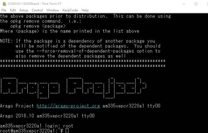

Log into Terminal  Tool (进入串口调试终端):
RTENOTITLE

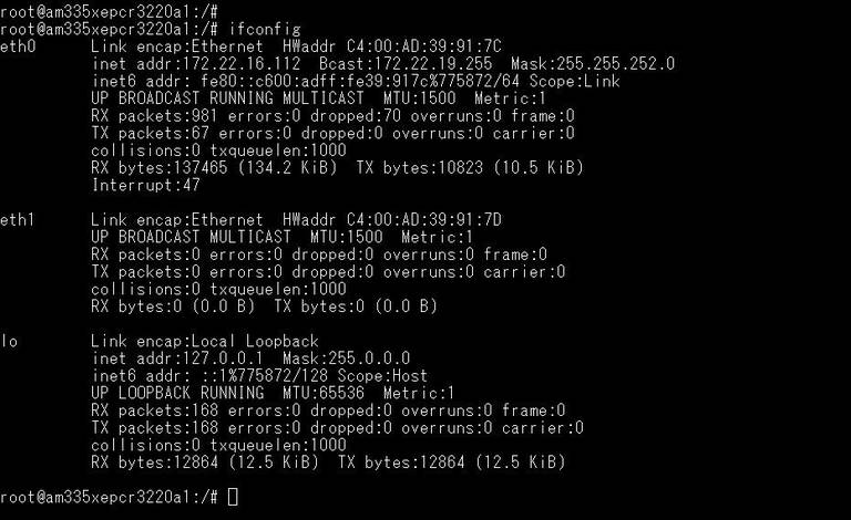

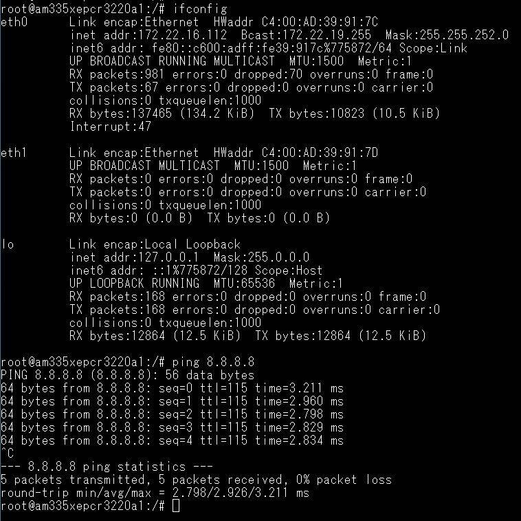

乙太網路使用方法(Ethernent Testing Method)​
Command : ifconfig
RTENOTITLE
Command: Ping - I eth1 8.8.8.8  or Ping - I eth0 8.8.8.8
RTENOTITLE

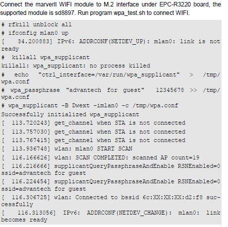

WiFi使用方法(WIFI Testing Method)​
M.2 Mrvl. WIFI/BT Test
EPC-R3220 supports MarverllSD8897 wifi/bt modules throught M.2.
RTENOTITLE

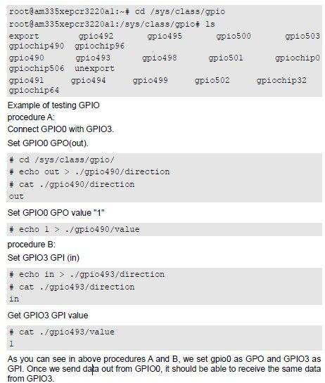

GPIO使用方法(GPIO Operating Method)​
RTENOTITLE
RTENOTITLE

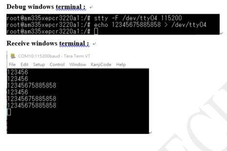

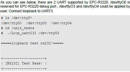

串口使用方法(Serial Port Operating Method)​
RS-232 Test
RTENOTITLE

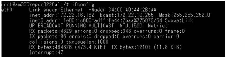

**查看主板IP位址 ( Chech IP Address ):**​
        Command : ifconfig
RTENOTITLE

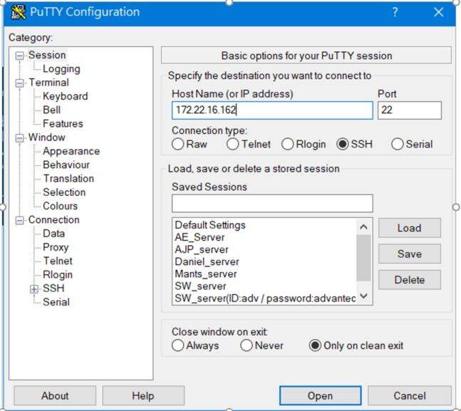

Windows下SSH访问及文件传输​
SSH Remote Log into Device
  • SSH远程登录,以putty选择putty.exe(或者使用Xshell、SecureCRT等类似软件)
  • 需要设置远程设备的IP、通讯端口(默认22)、通讯方式,登录后验证用户名密码
RTENOTITLE
RTENOTITLE
RTENOTITLE
Account is “root” , no password.
RTENOTITLE

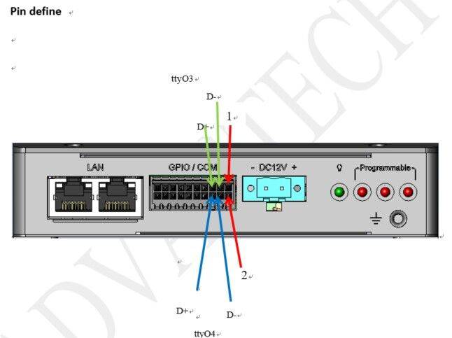

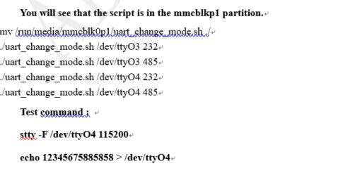

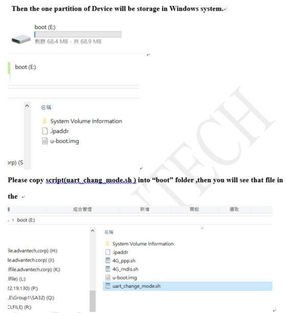

RS-485 測試方式 (RS-485 testing method)​
Test tool script :
Uart change mode
百度網盤(Baidu Disk): 链接:&nbsp https://pan.baidu.com/s/1HGJoW0jqp_GGK5VFvXAieg
提取码:luug
RTENOTITLE
RTENOTITLE
RTENOTITLE
RTENOTITLE
RTENOTITLE
