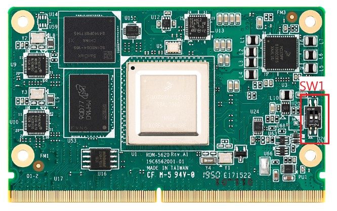

SW1:
  • 1-4: ON: Normal UART. OFF: Debug Console
  • 2-3: ON: AT Mode. OFF: ATX Mode

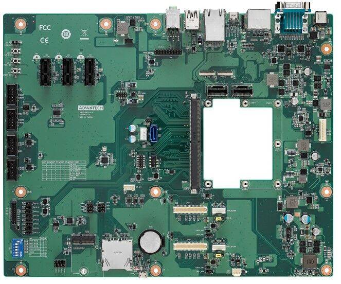

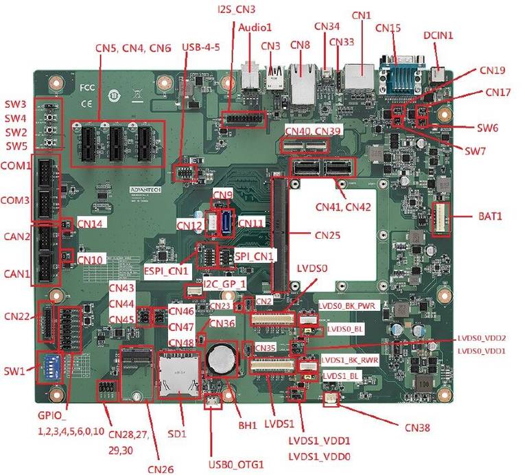

ROM-DB5901 接口布局圖 Board Dimension Layout​
DB-ROM-5901_5620_carrierboard
ROM-DB5901_IO
主板内置插针式引脚排序方式 (Pin Header defination)​
Internal I/O​
ROM-DB5901_IO2
PositionDescriptionConnector Type
BAT1PIN Header for BatteryWAFER 8P 2.54mm 180D(M) DIP
A2543WV2-8P
BH1RTC Battery HolderBATTERY HOLDER 24.923.48.9
CR2032 BH800.4GG
CAN1CANBus Port 1BOX HEADER 5x2P 2.54mm 180D(M)
DIP 23N6960-10S10
CAN2CANBus Port 2BOX HEADER 5x2P 2.54mm 180D(M)
DIP 23N6960-10S10

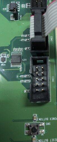

COM1COM Port 1BOX HEADER 5x2P 2.54mm 180D(M)
DIP 23N6960-10S10
COM3COM Port 3 (Debug Port)BOX HEADER 5x2P 2.54mm 180D(M)
DIP 23N6960-10S10
CN4PCIex1 Connector 1PCIEXPRESS 36P 180D(F) DIP
2EG01817-D2D-DF
CN5PCIex1 Connector 2PCIEXPRESS 36P 180D(F) DIP
2EG01817-D2D-DF
CN6PCIex1 Connector 3PCIEXPRESS 36P 180D(F) DIP
2EG01817-D2D-DF
CN11SATA ConnectorSerial ATA 7P 1.27mm 180D(M) DIP
WATM-07DBN4A3B8
CN12SATA Power ConnectorWAFER 4P 2.5mm 180D(M) DIP
24W1161-04S10-01T
CN22GPIOx8 setsPIN HEADER 10x2P 2.0mm 180D(M)
DIP 21N22050
CN25MXM 3.0 ConnectorMXM Conn. 314P 90D(F) SMD
AS0B821-S78B-7H
CN26M.2 Key E SlotsNGFF 75P 0.5mm 90D(F) H=4.2mm
SMD AS0BC21-S40BE
CN38FAN (Reserved)WTB Con. 3P 2.54mm 180D(M) DIP
A2543WV0-3P-6T-5e
CN39MIPI-CSI1 (FPC, 4-LaneFPC 39P, 0.6mm, H0.9mm
CN40MIPI-CSI0 (FPC, 2-Lane)FPC 39P, 0.6mm, H0.9mm
CN41MIPI-CSI0 (Mini-SAS, 2-Lane)Mini SAS 36P/0.8mm/(M)/LCP/VA/G15u/
S/BK/W
CN42MIPI-CSI1 (Mini-SAS, 4-Lane)Mini SAS 36P/0.8mm/(M)/LCP/VA/G15u/
S/BK/W
ESPI_CN1ESPIPIN HEADER 6x2P 2.0mm180D(M) SMD
21N22050-12M00B
I2C_GP_1I2C Pin HeaderWAFER BOX 4P 2.00mm 180D(M) DIP
721-81-04TW00
I2C_CN3Audio Codec BoardPIN HEADER 2x10P 2.54mm 180D(M)
DIP 21N22564
LVDS0LVDS0Wafer 2x20P/1.25mm/(M)/NY9T/VA/GFL/
S/WH/W
LVDS_BK_PWRLVDS0 Back LightWAFER BOX 5P 2.0mm 180D(M) DIP
A2001WV2-5P
LVDS1LVDS1Wafer 2x20P/1.25mm/(M)/NY9T/VA/GFL/
S/WH/W
LVDS1_BK_PWRLVDS1 Back LightWAFER BOX 5P 2.0mm 180D(M) DIP
A2001WV2-5P
SD1SD Card SlotSD CARD 9P 90D(F) SMD WK2192CS3D-
7H
SPI_CN1SPI Pin HeaderPIN HEADER 4x2P 2.54mm 180D(M)
SMD 21N22564
SW2Reset ButtonTACT SW STS-091 SMD 4P H=3.8mm
SW4SLP ButtonTACT SW STS-091 SMD 4P H=3.8mm
SW5Power ButtonTACT SW STS-091 SMD 4P H=3.8mm
USB0_OTG1USB OTGMicro USB 5P/0.65mm/(F)/NY9T/GFL/
RA/S/BK/B
USB-4-5USB Port 4, Port 5PIN HEADER 2x5P 2.0mm 180D(M)
SMD 21N22050

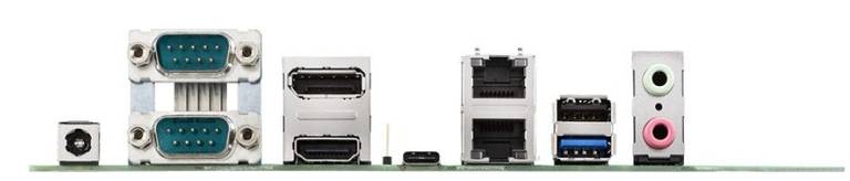

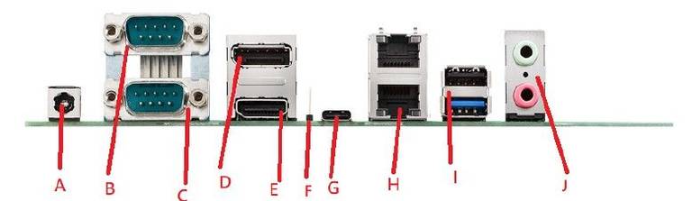

Rear I/O​
ROM-DB5901_RearIO
PositionDescriptionName
DCINDC JackA
CN15AUART Port 0(COM0)B
CN15BUART Port 2(COM2)C
CN1ADP PortD
CN1BHDMI PortE
CN33Type C Controller Programming Header (Reserved Only)F
CN34USB Type CG
CN8GbE Ethernet Connector PortH
CN3USB Port 1/ 2I
Audio1MIC Input/ Audio OutputJ

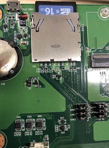

Step 2: 將可開機的 SD 卡插入底板 SD 卡卡槽 (Plug the SD card into Carrier board's SD card slot)
CarrierboardSDsolt

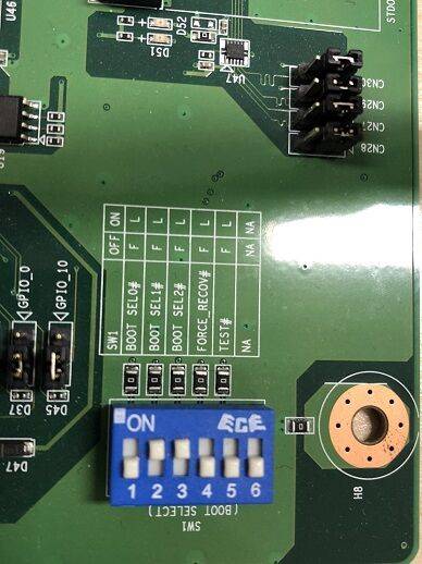

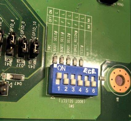

Step 3: 確認開機選擇指撥開關 SD 卡開機模式:
SDBootupSwitch

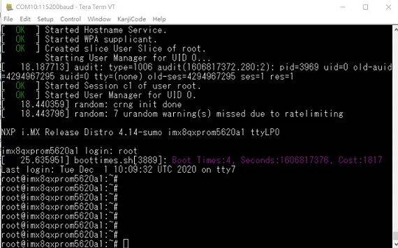

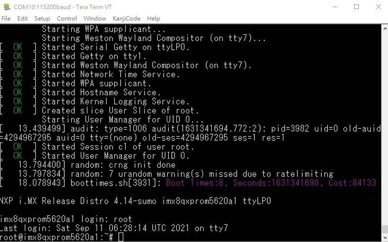

Step 4: 打開電源 和 終端機 (Turn on the Power & Terminal)
ROM-5620BootupMessage

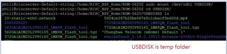

  1. 掛載 U 盤在 Ubuntu 系統中
Mount_usb_tempfolder

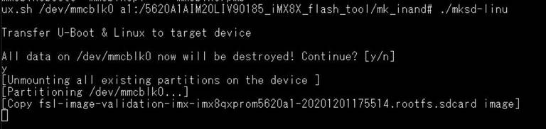

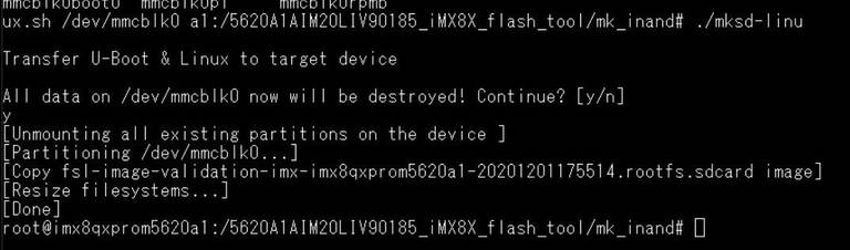

**Step 8 **使用腳本燒錄image 到 eMMC
command: ./mksd-linux.sh /dev/mmcblk0
RTENOTITLE
**Step 9 **. 燒錄完畢後,移除SD Card ,
請重新開機 ,Switch 1 請調整成 1 on , 其他 off 由 eMMC 開機
RTENOTITLE

UART 1: Change SW7 jumper to switch modes. (1ON 2OFF: RS-232)​
UART 1: Change CN27~CN30 jumper to (1-2 short)​
# stty -F /dev/ttyLP1 -echo -onlcr 115200
# cat /dev/ttyLP1 &
# echo test > /dev/ttyLP1

>> 1200000
查看内存容量(Check Memory Capacity)​
root@imx8qxprom5620a1:/# busybox free -m
total used free shared buffers cached Mem: 1794920 516080 1278840 17252 9852 80292 -/+ buffers/cache: 425936 1368984 Swap: 0 0 0
查看存储容量(Check Storage Capacity)​
root@imx8qxprom5620a1:/# busybox df -h
Filesystem Size Used Available Use% Mounted on /dev/root 13.4G 1.7G 11.1G 13% / devtmpfs 395.8M 4.0K 395.8M 0% /dev tmpfs 876.4M 0 876.4M 0% /dev/shm tmpfs 876.4M 16.5M 859.9M 2% /run tmpfs 876.4M 0 876.4M 0% /sys/fs/cgroup tmpfs 876.4M 4.0K 876.4M 0% /tmp tmpfs 876.4M 280.0K 876.2M 0% /var/volatile /dev/mmcblk0p2 13.6G 1.7G 11.3G 13% /run/media/mmcblk0p2 /dev/mmcblk0p1 63.9M 23.4M 40.5M 37% /run/media/mmcblk0p1 /dev/mmcblk1p1 63.9M 23.4M 40.5M 37% /run/media/mmcblk1p1 tmpfs 175.3M 88.0K 175.2M 0% /run/user/0
網路Ping測試(Ping Network Testing)​
ping 8.8.8.8
PING 8.8.8.8 (8.8.8.8) 56(84) bytes of data.
64 bytes from 8.8.8.8: icmp_seq=1 ttl=54 time=2.10 ms 64 bytes from 8.8.8.8: icmp_seq=2 ttl=54 time=2.10 ms
設置RTC (RTC Setting)​
root@imx8qxprom5620a1:/# systemctl stop ntpdate.service
root@imx8qxprom5620a1:/# date 090816072021 && hwclock -w && date
Wed Sep 8 16:07:00 UTC 2021 Wed Sep 8 16:07:00 UTC 2021
Wed Sep 8 16:07:06 UTC 2021
root@imx8qxprom5620a1:/#'''
