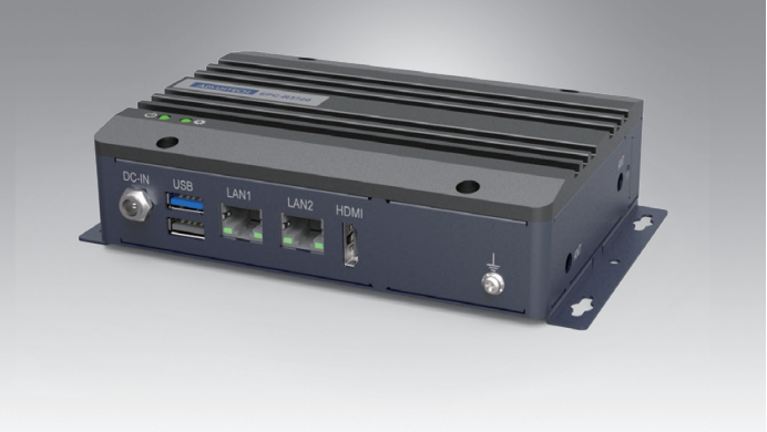

EPC-R3710_Debian_User_Guide
產品介紹(Product introduction )
產品特性(Product Features)
  • Rockchip Arm® Cortex®-A72 RK3399 up to 1.8 GHz
  • Onboard LPDDR4 2GB
  • HDMI 1920x1080 at 60Hz, 1 Dual Channel 24 bit LVDS
  • 1 2-wire RS-232, 1 USB3.0, 1 USB2.0, 1 Micro SD, 1 Mic. in / Line out
  • 1 mini-PCIe for 3G/4G
  • UIO expansion 3 USB2.0, 8 GPIO, 2 RS232 2/2-wires UART, 1 I2C
  • Supports Debian9/10 and Android7.1/10.0
  • Support I/O Expansions by UIO40-Express I/O boards, please refer to page #3 for more information
產品官網連結(Product Features)
EPC-R3710

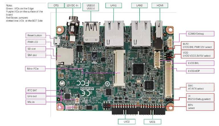

硬件接口說明(Hardware interface introduction)
接口布局和尺寸(Layout and Sizes)
RTENOTITLE
接口布局圖 Board Dimension Layout
RTENOTITLE
RTENOTITLE
RTENOTITLE
Connector List
RTENOTITLE
BATRTC Battery Connector
HDMIHDMI1 CONN
BLP2LVDS BKL PWR 12V select
LVDS/eDP LVDS BKLLVDS DATA/PWRCONN
LAN1LAN
LAN2LAN
MINIPCIEMINI PCIE 52P
SIMNano SIM Card
AUDIOAudio PIN Header
USB1USB CONN
COM2/DebugCOM2
SDSD Slot
OTGUSB
BTNMASKROM mode pin header
RSTReset Button
DCIN112V DC Jack
LEDLED
CN11UIO1
CN12UIO2
