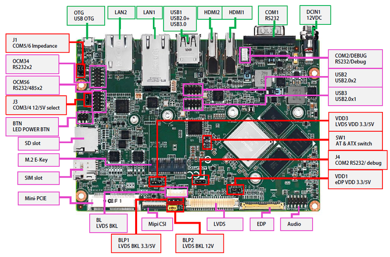

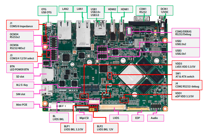

Connector List​
AUDIOAudio pin header
EDPEDP CONN
LVDSLVDS CONN
BLLVDS BKL CONN
CSICSI CONN
MINIPCIEMINI PCIe 52P
SIMNano SIM card
M2M.2 CONN
SDSD slot
BTNPower button and LED
DCIN112V DC jack
COM1COM1
COM2/DebugCOM2
HDMI1HDMI1 CONN
HDMI2HDMI2 CONN
USB1USB Type A (USB 3.0 and 2.0)
USB2USB pin header
USB3USB pin header
LAN1LAN1
LAN2LAN2
BATRTC CONN
COM56COM5 and COM6 with RS-232 or RS-485
COM34COM3 and COM4 with RS-232
OTGUSB
RSTReset button

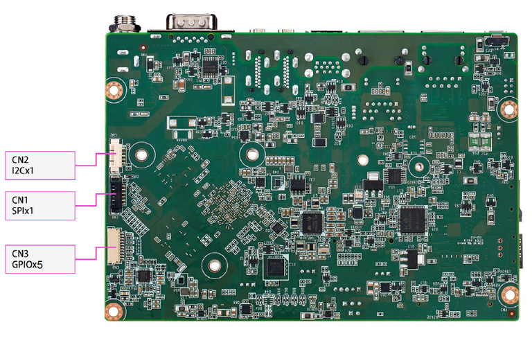

CN3GPIO CONN
CN1SPI
CN2I2C
接口引脚定義 (Pin definitions)​

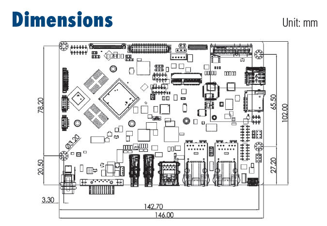

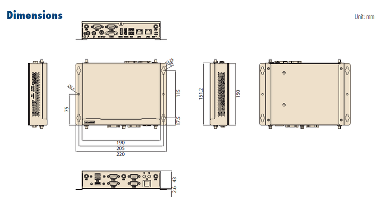

**机械尺寸  (**Mechanical Characteristics)​
RTENOTITLE
RTENOTITLE
