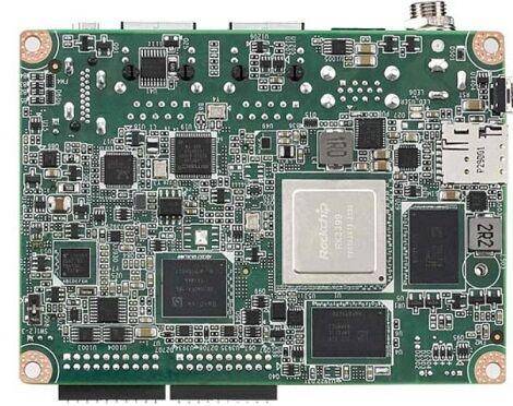

RSB-3710

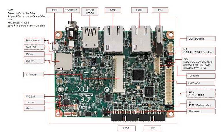

硬件接口說明(Hardware interface introduction)
接口布局和尺寸(Layout and Sizes)
接口布局圖 Board Dimension Layout
RTENOTITLE
RTENOTITLE
RTENOTITLE
Connector List
RTENOTITLE

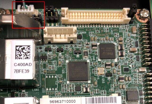

BATRTC Battery Connector
HDMIHDMI1 CONN
BLLVDS BKL CONN
LVDSLVDS CONN
LAN1LAN
LAN2LAN
MINIPCIEMINI PCIE 52P
SIMNano SIM Card
AUDIOAudio PIN Header
USB1USB CONN
COM2/DebugCOM2
SDSD Slot
OTGUSB
BTNPower BTN pin header
RSTReset Button
DCIN112V DC Jack
LEDLED
CN11UIO1
CN12UIO2

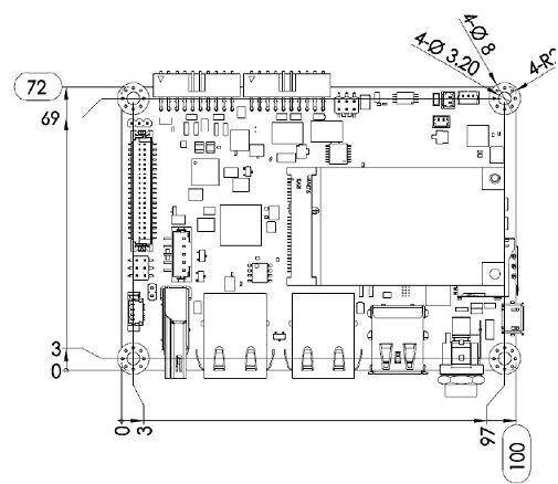

**机械尺寸  (**Mechanical Characteristics)
RTENOTITLE

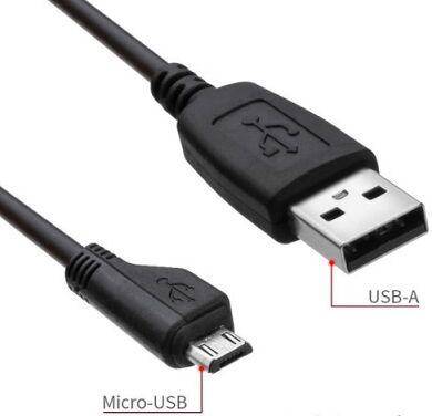

1. Prepare a mirco USB Cable and Debug Cable
mirco USB
RTENOTITLE
Debug Cable
RTENOTITLE

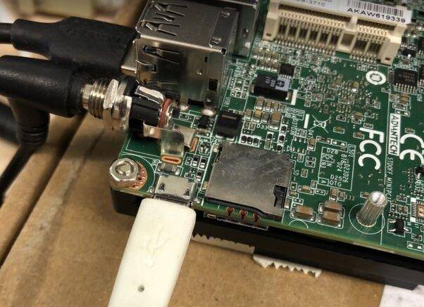

  1. Plug the OTG Cable into RSB-3720
RTENOTITLE

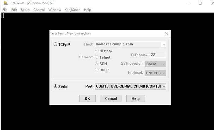

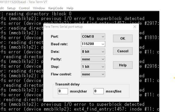

2. 設定終端機(Set Debug Terminal)
Debug 串口調試 (Debug port Setting)
 Tera Term setting
   Baud Rate:115200
Data :8
Parity :none
Stop :1
Flow Control:none
Tera Term Tool
RTENOTITLE
RTENOTITLE
Note:
Check the Sriel port in Device Manager :
if you can not identify the Serial device , please check your serial driver.

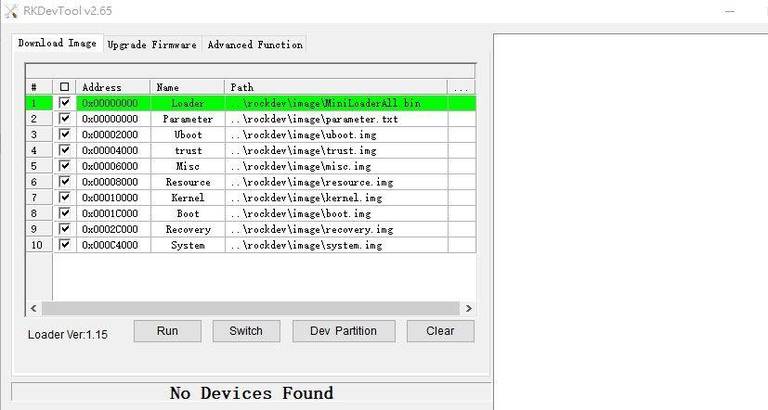

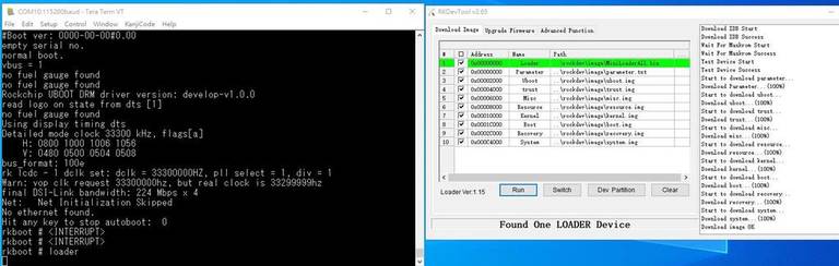

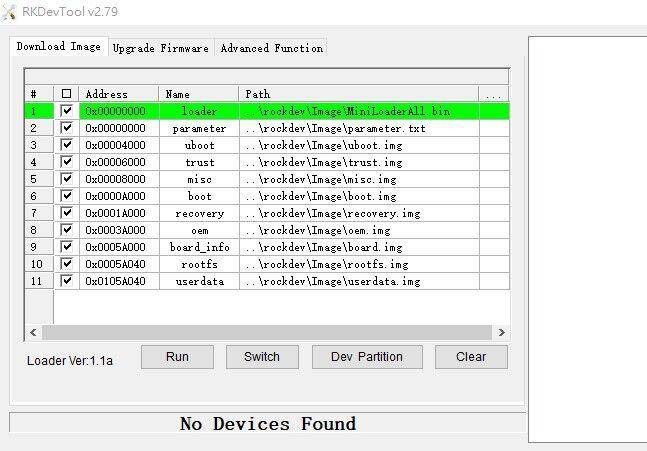

3.Open the flash tool
RTENOTITLE
  1. Turn on the power

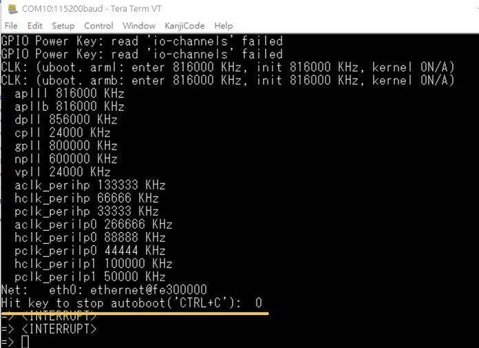

  2. When you see the debug message in Terminal , then press "Ctrl+C" , then log into Uboot stage
RTENOTITLE

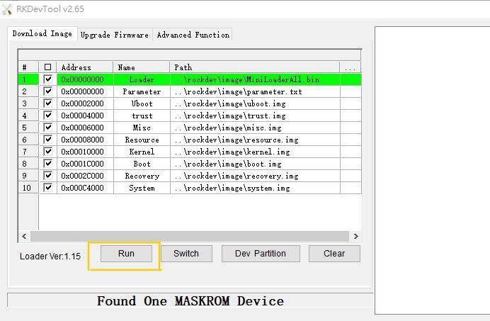

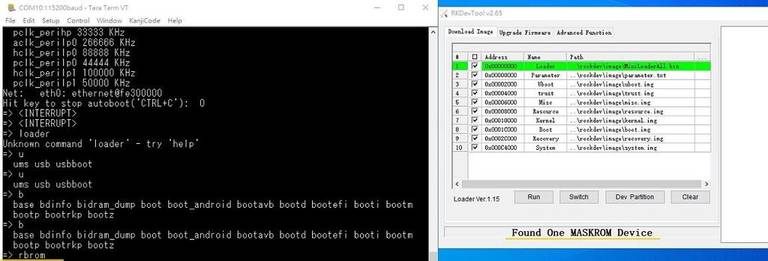

  1. In Uboot , please type  "loader"  , then the device will transfer to "Flash mode" , Android tool also will show  "Found One MASKROM Device "
RTENOTITLE

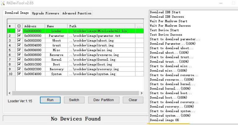

  1. In RKDevTool pressed  "Run"  , and it will flash image into eMMC.
RTENOTITLE
  1. The flash process  was finishded
RTENOTITLE

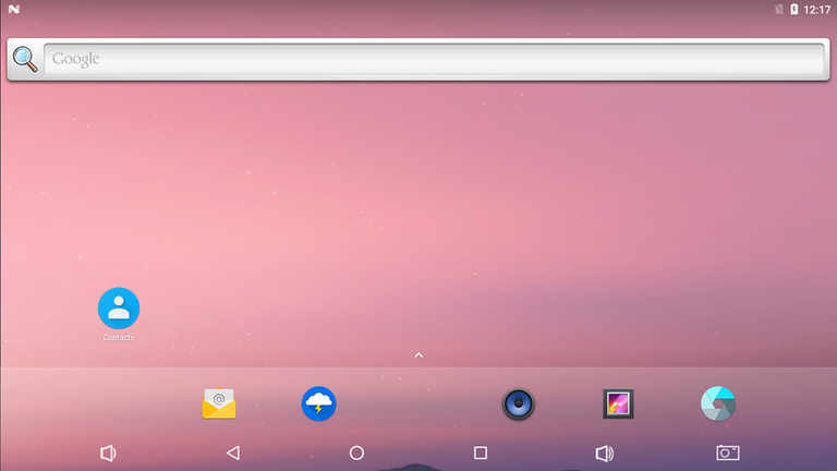

  1. Reboot the device , and connect with HDMI , it will show the Android Desktop.

  1. plugmirco USB cable into the  RSB-3710 OTG port.
RTENOTITLE

  2. Press "Ctrl + C", log into u-boot

  1. In Uboot , please type "rbrom " , the device will transfer to**"Flash mode"** , Android tool also will show "Found One MASKROM Device "
RTENOTITLE

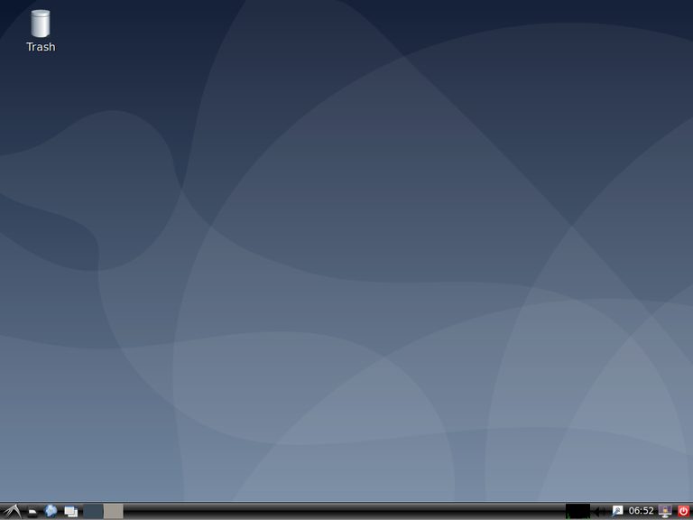

  1. Reboot the device , and connect with HDMI , it will show the Debian Desktop.
RTENOTITLE

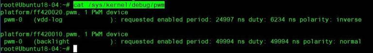

Check PWM duty sysle in Linux:
~# cat /sys/kernel/debug/pwm
RTENOTITLE

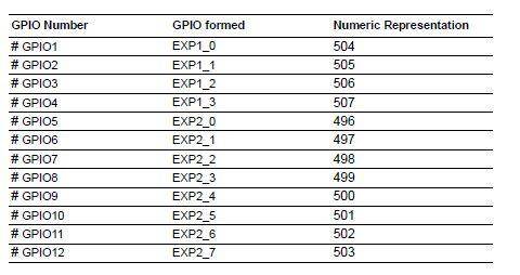

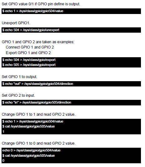

GPIO使用方法(GPIO Operating Method)
RTENOTITLE
RTENOTITLE
RTENOTITLE

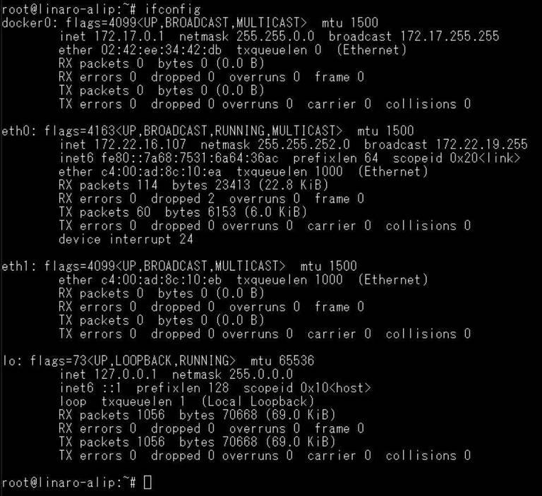

遠程訪問及文件傳輸(Remote Access and File Transimmion)
**查看主板IP位址 ( Chech IP Address ):**​
        Command : ifconfig
RTENOTITLE

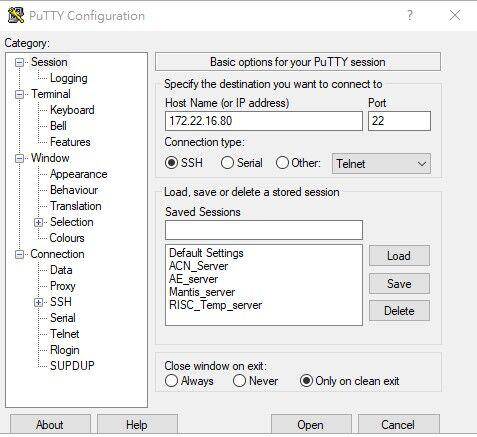

Windows下SSH访问及文件传输

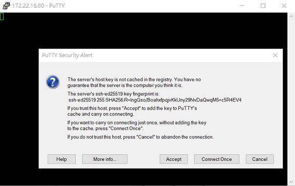

SSH Remote Log into Device
  • SSH远程登录,以putty选择putty.exe(或者使用Xshell、SecureCRT等类似软件)
  • 需要设置远程设备的IP、通讯端口(默认22)、通讯方式,登录后验证用户名密码
RTENOTITLE
RTENOTITLE
RTENOTITLE
