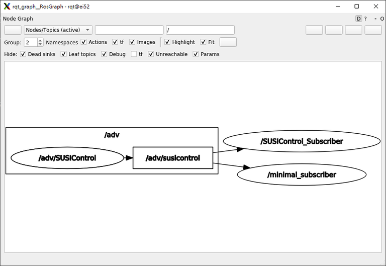

rqt_graph
Introduction
rqt_graph provides a GUI plugin for visualizing the ROS computation graph.
Run rqt graph
$ ros2 run rqt_graph rqt_graph

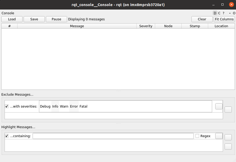

rqt_console
Introduction
rqt_console is a viewer in the rqt package that displays messages being published to rosout. It collects messages over time, and lets you view them in more detail, as well as allowing you to filter messages by various means.
Run rqt console
$ ros2 run rqt_console rqt_console

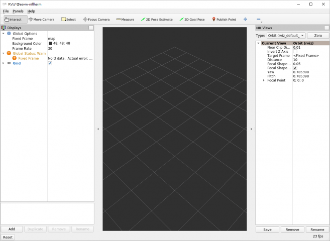

RViz
Introduction
RViz is a 3D visualization tool for ROS.
How To Startup
$ ros2 run rviz2 rviz2

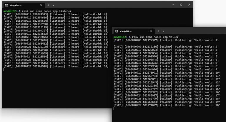

c++ sample
Run example for subscribe, you can open a terminal to executing command:
$ ros2 run demo_nodes_cpp listener
Open a new terminal to executing command to publish:
$ ros2 run demo_nodes_cpp talker
