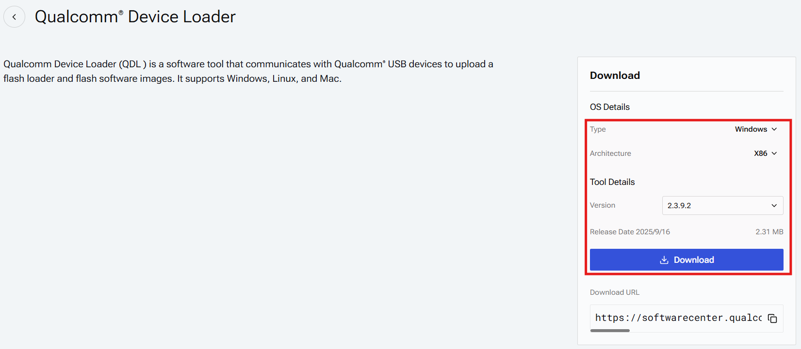

  1. Download Qualcomm Device Loader from below link https://softwarecenter.qualcomm.com/catalog/item/Qualcomm_Device_Loader
  2. According your host mach to select OS type and which version you want qdl_downalod_page.png

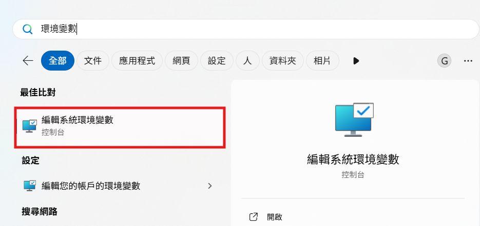

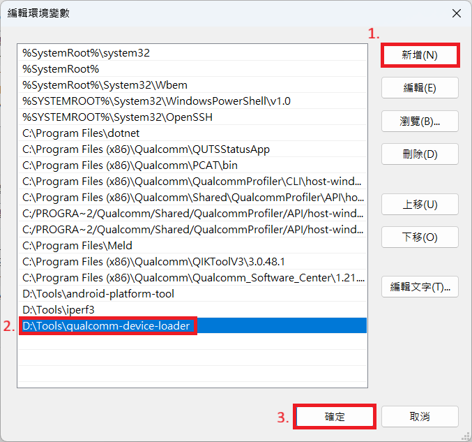

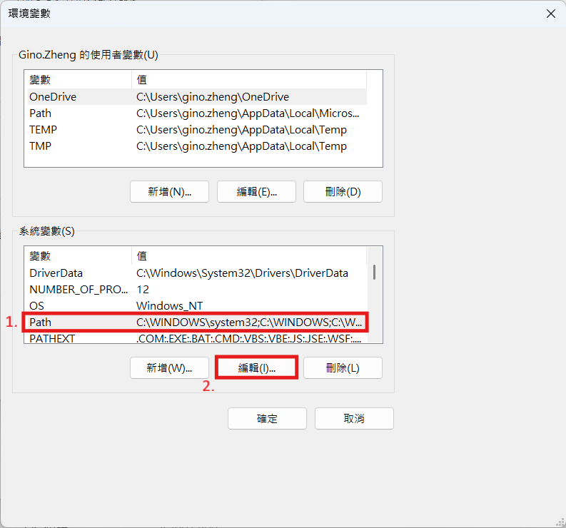

  4. Serach Edit the system environment variables (環境變數) to open Advanced system settings Also you can open Settings app → System → About → Advanced system settings → Advanced qdl_open_system_environment.png

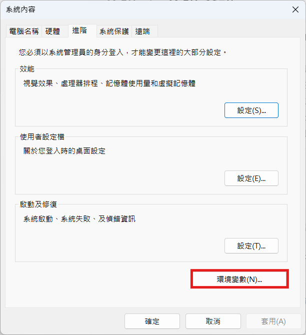

  7. Select New (新增) and type the Qualcomm Device Loader path then select OK (確定) qdl_add_environment_path.png

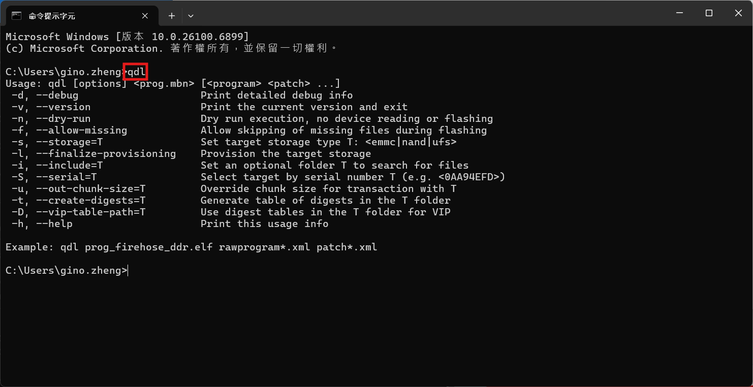

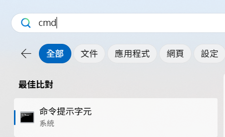

  8. Search cmd to open Windows Terminal

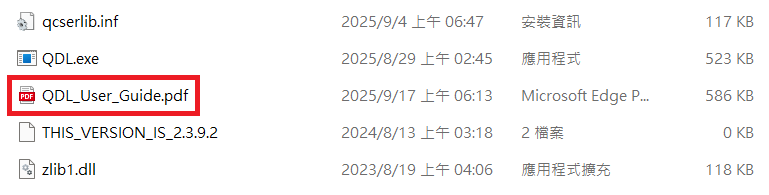

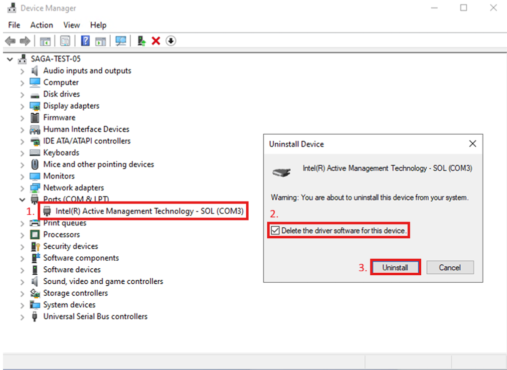

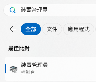

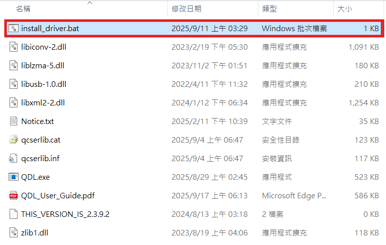

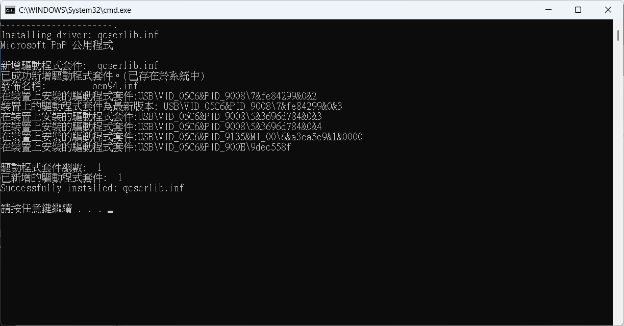

  4. Open install_driver.bat in QDL path to install winUSB driver qdl_install_usb_driver_bat.png

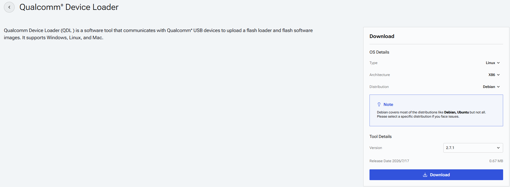

  3. Download Qualcomm Device Loader from below link https://softwarecenter.qualcomm.com/catalog/item/Qualcomm_Device_Loader
  4. According your host mach to select OS type and which version you want qdl_linux_download_page.png

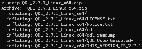

  5. Unzip download file in any pah
    unzip QDL_2.7.1_Linux_x64.zip

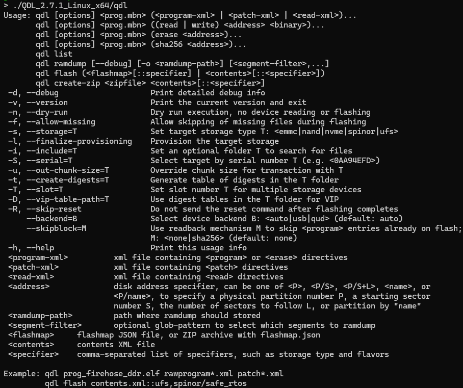

    You can see the QDL_User_Guide.pdf for more details

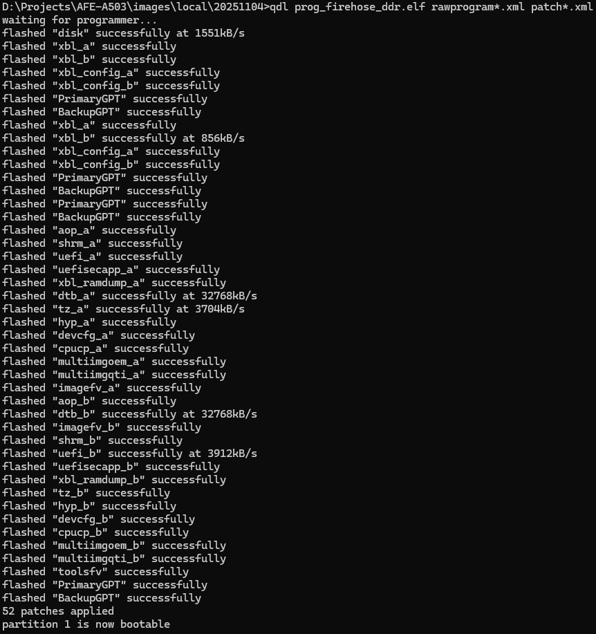

cd <workspace>/images/<machine>/qcom-ubuntu-image
Choosing the platform to flashing image.
QCS6490​
QCS6490 Platform Flashing Guide
Flash provision (Once only)
  1. Erase UFS
qdl prog_firehose_ddr.elf provision_ufs31.xml
Flash root filesystem
qdl prog_firehose_ddr.elf rawprogram*.xml patch*.xml

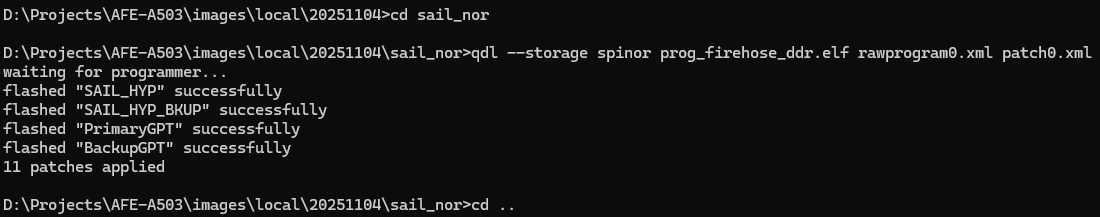

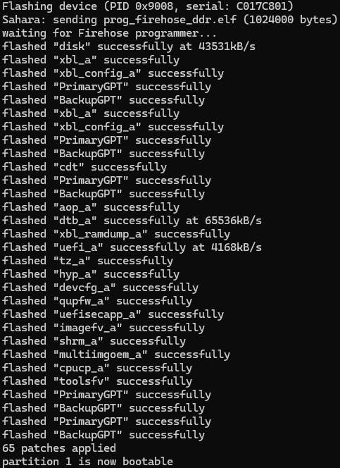

Flash Safety Island
  1. Enter sail_nor folder
cd sail_nor
  1. Flash sail_nor
qdl --storage spinor prog_firehose_ddr.elf rawprogram0.xml patch0.xml
  1. Back to the root path
cd ..
