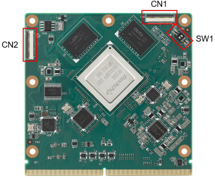

ROM-6881 Switch Settings
- [SW1](./ROM-6881_Others_User_Guide_wiki_data/ROM-6881_SW1 "ROM-6881 SW1".md)(AT & ATX Mode Switch)
SOM-DB2510 Switch Settings
- [SW4](./ROM-6881_Others_User_Guide_wiki_data/SW4 "SW4".md) (Boot Select/Force Recovery/Test Switches)
- [LID1](./ROM-6881_Others_User_Guide_wiki_data/LID1 "LID1".md) (LID Button Enable/Disable Switches)
- [SW5](./ROM-6881_Others_User_Guide_wiki_data/SW5 "SW5".md) (LAN CONN LED Pull High Switches)
- [SW1](./ROM-6881_Others_User_Guide_wiki_data/COM0_Settings "COM0 Settings".md)(COM0 Settings)
- [SW2](./ROM-6881_Others_User_Guide_wiki_data/SW2 "SW2".md)(COM2 Settings)
- [SW3](./ROM-6881_Others_User_Guide_wiki_data/I2S_Clock_Settings "I2S Clock Settings".md)(I2S Clock Settings)
- [M2E_DISABLE_N1](./ROM-6881_Others_User_Guide_wiki_data/M2E_DISABLE_N1 "M2E DISABLE N1".md)(M.2 Wireless Disable Switch)

ROM-6881 Pin Connector
- [CN1 MIPI-CSI2 Connector](./ROM-6881_Others_User_Guide_wiki_data/ROM-6881_CN1_MIPI-CSI2_Connector "ROM-6881 CN1 MIPI-CSI2 Connector".md)
- [CN2 MIPI-CSI3 Connector](./ROM-6881_Others_User_Guide_wiki_data/ROM-6881_CN2_MIPI-CSI3_Connector "ROM-6881 CN2 MIPI-CSI3 Connector".md)

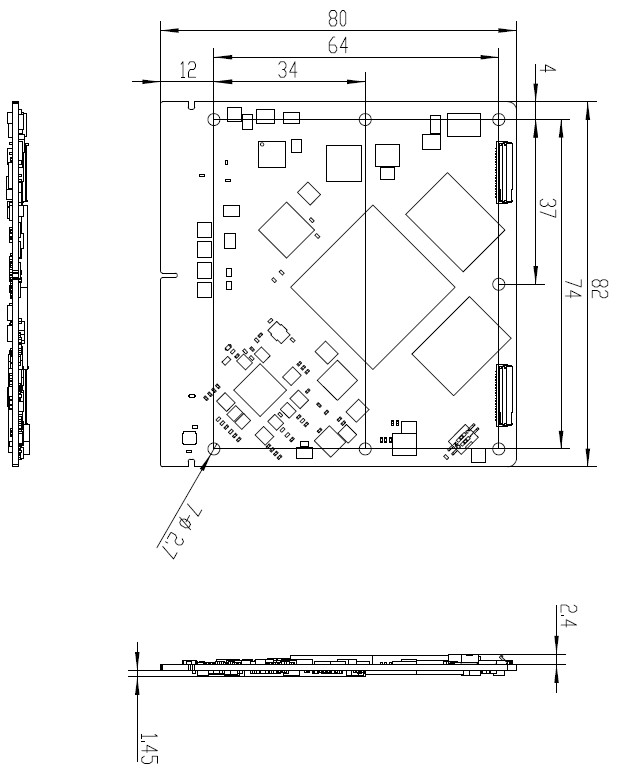

ROM-6881 機械尺寸(Mechanical Characteristics)
- Dimension: SMARC form factor size: (D x W) 82 x 80 mm / 3.22 x 3.15 inch
- Height on Top: 2.4 mm
- Height on Bottom: 1.45 mm
**SOM-DB2510_A1 机械尺寸 (**Mechanical Characteristics)
For more details regarding our 2D/3D models, please visit the Advantech COM support service website at: <http://com.advantech.com.
Board Mechanical Diagram -Front
Board Mechanical Diagram -Side1
Board Mechanical Diagram -Side2

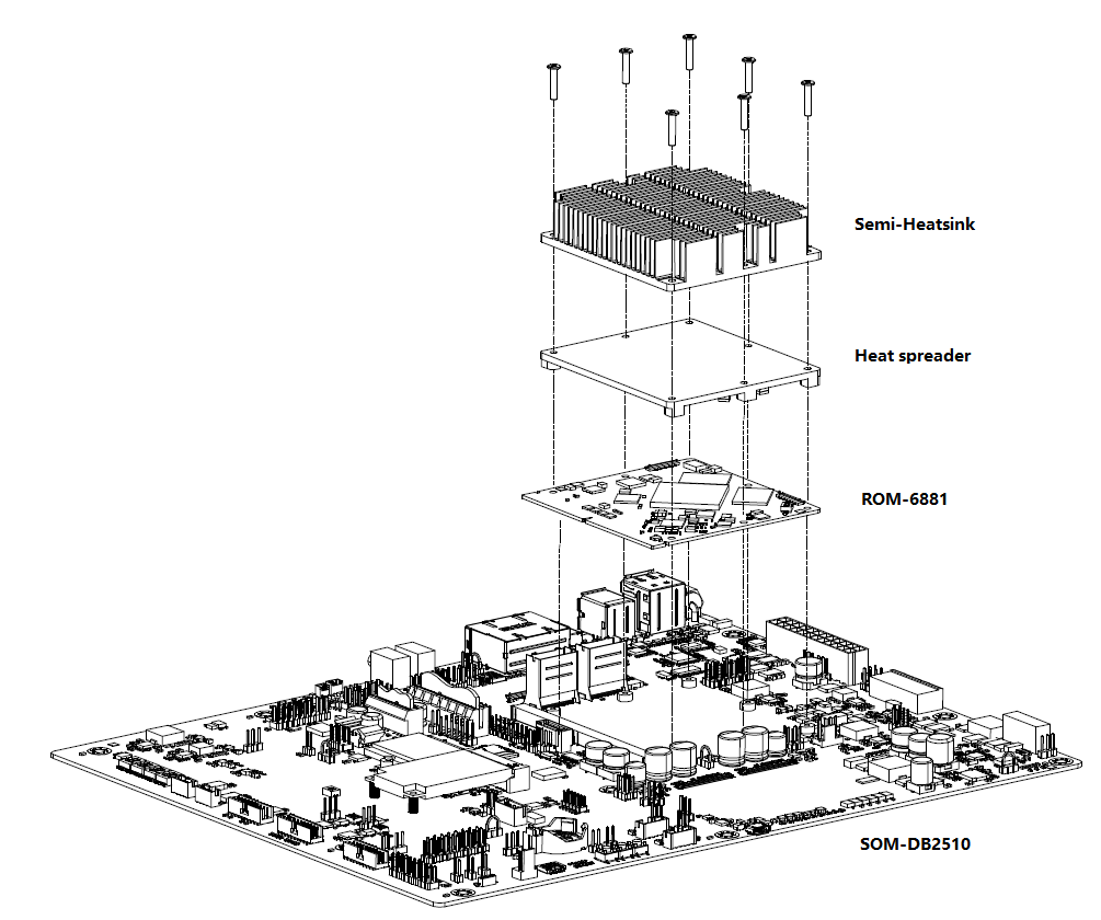

Assemblly Diagram
These figures demonstrate the order of assembly needed when attaching the thermal module and COM module to the carrier board.
