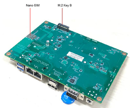

  • 1x 2ch. LVDS, 1x DP and 1x HDMI for displays
  • 2x USB3.2 Gen1, 2x USB2.0, 2x PCIe Gen3.0 x1, 2x 4wire UART, 1x SPI,16x GPIO, 1x I2C, 2x MIPI-CSI x4
  • 1x Micro SD and 1x Nano SIM

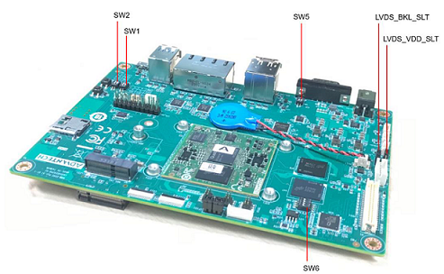

SW1
  • SW1(1-off,2-on) : eMMC boot
  • SW1(1-on,2-on) : UFS boot
SW2
  • SW2(1-on): Forced Recovery
  • SW2(1-off): Normal Boot
  • SW2(2-on): AT mode
  • SW2(2-off):ATx mode

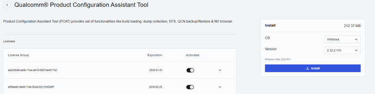

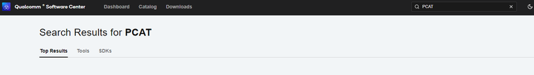

3. Search "PCAT" in the search bar
4. Click Qualcomm® Product Configuration Assistant Tool
5. Select Qualcomm® Product Configuration Assistant Tool version
Version: 2.33.2.119
6. Install Qualcomm® Product Configuration Assistant Tool 2.33.2.119

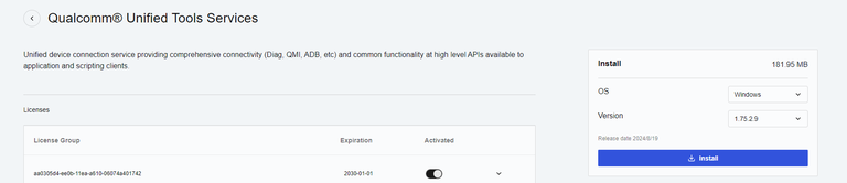

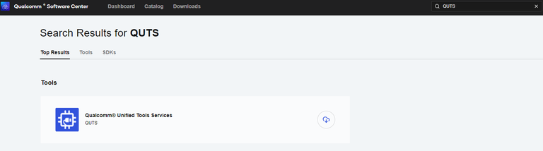

7. Search "QUTS" in the search bar
8. Click the  Qualcomm® Unified Tools Services
9. Select Qualcomm® Unified Tools Services version
Version : 1.75.2.9
10. Install Qualcomm® Unified Tools Services  1.75.2.9

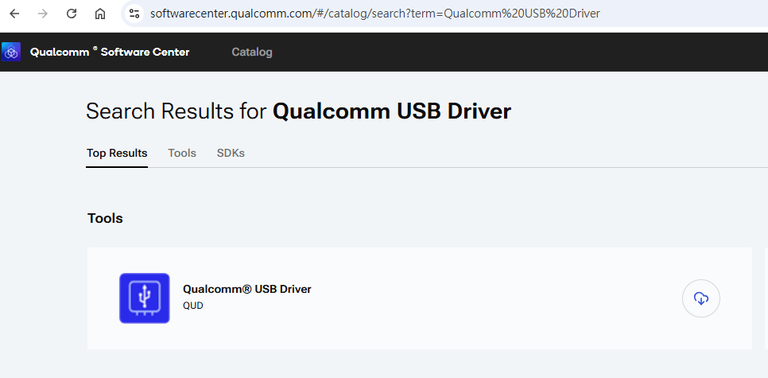

14. if your pc can not identify the USB , please download the " ' Qualcomm USB Driver"
15. Search " Qualcomm USB Driver " in the search bar , then install the driver.

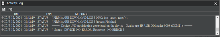

Reformat
For confirmation, we will erase the partition before UFS installation.

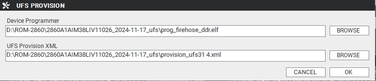

1. Select  provision button
2. Add the prog_firehose_ddr.elf and provision_ufs31.xml in UFS  folder.
3. Then press "OK" , it will start to do USF Provision.
4. When the Provision finished , you can see the result in message window.

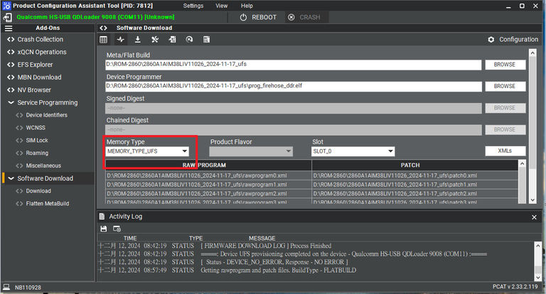

Flash UFS
1. Change the SW1 and SW2
Flash UFS:  the SW1 switch to 1-on, 2-on      Forced Recovery :  The SW2 switch to 1-on  ,2 - on .
2. Turn on the power

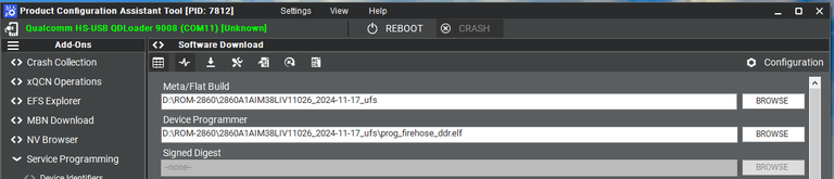

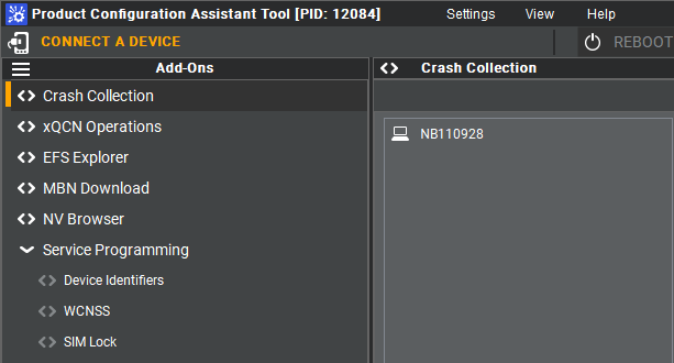

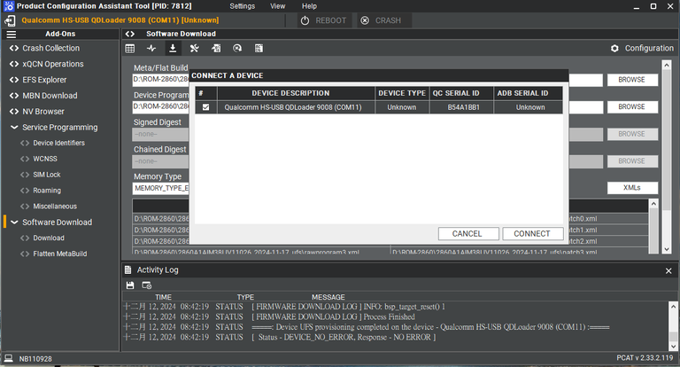

3. Open " PCATApp" Tool
4. Click " Connect A Device"
5. Select  "Qualcomm HS-USB QDLoader 9008 (COM11)
6. Click " Connect "  device
7. When you connected successfully , it will show  "qreen word" - Qualcomm HS-USB QDLoader 9008 (COM 11)

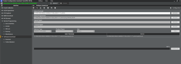

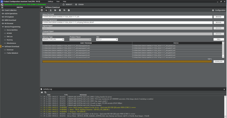

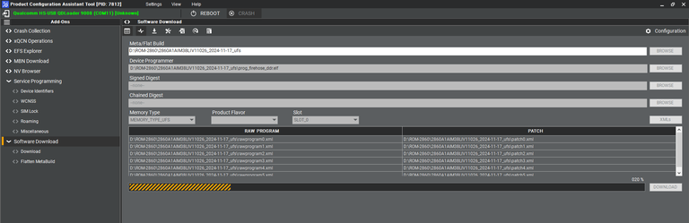

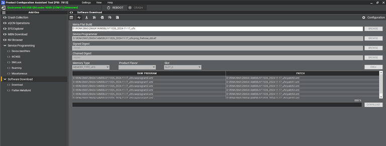

8. Select UFS Folder in PCAT Tool , the Tool will help load Files automatically and Select "MEMORY_TYPE_UFS"
9. Click " Download"
10. UFS Download Status
' 11. UFS Donwload ' completed

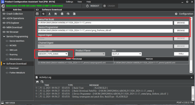

Flash eMMC
1.  Turn off the Power
2. Change the SW1 and SW2
Flash eMMC:  the SW1 switch to 1-off, 2-on      Forced Recovery :  The SW2 switch to 1-on  ,2 - on .
3. Turn on the power
4. Make sure the device connection status.

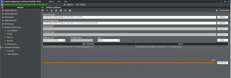

5. If the device disconnect with PCAT Tool , please connect it again.

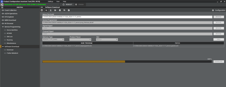

6. Select eMMC Folder.
7. Make sure the setting ,then press " Download " button.
8. eMMC download status
' 9. eMMC Donwload ' completed

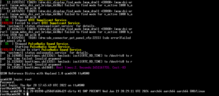

13. Connect debug cable and open the terminal ,  turn on the power .
14.  If you have done " Reformat " , the message will show " DDR: Start of DDR Training Init "
15.  When the systm boot up , you need to type  " qcs6490-rom2860a1 login: root "  , " Password: oelinux123 "
16.  After type the login and password , and you also can chek the image information about date , kernel version etc..

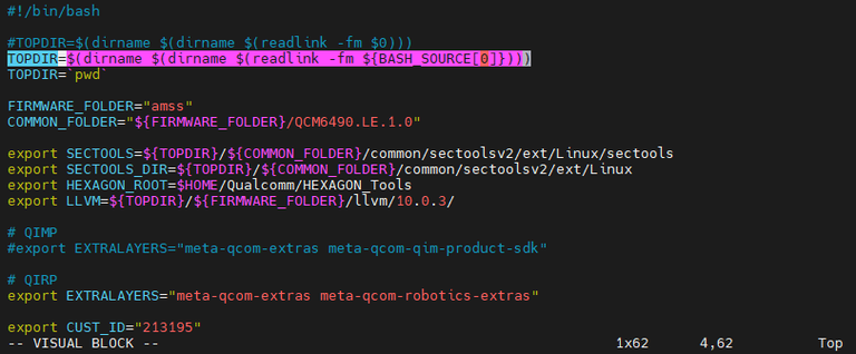

Modify scripts/env.sh file:
#!/bin/bash
#TOPDIR=$(dirname $(dirname $(readlink -fm $0))) TOPDIR=$(dirname $(dirname $(readlink -fm ${BASH_SOURCE[0]})))
