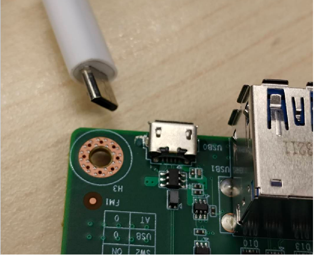

  4. Use micro USB cable downing image to ROM-2860.

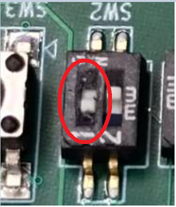

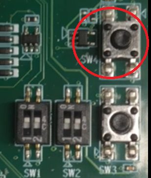

5.Turn off the power, Change AOM-2721 SW1 to 1 on and 2 on  & SW2 1 on & 2off for download mode, then turn on the power.
6.Then Press SW4 button.

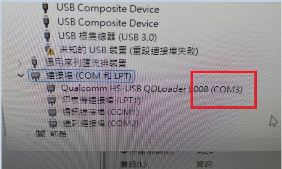

7.You can see QDloader (COMXX) in Device manager(In your laptop or PC)

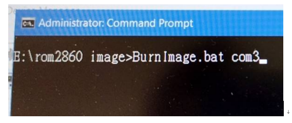

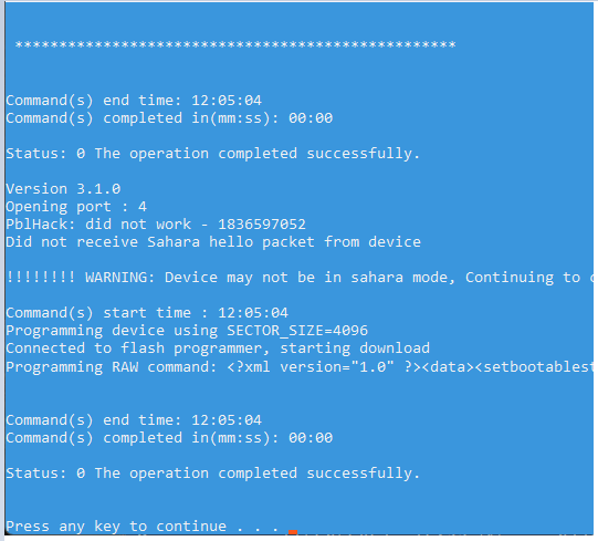

  1. Execute burnimage.bat COMXX
Note: When you execute the bat file . need to “press any key” by three time (you can ignore the message

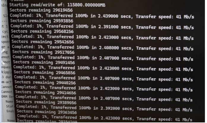

  1. Need to wait 1 or 2 hours (depend on your pc )

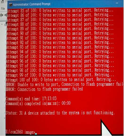

10. If the process fails, it will display the error screen (red screen).
11.If the process successes , it will show “ the operation completed successfully” , then turn off the power

13. Change Switch to 1 off 2 on , then turn on the power

15. After turn the power , press SW4

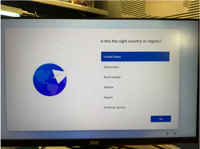

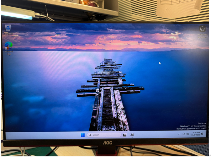

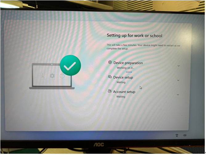

16. Connect with HDMI or DP , Its start to boot up from windows OS.
