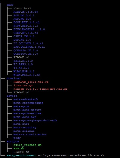

  • Output ufs images: build-qcom-robotics-ros2-humble/tmp-glibc/deploy/images/qcm6490/qcom-robotics-full-image
  • Output emmc images: build-qcom-robotics-ros2-humble/tmp-glibc/deploy/images/qcm6490/qcom-robotics-full-image-emmc

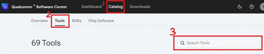

2. Open the Qualcomm Software Center

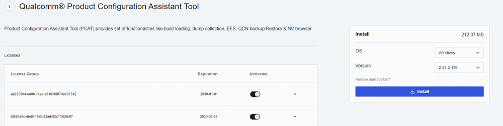

Login in your Qualcomm ID and Click "Catalog -> Tools -> Search Tools"

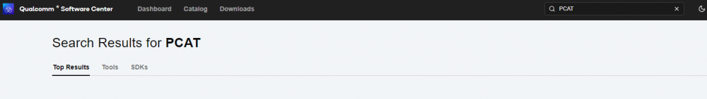

3. Search "PCAT" in the search bar
4. Click Qualcomm® Product Configuration Assistant Tool
5. Select Qualcomm® Product Configuration Assistant Tool version
Version: 2.33.2.119 or 2.40.2.83
6. Install Qualcomm® Product Configuration Assistant Tool

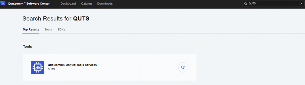

7. Search "QUTS" in the search bar

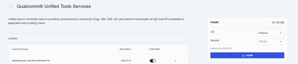

8. Click the  Qualcomm® Unified Tools Services
9. Select Qualcomm® Unified Tools Services version
Version : 1.75.2.9 or 1.82.2.7
10. Install Qualcomm® Unified Tools Services

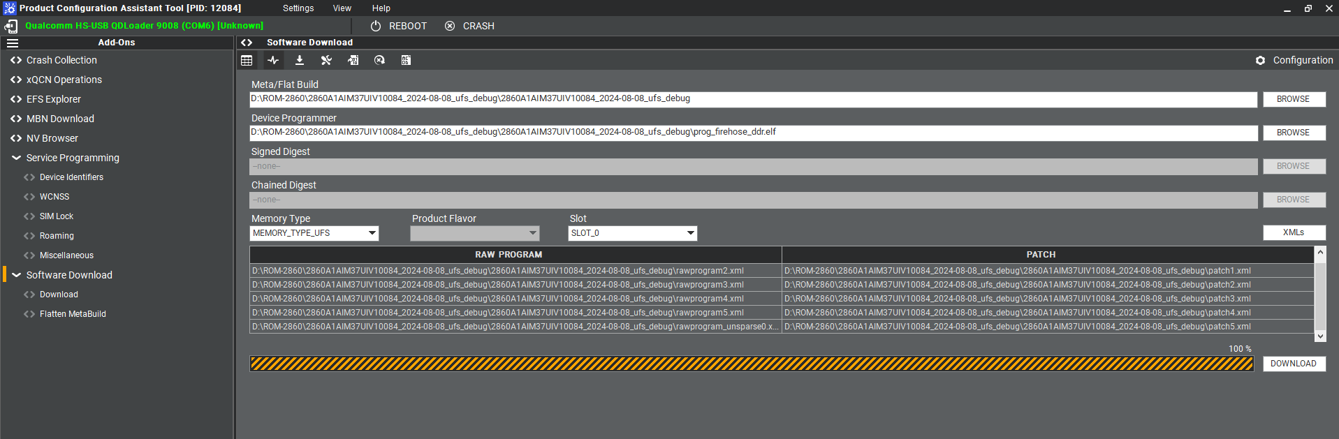

UFS​

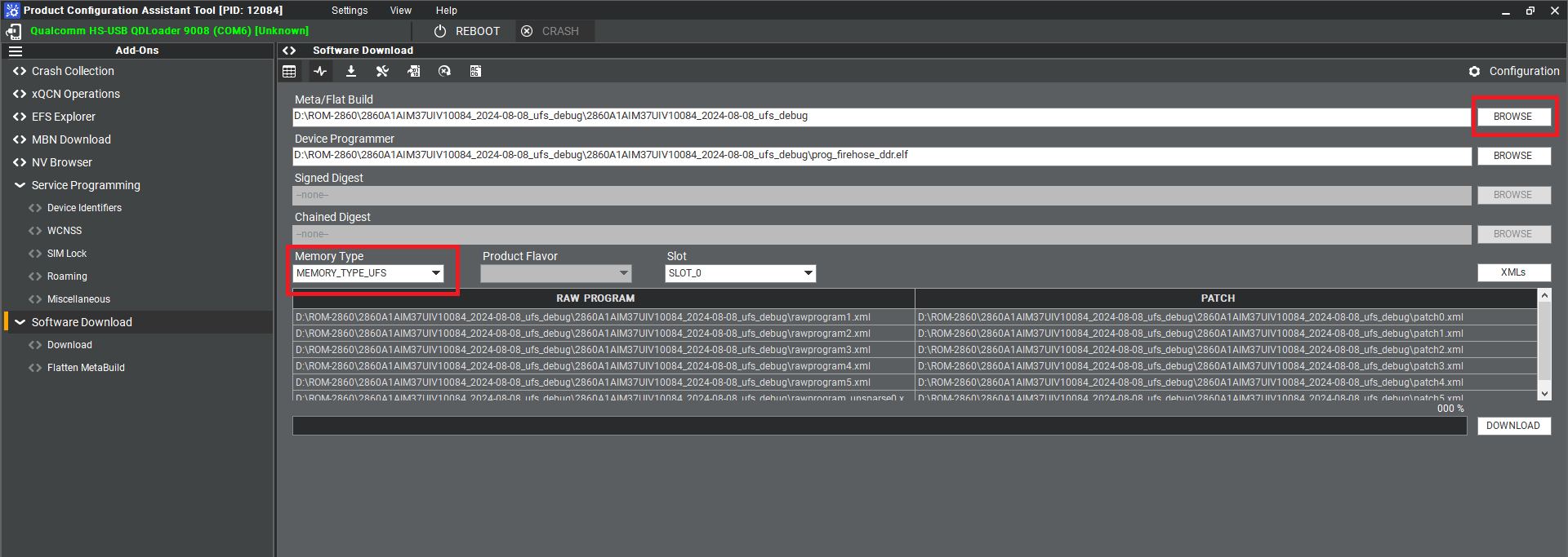

USF Provision
1. Select  provision button
2. Add the prog_firehose_ddr.elf and provision_ufs31.xml in UFS  folder.
3. Then press "OK" , it will start to do USF Provision.
4. When the Provision finished , you can see the result in message window.
Connect to device and Flash
1. Change the SW1 and SW2
Flash UFS:  the SW1 switch to 1-on, 2-on
Forced Recovery :  The SW2 switch to 1-on  ,2 - on .
2. Turn on the power

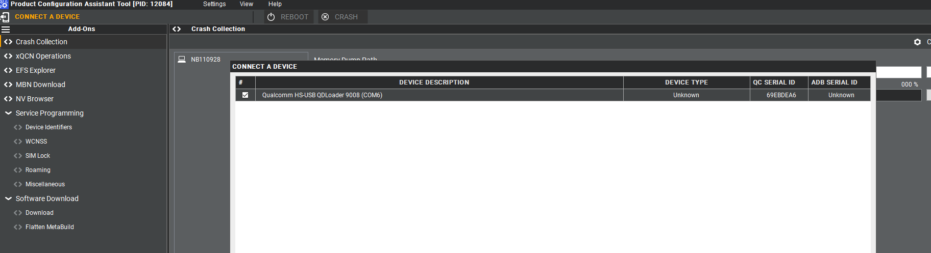

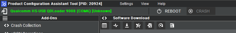

3. Open " PCATApp" Tool
4. Click " Connect A Device"

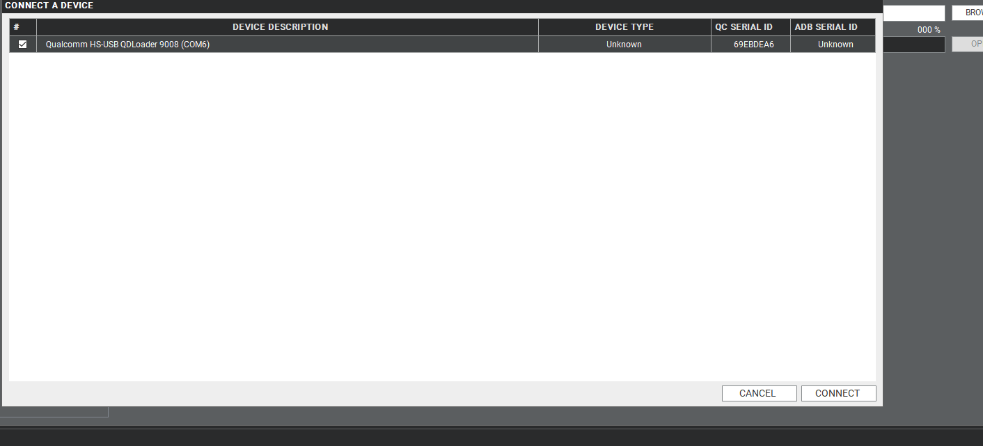

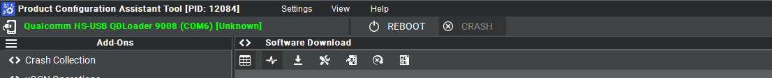

5. Select  "Qualcomm HS-USB QDLoader 9008 (COM6)
6. Click " Connect "  device
7. When you connected successfully , it will show  "green word" - Qualcomm HS-USB QDLoader 9008 (COM 6)

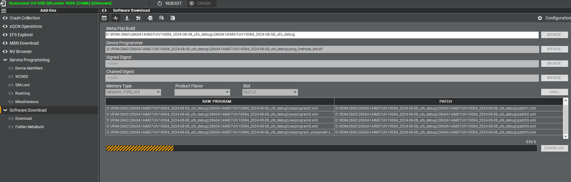

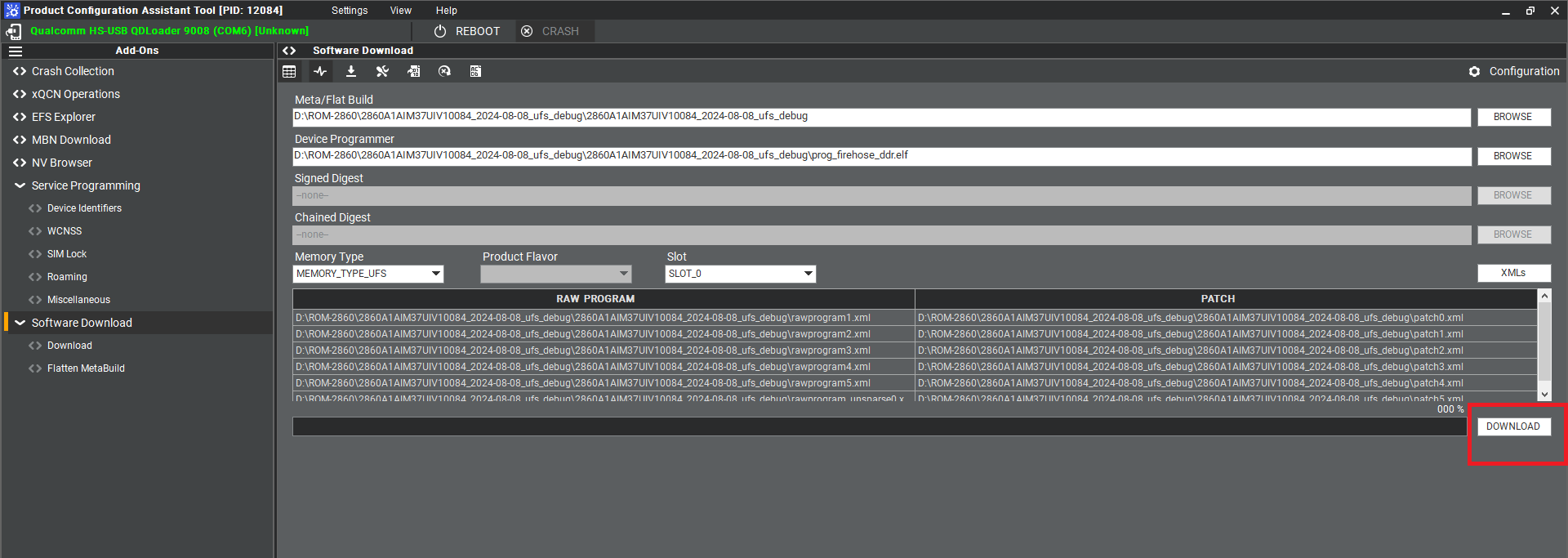

8. Select UFS Folder in PCAT Tool , the Tool will help load Files automatically and Select "MEMORY_TYPE_UFS"
9. Click " Download"
10. UFS Download Status
11. UFS Donwload compeleted

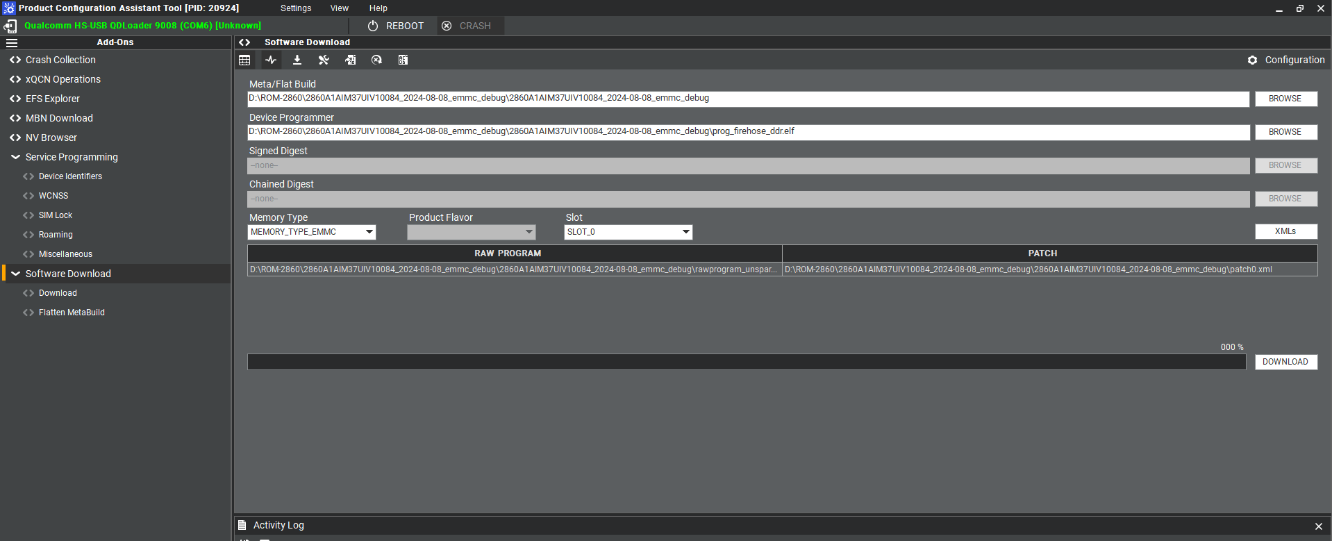

eMMC​
1.  Turn off the Power
2. Change the SW1 and SW2
Flash eMMC:  The SW1 switch to 1-off, 2-on
Forced Recovery :  The SW2 switch to 1-on, 2-on
3. Turn on the power
4. Make sure the device connection status.
5. If the device disconnect with PCAT Tool , please connect it again.

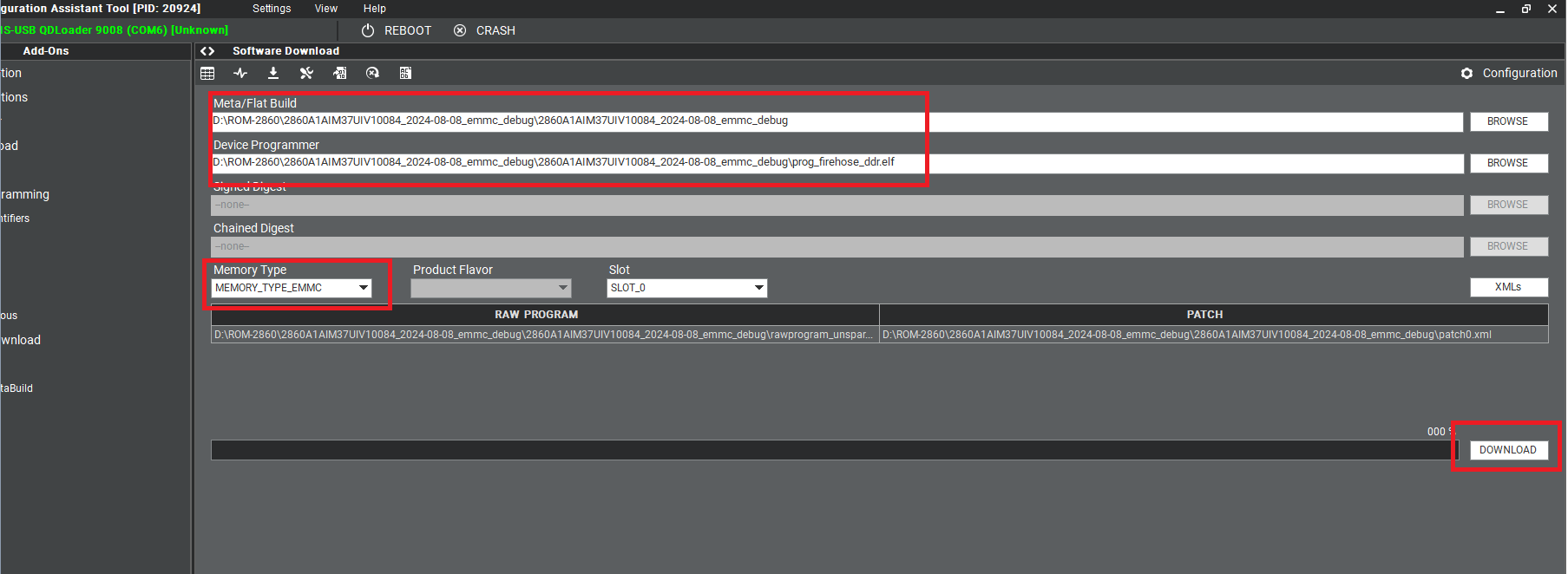

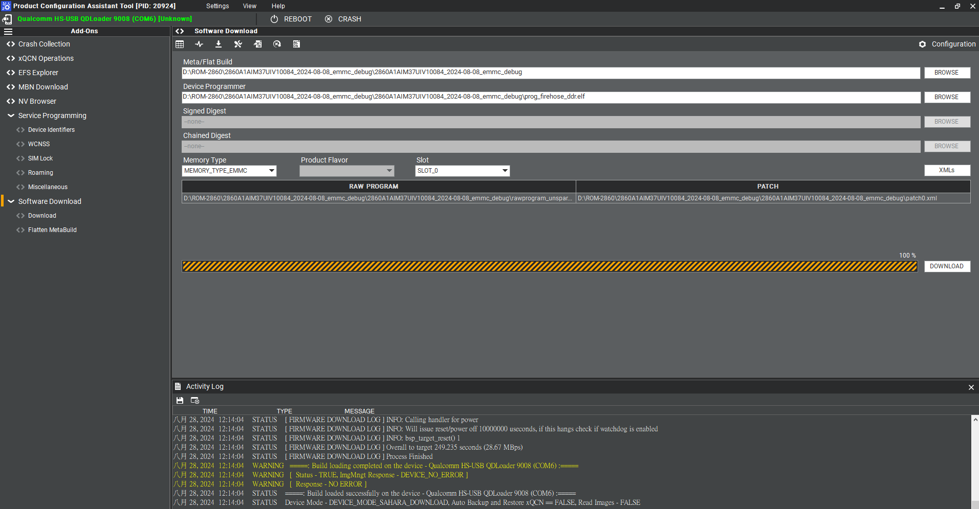

6. Select eMMC Folder.

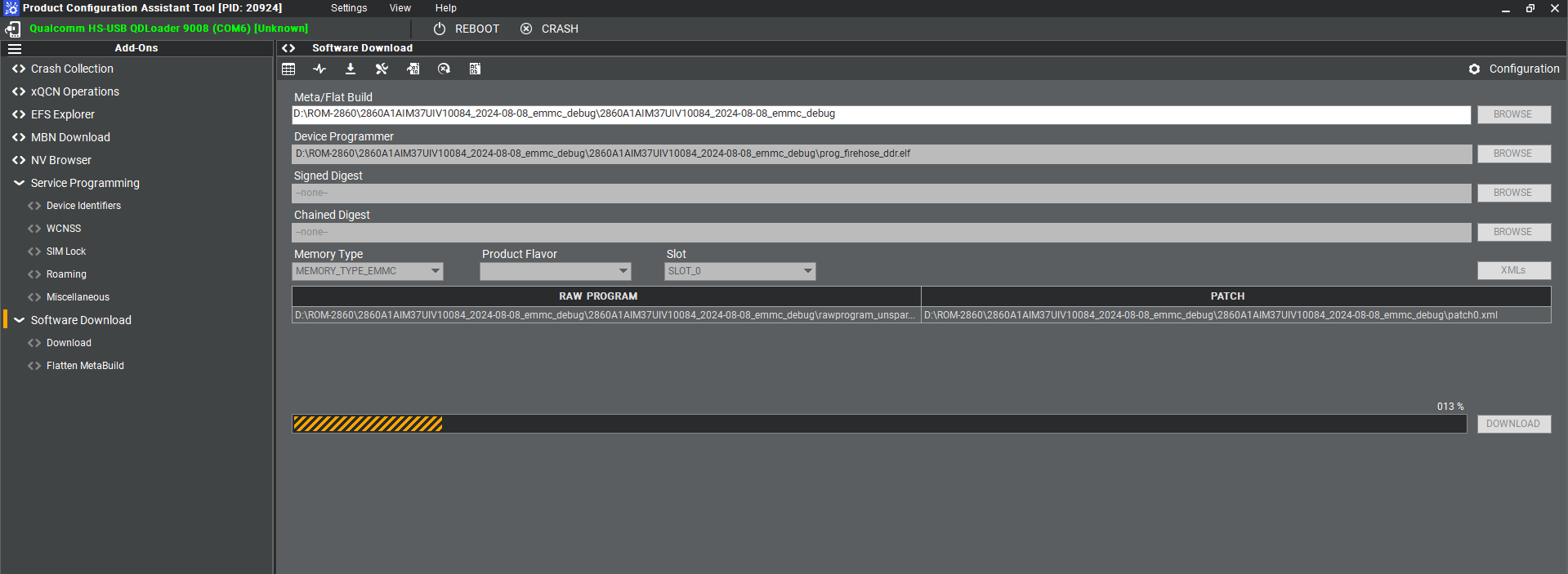

7. Make sure the setting ,then press " Download " button.
8. eMMC downlaoad status
' 9. eMMC D' onwload compeleted
