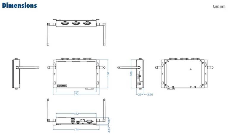

接口布局和尺寸(Layout and Sizes)​
接口布局圖 Board Dimension Layout​
RTENOTITLE
機械尺寸  (**Mechanical Characteristics)​
RTENOTITLE

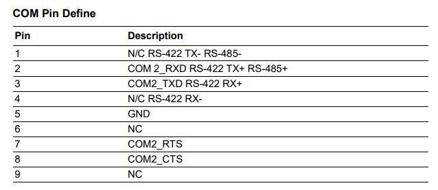

接口引脚定義 (Pin definitions)​
COM Pin Define​
RTENOTITLE

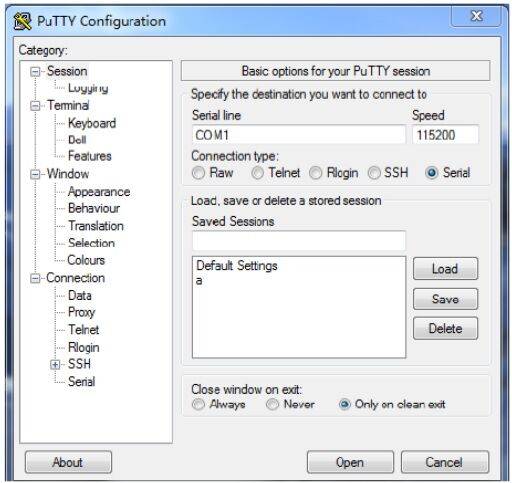

Debug Port設定 (Debug Port Settings)​
EPC-R3430 can communicate with a host server by using serial cables. Common serial communication programs such as HyperTerminal, Tera Term or Putty can be used in this case. The example below describes the serial terminal setup using HyperTerminal on a Windows host: 1. Connect EPC-R3430 with your PC by using a serial cable
  1. Open HyperTerminal on your Windows PC and select the settings as shown below
  2. After the boot loader is programmed on Micro SD card, insert power adapter connector to DC jack on EPC-R3430 to power up the board. The boot loader prompt is displayed on the terminal screen. HyperTerminal Settings for Terminal Setup
RTENOTITLE

COM Pin Define​
RTENOTITLE
