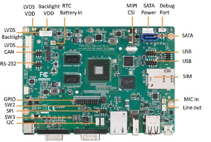

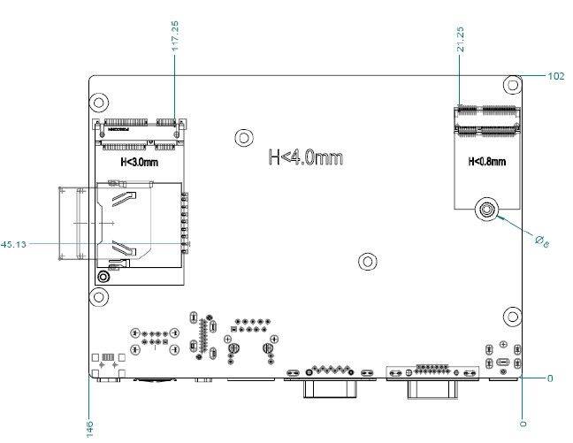

接口布局和尺寸(Layout and Sizes)​
RSB-4411 接口布局圖 Board Dimension Layout​
RTENOTITLE
Rear I/O​
RTENOTITLE

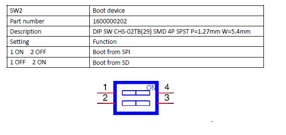

Jumper Settings​
SW2
RTENOTITLE
SW3
RTENOTITLE

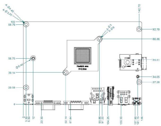

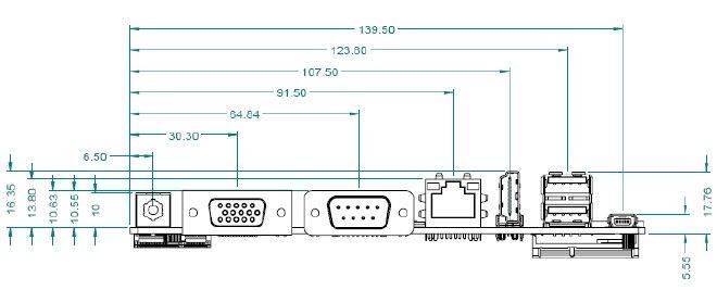

**机械尺寸  (**Mechanical Characteristics)​
RSB-4411
RTENOTITLE
RTENOTITLE
RTENOTITLE

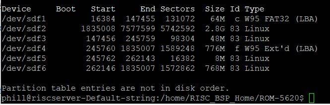

Step0: 檢查SD卡在Linux 環境的代號 (check SD card symbol in Linux system)
RTENOTITLE
RTENOTITLE

Step4: 確認開機選擇指撥開關
           SD 卡開機模式:

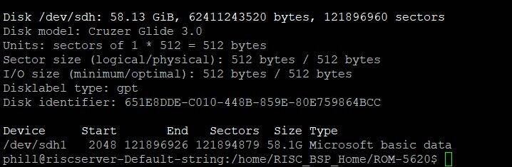

  1. 插入U盤到你的Ubuntu 電腦上 (Plug the USB Disk into you Linux PC
  2. 檢視U盤在Ubuntu 系統代號 (Check the USB Disk's symbol in Ubuntu System)
RTENOTITLE
RTENOTITLE
 3. 掛載U盤在Ubuntu 系統中

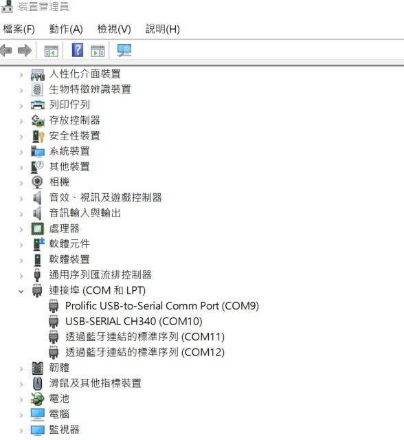

Check the Sriel port in Device Manager (查看PC端的串口号):
if you can not identify the Serial device , please check your serial driver.

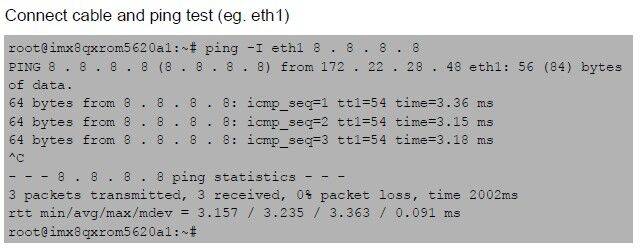

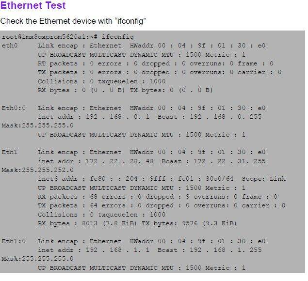

乙太網路使用方法(Ethernent Testing Method)​
Command : ifconfig
RTENOTITLE
Command: Ping - I eth1 8.8.8.8  or Ping - I eth0 8.8.8.8
RTENOTITLE

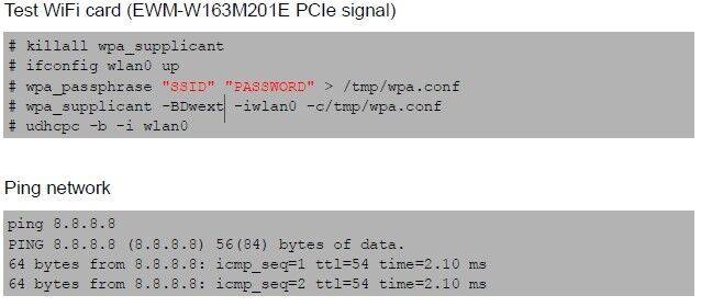

WiFi使用方法(WIFI Testing Method)​
Command :
# killall wpa_supplicant
# ifconfig wlan0 up
# wpa_passphrase "SSID" "PASSWORD" > /tmp/wpa.conf
# wpa_supplicant -BDwext -iwlan0 -c/tmp/wpa.conf
# udhcpc -b -i wlan0'''
ping 8.8.8.8
PING 8.8.8.8 (8.8.8.8) 56(84) bytes of data.
64 bytes from 8.8.8.8: icmp_seq=1 ttl=54 time=2.10 ms
64 bytes from 8.8.8.8: icmp_seq=2 ttl=54 time=2.10 ms
RTENOTITLE

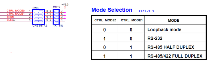

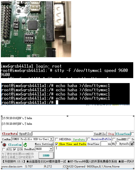

串口使用方法(Serial Port Operating Method)​

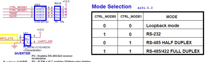

RS-232 Test
RTENOTITLE
SW3 Setting (SW3設置)
RTENOTITLE

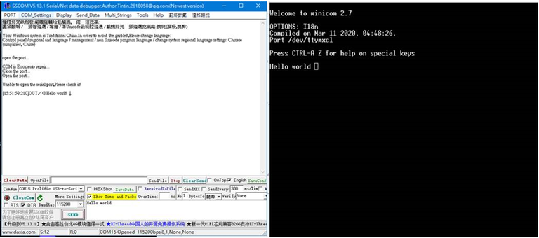

RS-485
Download Test Tool : Test485
RS 485 test (系統預設minincom)
  1. Switch : 2 ->1 , others   off
  2. ./test485 /dev/ttymxc1 tx
RTENOTITLE
 3. minicom -D /dev/ttymxc1
      RTENOTITLE
  1. Open two terminal tool
RTENOTITLE

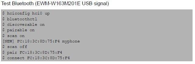

藍芽使用方法(BlueTooth Operating Method)​
Command :
$ hciconfig hci0 up
$ bluetoothctl
$ discoverable on
$ pairable on
$ scan on
[NEW] FC:18:3C:8D:75:F4 myphone
$ scan off
$ pair FC:18:3C:8D:75:F4
$ connect FC:18:3C:8D:75:F4
RTENOTITLE
