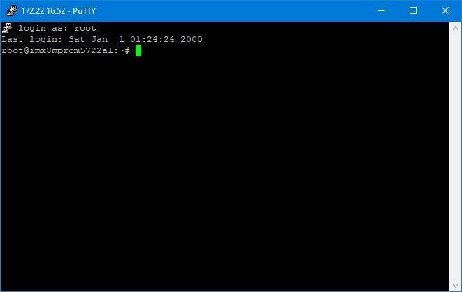

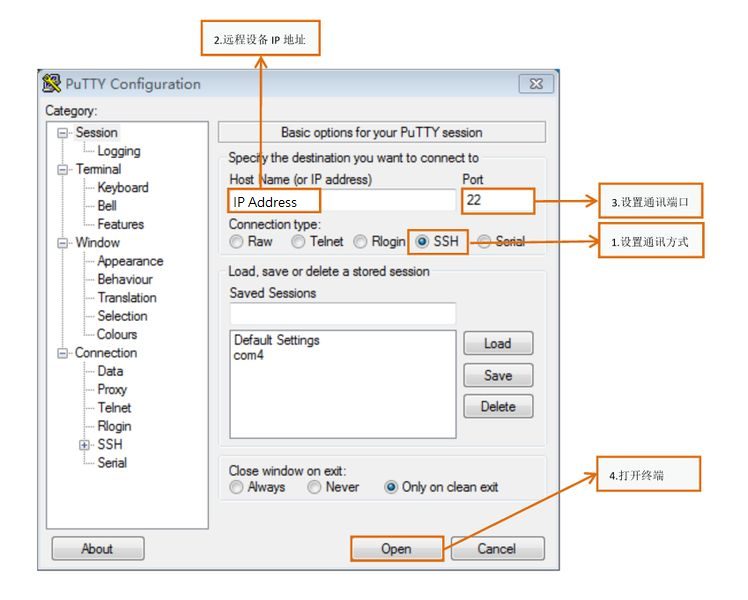

    • 4.9 遠程訪問及文件傳輸 (Remote Access and File Transimmion)
      • 4.9.1 Windows下SSH访问及文件传输

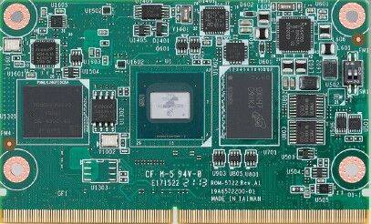

ROM-5722 接口布局圖 Board Dimension Layout​
ROM-5722 module layout

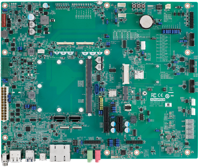

SOM-DB2510 接口布局圖 Board Dimension Layout​
SOM-DB2510 top view
SOM-DB2510 IO

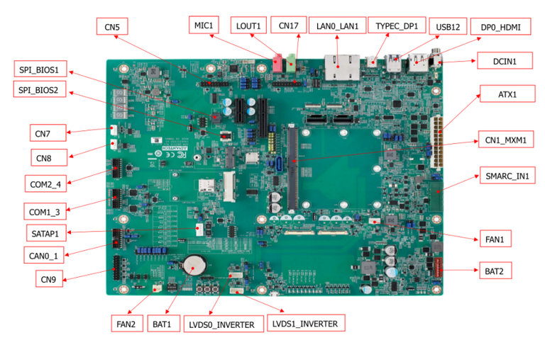

主板内置插针式引脚排序方式 (Pin Header defination)​

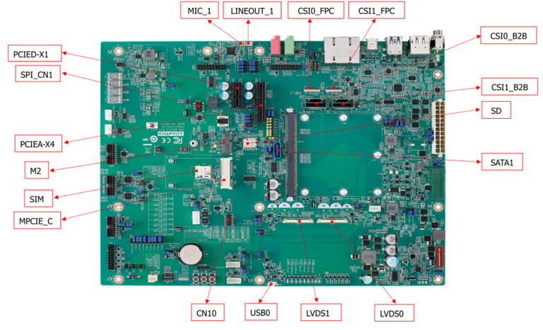

Internal I/O​
SOM-DB2510 connectors 1
SOM-DB2510 connectors 2
LabelFunctionLabelFunction
ATX1ATX ConnectorFAN1Smart Fan Connector
SMARC_IN1Wide Range Input Power Connector (3V~5.25V)FAN2System Fan Connector
DCIN1DCIN connectorCAN0_1CAN Bus Connector

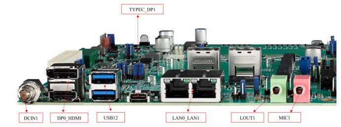

DP0_HDMIDP & HDMI ConnectorUSB0USB OTG Connector
USB12USB 2.0 port1~2 & USB 3.0 port0 ConnectorCOM1_3COM Port Port1,3 Connector
TYPEC_DP1Type-C ConnectorCOM2_4COM Port Port2,4 Connector
LAN0_LAN1LAN0 & LAN1 ConnectorCN8I2C connector for I2C_PM
LOUT1Line Out ConnectorCN7I2C Connector for I2C_GP
MIC1MIC1 ConnectorCN10eSPI Pin Header
CN1_MXM1SMARC ConnectorSATAP1SATA Power Connector
PCIEA-X4PCIe x4 ConnectorCSI0_B2BMIPI B2B Connector for 2M Camera
SATA1SATA Port0 ConnectorCSI1_B2BMIPI B2B Connector for 8M & 13M Camera
PCIED-X1PCIe x1 ConnectorSPI_BIOS1Carrier Board BIOS Socket (SOIC)
M2M.2 Key-E ConnectorBAT1Coin battery holder
MPCIE_CMini PCIe ConnectorBAT2Smart battery Connector
SIMSIM card ConnectorLINEOUT_1I2S Headphone Connector
LVDS1LVDS1 ConnectorMIC_1I2S MIC In Connector
LVDS0LVDS0 ConnectorCSI1_FPCMIPI FPC Connector for 8M & 13M Camera
LVDS1_INVERTERLVDS1 Invertor ConnectorCSI0_FPCMIPI FPC Connector for 2M Camera
LVDS0_INVERTERLVDS0 Invertor ConnectorCN5I2S2 Connector
SPI_BIOS2Carrier Board BIOS Socket (QFN)CN17I2S0 Connector
SDSD Card Connector

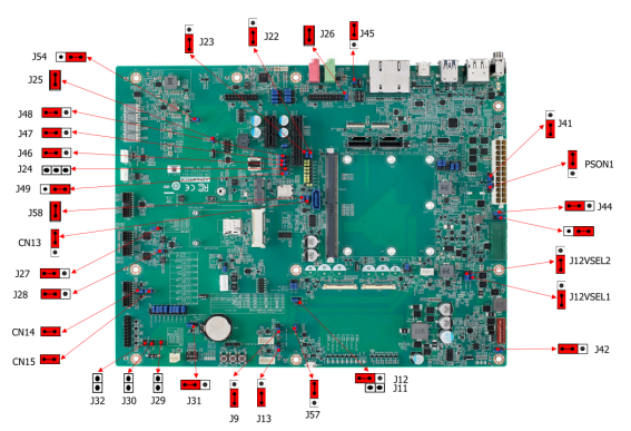

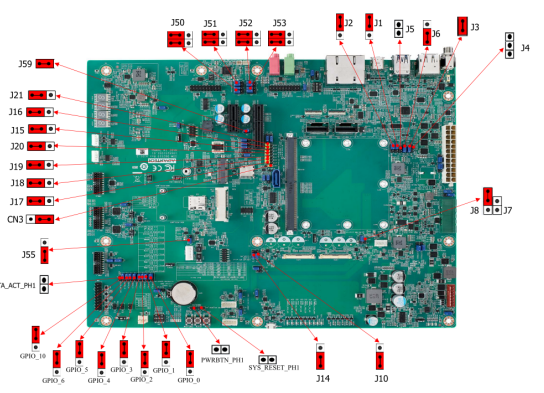

Jumper 位置( Jumper Locations)​
DB-2510 Jumper Locations 1
DB-2510 Jumper Locations 2
LableFunctionLableFunction
BTN3Sleep ButtonJ14EDP1/LVDS1 Hot-Plug Detect Selection Header
BTN1Power ButtonJ56Standby Voltage Control Header
BTN2Reset ButtonJ44Module +3.3V/+5V Power Selection Header
SW4BOOT SELECT SwitchPSON1AT/ATX Selection Header
LID1LID SwitchSPI_CN1SPI Header
J30Enable Battery Low# HeaderCN14For CAN Bus port0 Terminal Resistor
M2E_DISABLE_N1M.2 Wireless DisableCN15For CAN Bus port1 Terminal Resistor
J29SMB Alert Enable HeaderJ3/J4DP0 EQ0 Selection
CN9Header For GPIO TestJ5/J6DP0 EQ1 Selection
J7/J8LVDS0 Power Selection HeaderJ58PCIE_B_CKREQ# Selection
J11/J12LVDS1 Power Selection HeaderJ59PCIE_A_CKREQ# Selection
J9LVDS0 Inverter Power Selection HeadeGPIO_0GPIO0/CAM0_PWR# Selection
J10EDP0/LVDS0 Hot-Plug Detect Selection HeaderGPIO_1GPIO1/CAM1_PWR# Selection
J26HDA/I2S Selection HeaderGPIO_2GPIO2/CAM0_RST# Selection
J1DP1/HDMI1 SelectGPIO_3GPIO3/CAM1_RST# Selection
J13LVDS1 Inverter Power Selection HeaderGPIO_4GPIO4/HDA_RST# Selection
J31Clear CMOS HeaderGPIO_5GPIO5/PWM_OUT Selection
J25SPI Power HeaderGPIO_6GPIO6/TACHIN Selection
SW1COM1 mode SelectSATA_ACT_PH1SATA act# Header
SW2COM3 mode SelectPWRBTN_PH1Power button Header
J41Core Power Voltage Control HeaderSYS_RESET_PH1Reset button Header
J2DDI1 AUX/DDC Selection

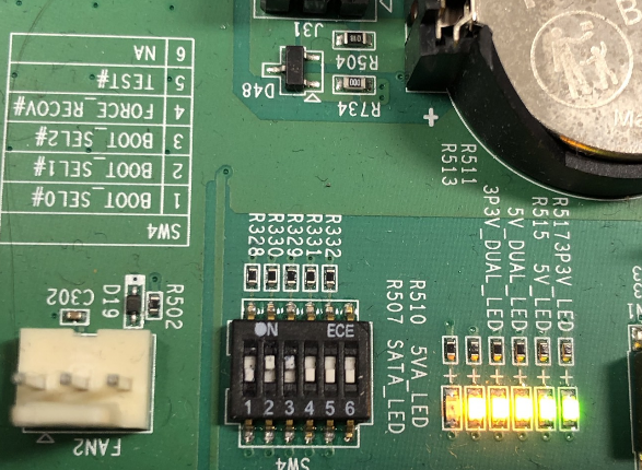

  • SW4 (Boot Select/Force Recovery/Test Switches)
  • LID1 (LID Button Enable/Disable Switches)
  • SW5 (LAN CONN LED Pull High Switches)

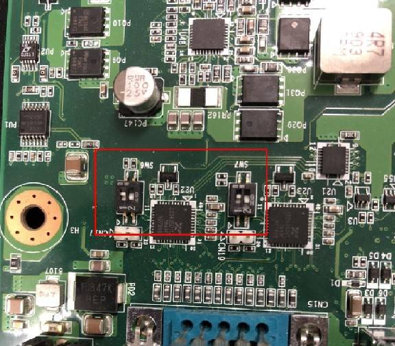

  • SW1 (COM0 Settings)
  • SW2 (COM2 Settings)
  • SW3 (I2S Clock Settings)
  • M2E_DISABLE_N1 (M.2 Wireless Disable Switch)

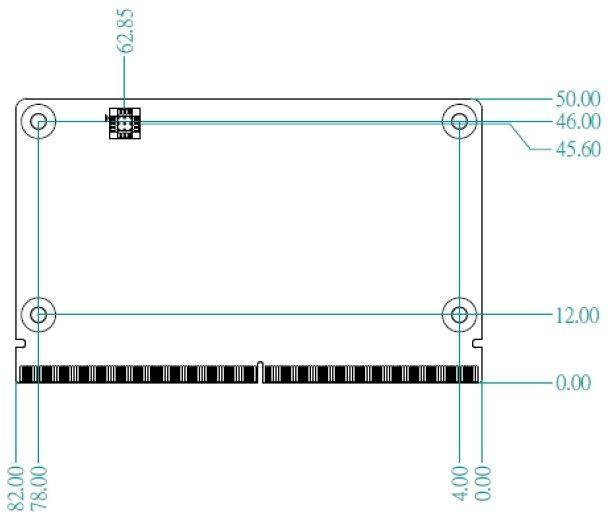

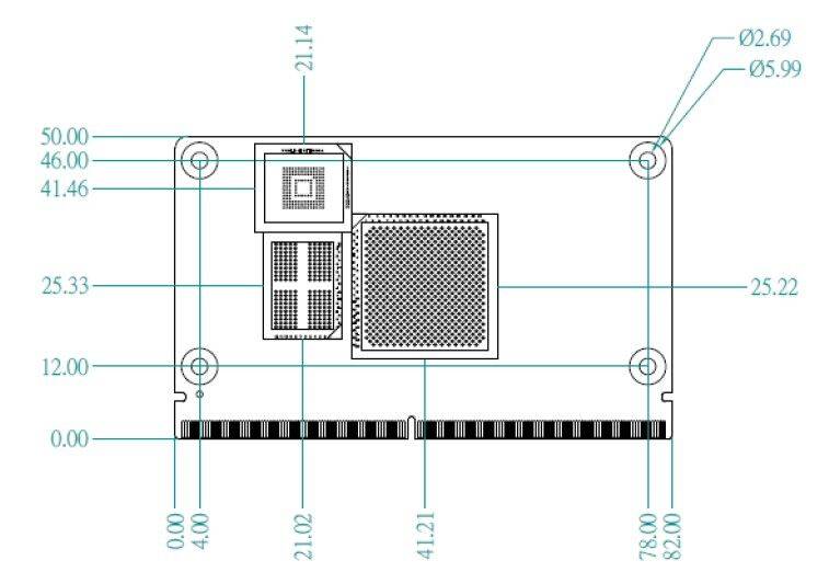

机械尺寸 (Mechanical Characteristics)​
ROM-5722
ROM-5722 Mechanical Specifications 1
ROM-5722 Mechanical Specifications 2

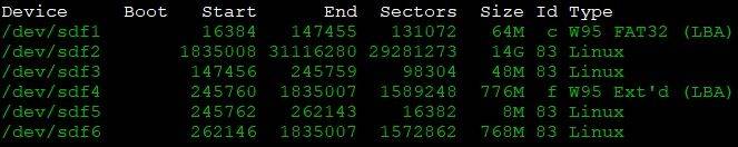

Step0: 檢查SD卡在Linux 環境的代號 (check SD card symbol in Linux system)
Check SD card symbol
Step1: 創造一張可開機的SD 卡 (Create a bootable SD card)
Command:
sudo dd if=5722A1AIM30LIVA0271_iMX8MP_6G_2021-06-19.img of=/dev/sdf bs=1M conv=fsync status=progress
Create bootable SD card

Step4: 確認開機選擇指撥開關
  • SD 卡開機模式: (2, 3:on, others off)
  • eMMC 開機模式: (1: on, others off)
Boot switch setting

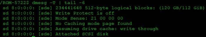

  1. 插入U盤到你的Ubuntu 電腦上 (Plug the USB Disk into your Linux PC)
  2. 檢視U盤在Ubuntu 系統代號 (Check the USB Disk's symbol in Ubuntu System)
Check USB disk symbol

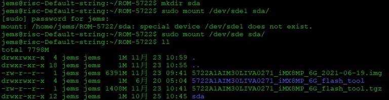

  1. 掛載U盤在Ubuntu 系統中 (Mount the USB Disk in Ubuntu)
Mount USB disk

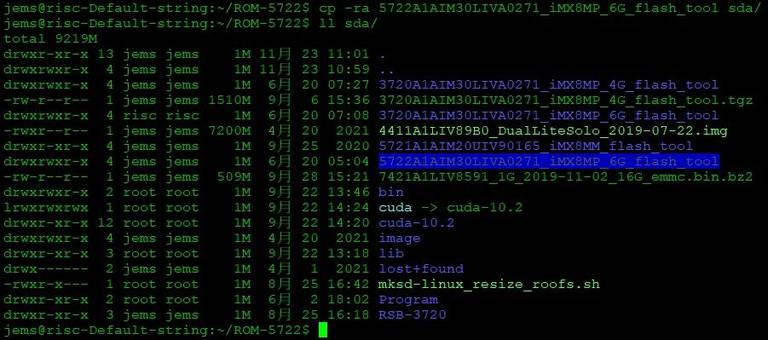

  1. 複製檔案到U盤 (Copy the file to USB disk)
Copy file to USB disk

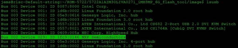

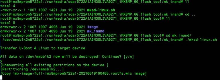

  1. 將U盤連接到ROM-5722系統, 進入flash tool下的mk_inand資料夾, 執行指令 ./mksd-linux.sh /dev/mmcblk2 燒錄image到eMMC (Connect USB Disk to ROM-5722 system, browse to mk_inand folder and execute flash shell script ./mksd-linux.sh /dev/mmcblk2)
ROM-5722
SD card/dev/mmcblk1
eMMC/dev/mmcblk2
Flash eMMC
  1. 切換開機switch 1:on 2,3,4,5,6:off來設定成從eMMC開機 (Change boot switch to "1:on 2,3,4,5,6:off" to boot from eMMC. Reboot system).

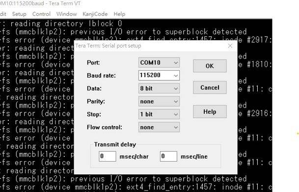

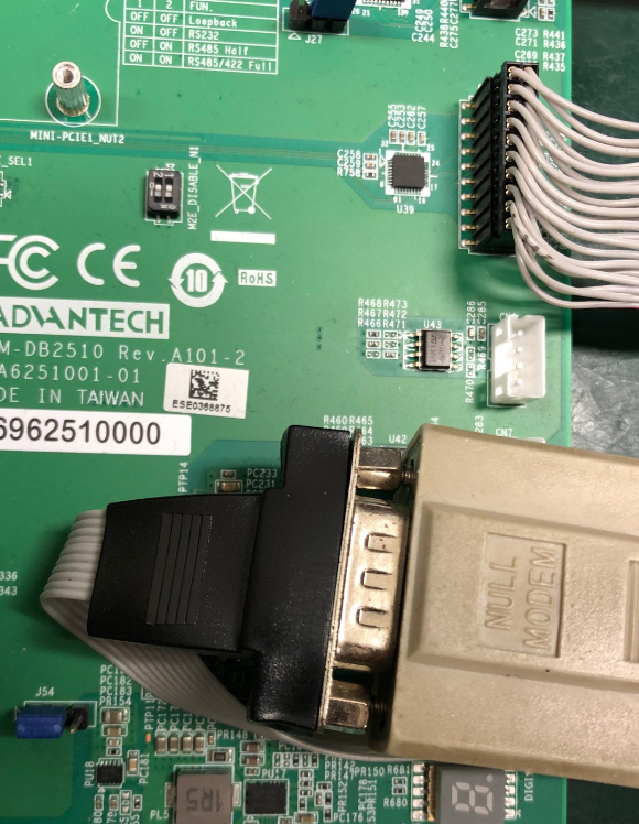

Debug 串口調試 (Debug port Setting)​
Debug port output:
ROM-5722 CPUROM-5722 golden fingerDB5901DB2510
UART1SER2CN15B downCOM3
UART2: A53SER3COM3COM4
UART3SER0CN15A upCOM1
UART4: M7SER1COM1COM2

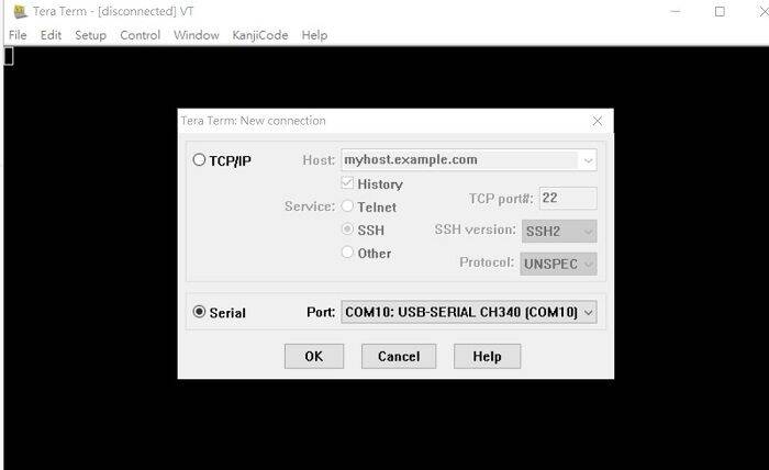

以 Tera Term 为例介绍如何使用串口调试功能
Baud Rate波特率:115200
Data 数据位:8
Parity 奇偶校验:无
Stop 停止位:1
Flow Control流控:无
Tera Term Tool
Tera Term setup 1
Tera Term setup 2

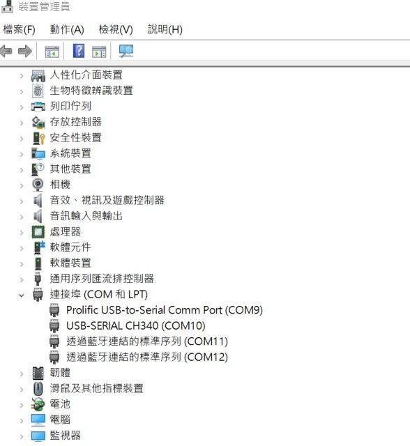

Check the Serial port in Device Manager (查看PC端的串口号):
if you can not identify the Serial device, please check your serial driver.
COM port in device manager
Debug port connection (串口連接)

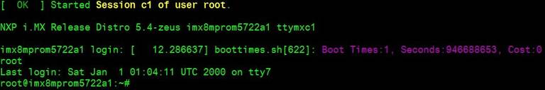

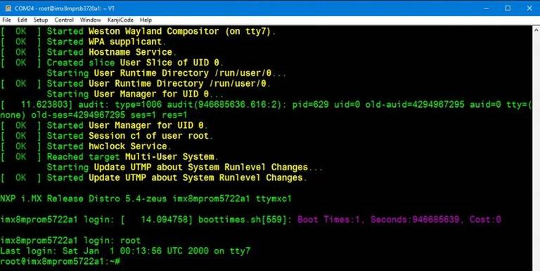

Log into Terminal Tool (进入串口调试终端):
Log into terminal

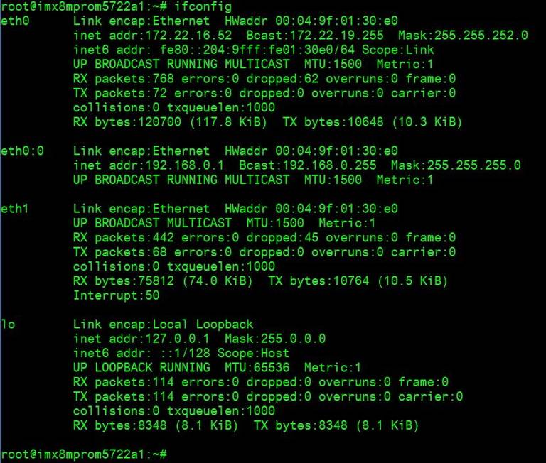

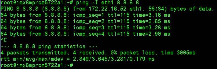

乙太網路使用方法(Ethernent Testing Method)​

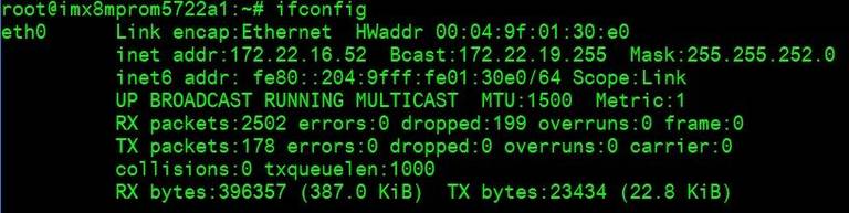

Command: ifconfig
ifconfig output
Command: Ping -I eth1 8.8.8.8 or Ping -I eth0 8.8.8.8
Ping test

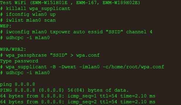

# killall wpa_supplicant
# ifconfig wlan0 up
# iwlist mlan0 scan
WEP:
# iwconfig mlan0 txpower auto essid "SSID" channel 4
# udhcpc -i mlan0
WPA/WPA2:
# wpa_passphrase "SSID" > wpa.conf
Type password
# wpa_supplicant -B -Dwext -imlan0 -c/home/root/wpa.conf
# udhcpc -i mlan0
ping 8.8.8.8
PING 8.8.8.8 (8.8.8.8) 56(84) bytes of data.
64 bytes from 8.8.8.8: icmp_seq=1 ttl=54 time=2.10 ms
64 bytes from 8.8.8.8: icmp_seq=2 ttl=54 time=2.10 ms
WiFi test

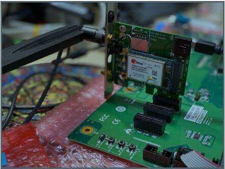

4G使用方法(4G Testing Method)​
Command:
Test 4G: (EWM-C117FL06E - USB)
Step 1: Connect EWM-C117FL06E to Mini PCIE slot on 9680015491 and connect
the card to CN6 PCIe_D slot on ROM-DB5901.
Step 2: Connect the antenna 1750007990-01 to the SMA (F) connector on
9680015491 and connect the IPEX connector to MT1 on EWM-C117FL06E module.
Step 3: Connect the Mini USB cable from 9680015491 to USB 2.0 Type A port on
ROM-DB5901.
Step 4: Power on and execute the pppd command to connect to the network.
4G test 1

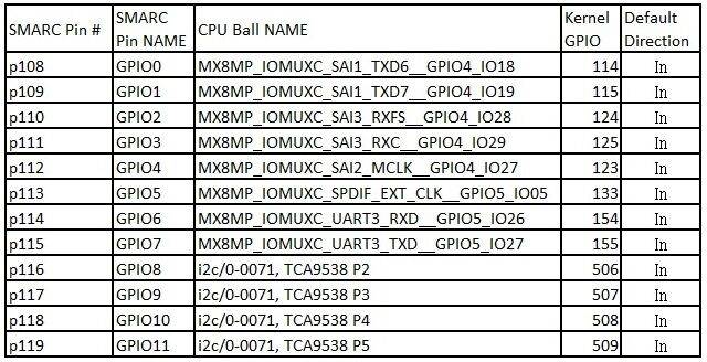

GPIO使用方法(GPIO Operating Method)​
GPIO pin:
4G test 2
Loop-back Test (Take GPIO0 and GPIO2 as examples)
Step 1: Connect GPIO0 and GPIO2
Step 2: Export GPIO interface
root@imx8mprom5722a1: ~# echo 114 > /sys/class/gpio/export
root@imx8mprom5722a1: ~# echo 124 > /sys/class/gpio/export
Step 3: Set direction
root@imx8mprom5722a1: ~# echo out > /sys/class/gpio/gpio1/direction
root@imx8mprom5722a1: ~# echo in > /sys/class/gpio/gpio2/direction
Step 4: Read value and set output value then check
root@imx8mprom5722a1: ~# cat /sys/class/gpio/gpio2/value
0
root@imx8mprom5722a1: ~# echo 1 > /sys/class/gpio/gpio1/value
1
串口使用方法(Serial Port Operating Method)​
RS-232 Test
CN15上 (SER0/UART3): /dev/ttymxc2
CN15 下 (SER2/UART1): /dev/ttymxc0
COM 3 (A53 debug/SER3/UART2): /dev/ttymxc1
COM 1 (M7 debug/SER1/UART4): /dev/ttymxc3
SW7 Setting (SW7設置)
SW6 & SW7 setting
MODE1  MODE0
0 0 LOOPBACK
0 1 RS232
1 0 RS485
1 1 RS422
Loopback test (eg. ttymxc0) Connect loopback test tool
stty -F /dev/ttymxc0 115200
stty -F /dev/ttymxc0 -echo
cat /dev/ttymxc0 &
echo test > /dev/ttymxc0

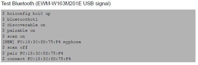

蓝牙使用方法(BlueTooth Operating Method)​
$ hciconfig hci0 up
$ bluetoothctl
$ discoverable on
$ pairable on
$ scan on
[NEW] FC:18:3C:8D:75:F4 myphone
$ scan off
$ pair FC:18:3C:8D:75:F4
$ connect FC:18:3C:8D:75:F4
Bluetooth test

查看主板IP位址 ( Check IP Address ):
Command : ifconfig
ifconfig IP address

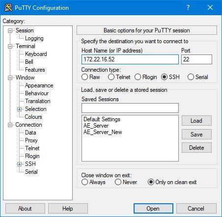

Windows下SSH访问及文件传输​

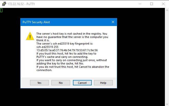

SSH Remote Log into Device
  • SSH远程登录,以putty选择putty.exe(或者使用Xshell、SecureCRT等类似软件)
  • 需要设置远程设备的IP、通讯端口(默认22)、通讯方式,登录后验证用户名密码
SSH setting detail
SSH login 1
SSH login 2

網路Ping測試(Ping Network Testing)​
ping 8.8.8.8
