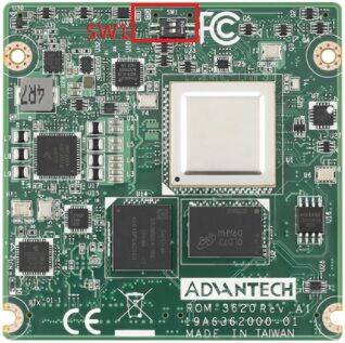

Z51
PositionDescription
SW1(1)UART & Debug Port selection
SW1(2)AT & ATX mode selection
SW1(1): UART & Debug Port selection
SettingFunction
1-OnNormal UART
1-OffDebug Console (Default)
SW1(2): AT/ATX Mode Selection
SettingFunction
2-OnAT Mode (Default)
2-OffATX Mode

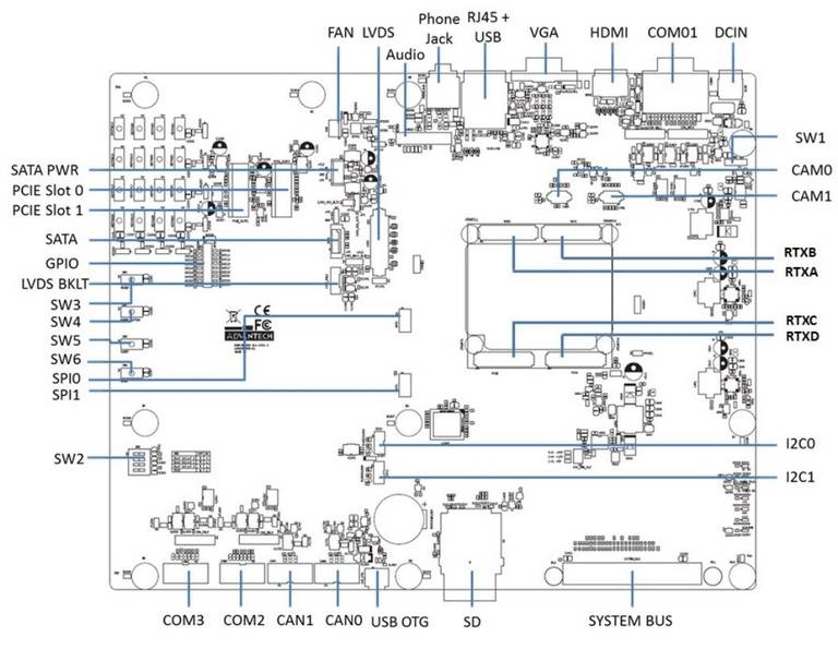

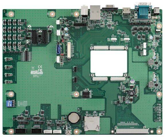

ROM-DB3900 接口布局圖 Board Dimension Layout​
Z54
Z53
主板内置插针式引脚排序方式 (Pin Header definition)​
Internal I/O​
Z55
PositionDescriptionConnector Type
DCINDC-inDC POWER JACK 2.5mm 90D(M) DIP 2DCG213B200
COM01COM PortD-SUB Conn. 18P 90D(M) DIP DM10151-H531-4F
HDMIHDMIHDMI Conn. 19P 0.5mm 90D(F) SMD QJ51191-LFB4-7F
VGAVGAD-SUB Conn. 15P 90D(F) DIP 070242FR015S200ZU
RJ45+USBLAN+USBPhoneJack RJ45+USB3.0*2 32P 90D(F) DIP 05-A00919
Phone JackPhone JackAudio Jack 9P 2.5mm 90D(F) DIP ABA-JAK-03
AudioAudioPIN HEADER 2x10P 2.54mm 180D(M) DIP 21N22564
LVDSLVDSB/B Conn. 40P 1.25mm 90D SMD DF13-40DP-1.25V(91)
FANFANWafer 2.54mm 3P 180D(M) DIP 22-27-2031
SATA_PWRSATA powerWAFER 4P 2.5mm 180D(M) DIP 24W1161-04S10-01T
PCIE_SLOT0PCIE_SLOT0PCIEXPRESS 36P 180D(F) DIP 2EG01817-D2D-DF
PCIE_SLOT1PCIE_SLOT1PCIEXPRESS 36P 180D(F) DIP 2EG01817-D2D-DF
SATASATASerial ATA 7P 1.27mm 180D(M) DIP WATM-07DBN4A3B8
GPIOGPIOPIN HEADER 10x2P 2.0mm 180D(M) DIP 21N22050
LVDS_BKLTLVDS BacklightWAFER BOX 2.0mm 5P 180D(M) DIP WO/Pb JIHVEI
SW3Reset buttonTACT SW STS-091 SMD 4P H=3.8mm
SW4Power buttonTACT SW STS-091 SMD 4P H=3.8mm
SW5Sleep buttonTACT SW STS-091 SMD 4P H=3.8mm
SW6Wake up buttonTACT SW STS-091 SMD 4P H=3.8mm
SPI0SPI0PIN HEADER 2x4P 2.54mm 180D(M) DIP 210-92-04GB02
SPI1SPI1PIN HEADER 2x4P 2.54mm 180D(M) DIP 210-92-04GB02
SW2Boot selectionDIP SW EDG104S DIP 6P Radial SPST
COM3COM3BOX HEADER 5x2P 2.54mm 180D(M) DIP 23N6960-10S10
COM2COM2BOX HEADER 5x2P 2.54mm 180D(M) DIP 23N6960-10S10
CAN1CAN1BOX HEADER 5x2P 2.54mm 180D(M) DIP 23N6960-10S10
CAN0CAN0BOX HEADER 5x2P 2.54mm 180D(M) DIP 23N6960-10S10
USB_OTGUSB OTGMINI USB 5P 180D(F) SMD UH51543-CS7-7F
SDSDSD CARD 9P 90D(F) SMD WK2192C-S3D-7H
System_BusSYSTEMBUSPCB SKT 30x4P 2.00mm 180D(F) DIP 264-40303-02
I2C0I2C0WAFER BOX 2.0mm 4P 180D(M) W/LOCKA2001WV2-4P
I2C1I2C1WAFER BOX 2.0mm 4P 180D(M) W/LOCKA2001WV2-4P
RTXA,RTXB, RTXC,RTXDRTX B2B ConnectorB/B Conn. 50x2P 0.5mm 180D(M) SMDAXK500137YG

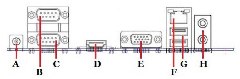

Rear I/O​
Z56
PositionDescriptionName
DCINDC JackA
COM01AUART Port 1B
COM01BUART Port 2C
HDMIHDMI PortD
VGAVGA PortE
RJ45+USBGbE Ethernet ConnectorF
RJ45+USBUSB Port 1/ 2G
PHONE_JACKMIC Input/ Audio OutputH

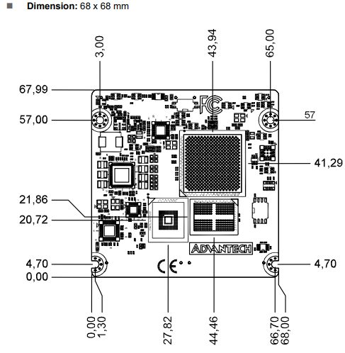

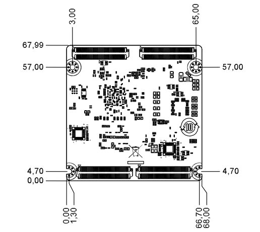

机械尺寸 (Mechanical Characteristics)​
ROM-3620
ROM-3620-MS1 ROM-3620-MS2
