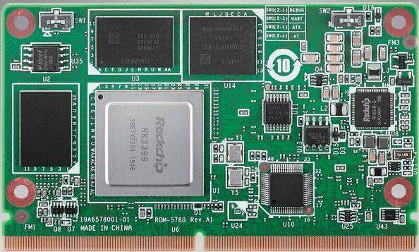

ROM-5780
硬件接口說明(Hardware interface introduction)​

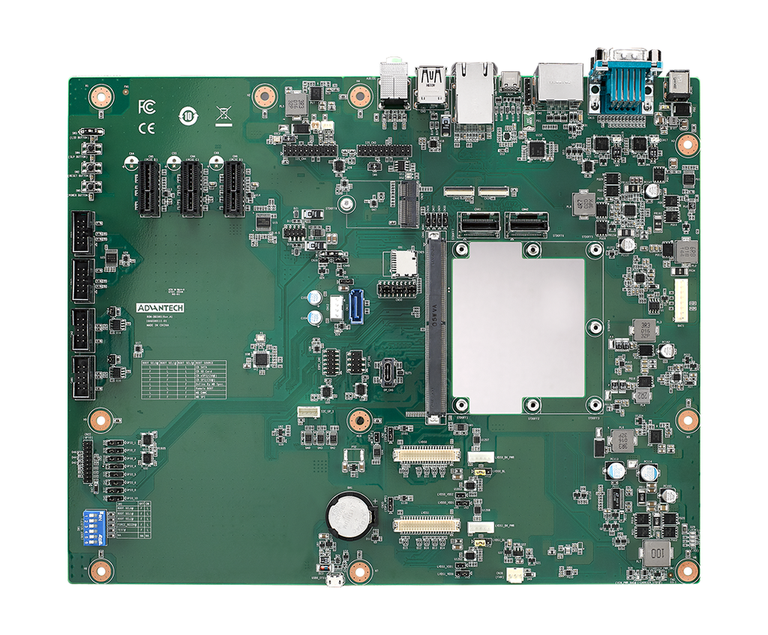

ROM-5780 接口布局圖 Board Dimension Layout​
RTENOTITLE
Board Connectors​

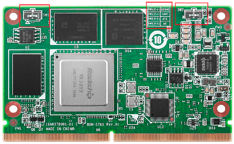

The board has one switch that allows you to configure your system.
RTENOTITLE

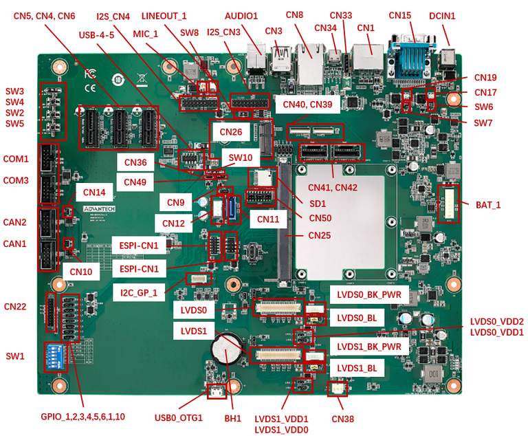

Connector List​
Switch
PositionDescription
SW1UART & Debug Port selection
SW2AT & ATX mode selection
SW1: UART & Debug Port Selection
SettingFunction
SW1(2-3)Normal UART
SW1(2-1)Debug Console (Default)
SW2: AT/ATX Mode Selection
SettingFunction
SW2(2-3)AT Mode (Default)
SW2(2-1)ATX Mode

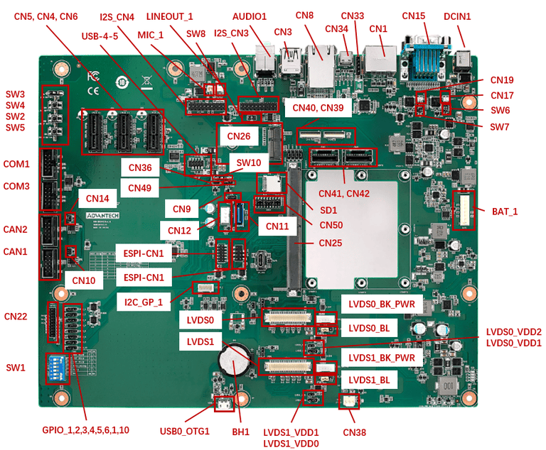

ROM-DB5901-SWA2 接口布局圖 Board Dimension Layout​
RTENOTITLE
RTENOTITLE
主板内置插针式引脚排序方式 (Pin Header defination)​
Internal I/O​
RTENOTITLE
---------PositionDescriptionConnector TypeBAT1PIN Header for BatteryWAFER 8P 2.54mm 180D(M) DIP A2543WV2-8PBH1RTC Battery HolderBATTERY HOLDER 24.9*23.4*8.9 CR2032 BH800.4GGCAN1CANBus Port 1BOX HEADER 5x2P 2.54mm 180D(M) DIP 23N6960-10S10CAN2CANBus Port 2BOX HEADER 5x2P 2.54mm 180D(M) DIP 23N6960-10S10COM1COM Port 1BOX HEADER 5x2P 2.54mm 180D(M) DIP 23N6960-10S10COM3COM Port 3 (Debug Port)BOX HEADER 5x2P 2.54mm 180D(M) DIP 23N6960-10S10CN4PCIex1 Connector 1PCIEXPRESS 36P 180D(F) DIP 2EG01817-D2D-DFCN5PCIex1 Connector 2PCIEXPRESS 36P 180D(F) DIP 2EG01817-D2D-DFCN6PCIex1 Connector 3PCIEXPRESS 36P 180D(F) DIP 2EG01817-D2D-DFCN11SATA ConnectorSerial ATA 7P 1.27mm 180D(M) DIP WATM-07DBN4A3B8CN12SATA Power ConnectorWAFER 4P 2.5mm 180D(M) DIP 24W1161-04S10-01TCN22GPIOx8 setsPIN HEADER 10x2P 2.0mm 180D(M) DIP 21N22050CN25MXM 3.0 ConnectorMXM Conn. 314P 90D(F) SMD AS0B821-S78B-7HCN26M.2 Key E SlotsNGFF 75P 0.5mm 90D(F) H=4.2mm SMD AS0BC21-S40BECN38FAN (Reserved)WTB Con. 3P 2.54mm 180D(M) DIP A2543WV0-3P-6T-5eCN39MIPI-CSI1 (FPC, 4-LaneFPC 39P, 0.6mm, H0.9mmCN40MIPI-CSI0 (FPC, 2-Lane)FPC 39P, 0.6mm, H0.9mmCN41MIPI-CSI0 (Mini-SAS, 2-Lane)Mini SAS 36P/0.8mm/(M)/LCP/VA/G15u/ S/BK/WCN42MIPI-CSI1 (Mini-SAS, 4-Lane)Mini SAS 36P/0.8mm/(M)/LCP/VA/G15u/ S/BK/WESPI_CN1ESPIPIN HEADER 6x2P 2.0mm180D(M) SMD 21N22050-12M00BI2C_GP_1I2C Pin HeaderWAFER BOX 4P 2.00mm 180D(M) DIP 721-81-04TW00I2C_CN3Audio Codec BoardPIN HEADER 2x10P 2.54mm 180D(M) DIP 21N22564LVDS0LVDS0

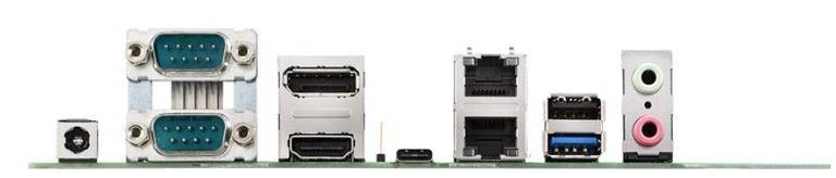

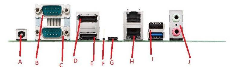

Rear I/O​
RTENOTITLE
PositionDescriptionName
DCINDC JackA
CN15AUART Port 0B
CN15BUART Port 2C
CN1ADP PortD
CN1BHDMI PortE
CN33Type C Controller Programming Header (Reserved Only)F
CN34USB Type CG
CN8GbE Ethernet Connector PortH
CN3USB Port 1/ 2I
Audio1MIC Input/ Audio OutputJ

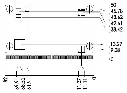

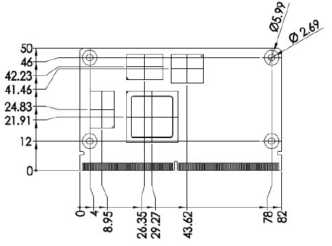

**机械尺寸 (**Mechanical Characteristics)​
  • Dimensions: SMARC form factor size: (D x W) 82 x 50 mm/ 3.22 x 1.9 in
  • Height on Top: Under 3.0 mm base on SPEC definition (without heat sink)
  • Height on Bottom: Under 1.3 mm base on SPEC definition
RTENOTITLE
RTENOTITLE
