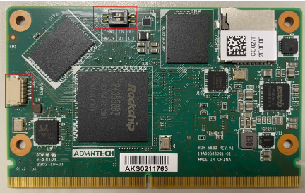

Debug
| Position | Description |
| DEBUG | DEBUG Port |

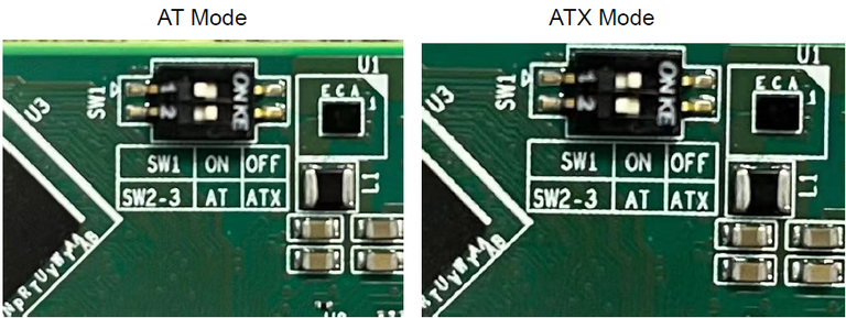

Switch
| SW1 | AT&ATX mode selection |
SW1:AT/ATX Mode Selection
| Setting | Function |
| 1 off 2 on | AT Mode(Default) |
| 1 on 2 off | ATX Mode |

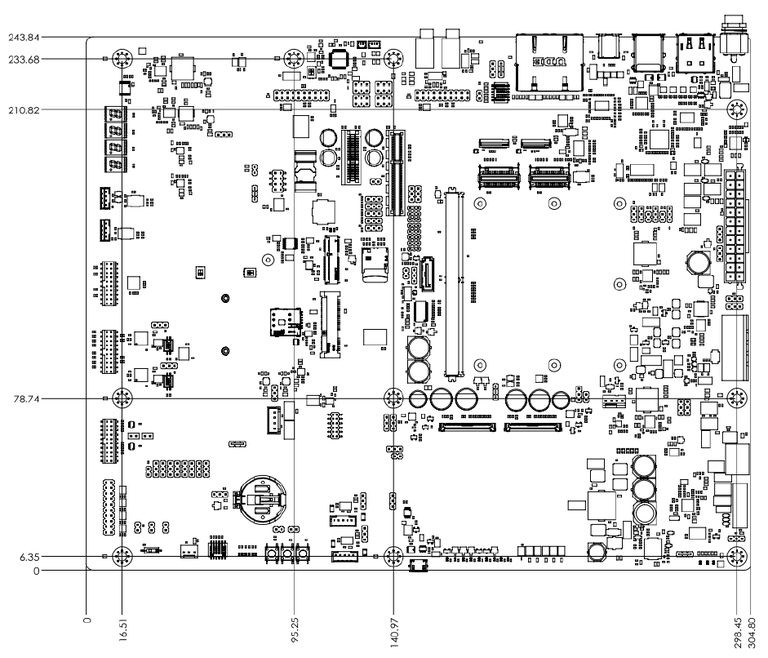

SOM-DB2510 A1 Board Dimension Layout
The figures below indicate the main chips on SOM-DB2510 Development Board for SMARC 2.1.

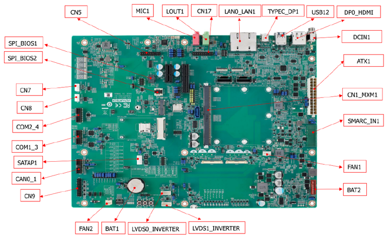

SOM-DB2510 Connectors and Jumper Settings
Connector Locations
Switch Locations
I/O Connctor Locations
Button Locations
LED Locations
| Label | Function | Label | Function |
| ATX1 | ATX Connector | FAN1 | Smart Fan Connector |
| SMARC_IN1 | Wide Range Input Power Connector (3V~5.25V) | FAN2 | System Fan Connector |
| DCIN1 | DCIN connector | CAN0_1 | CAN Bus Connector |
| DP0_HDMI | DP & HDMI Connector | USB0 | USB OTG Connector |
| USB12 | USB 2.0 port1~2 & USB 3.0 port0 Connector | COM1_3 | COM Port Port1,3 Connector |
| TYPEC_DP1 | Type-C Connector | COM2_4 | COM Port Port2,4 Connector |
| LAN0_LAN1 | LAN0 & LAN1 Connector | CN8 | I2C connector for I2C_PM |
| LOUT1 | Line Out Connector | CN7 | I2C Connector for I2C_GP |
| MIC1 | MIC1 Connector | CN10 | eSPI Pin Header |
| CN1_MXM1 | SMARC Connector | SATAP1 | SATA Power Connector |
| PCIEA-X4 | PCIe x4 Connector | CSI0_B2B | MIPI B2B Connector for 2M Camera |
| SATA1 | SATA Port0 Connector | CSI1_B2B | MIPI B2B Connector for 8M & 13M Camera |
| PCIED-X1 | PCIe x1 Connector | SPI_BIOS1 | Carrier Board BIOS Socket (SOIC) |
| M2 | M.2 Key-E Connector | BAT1 | Coin battery holder |
| MPCIE_C | Mini PCIe Connector | BAT2 | Smart battery Connector |
| SIM | SIM card Connector | LINEOUT_1 | I2S Headphone Connector |
| LVDS1 | LVDS1 Connector | MIC_1 | I2S MIC In Connector |
| LVDS0 | LVDS0 Connector | CSI1_FPC | MIPI FPC Connector for 8M & 13M Camera |
| LVDS1_INVERTER | LVDS1 Invertor Connector | CSI0_FPC | MIPI FPC Connector for 2M Camera |
| LVDS0_INVERTER | LVDS0 Invertor Connector | CN5 | I2S2 Connector |
| SPI_BIOS2 | Carrier Board BIOS Socket (QFN) | CN17 | I2S0 Connector |
| SD | SD Card Connector |

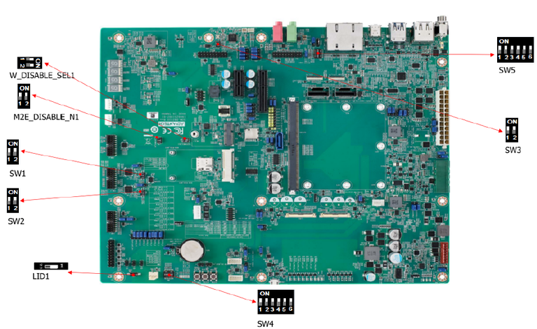

Switch Settings
- SW4 (Boot Select/Force Recovery/Test Switches)
- LID1 (LID Button Enable/Disable Switches)
- SW5 (LAN CONN LED Pull High Switches)
- SW1(COM0 Settings)
- SW2(COM2 Settings)
- SW3(I2S Clock Settings)
- M2E_DISABLE_N1(M.2 Wireless Disable Switch)

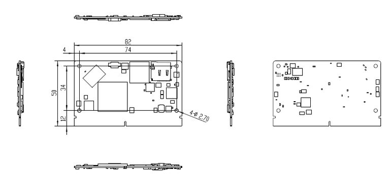

ROM-5880 机械尺寸(Mechanical Characteristics)
- Dimension: SMARC form factor size: (D x W) 82 x 50 mm/3.22 x 1.9 in
- Height on top: Under 3.0 mm
- Height on bottom: Under 2.0 mm
