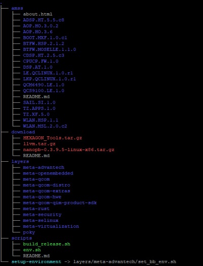

You can check the download BSP as the following.
Get and Unzip the Downloads Files (Must to do)
Yocto downloads file:[ downloads.qcs6490.le.1.1.r00041.0.tar.gz ]
The size of downloads.qcs6490.le.1.1.r00041.0.tar.gz is 32064460216byte (31,312,950 KB)
The md5sum of downloads.qcs6490.le.1.1.r00041.0.tar.gz is 02a2d44d728cd8cabf4a9c25752f0606
You need to get the PASSWORD by contacting the PM or AE of AOM-2721.
$ cd /home/adv/BSP
$ openssl des3 -d -k ${PASSWORD} -salt -pbkdf2 -in downloads.qcs6490.le.1.1.r00041.0.tar.gz -out downloads.qcs6490.le.1.1.r00041.0.decrypt.tar.gz
$ tar -zxvf downloads.qcs6490.le.1.1.r00041.0.decrypt.tar.gz

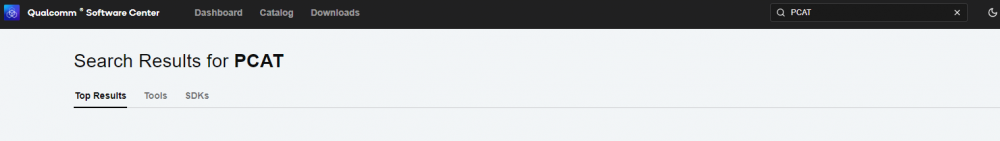

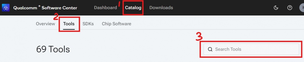

2. Open the Qualcomm Software Center
Login in your Qualcomm ID and Click "Catalog -> Tools -> Search Tools"

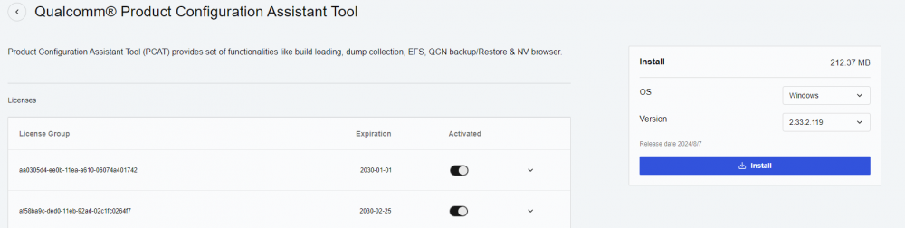

3. Search "PCAT" in the search bar
RTENOTITLE
4. Click Qualcomm® Product Configuration Assistant Tool
5. Select Qualcomm® Product Configuration Assistant Tool version
Version: 2.33.2.119 or 2.40.2.83
RTENOTITLE
6. Install Qualcomm® Product Configuration Assistant Tool

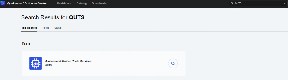

7. Search "QUTS" in the search bar
RTENOTITLE

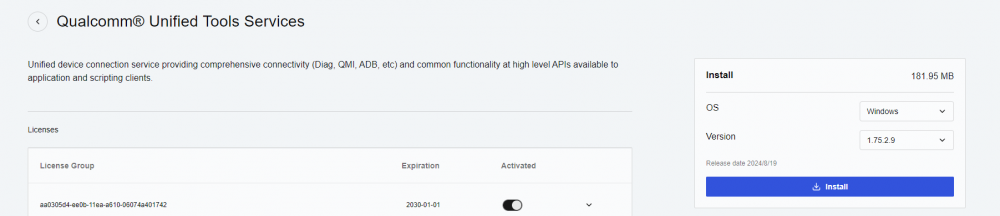

8. Click the  Qualcomm® Unified Tools Services
9. Select Qualcomm® Unified Tools Services version
Version : 1.75.2.9 or 1.82.2.7
10. Install Qualcomm® Unified Tools Services

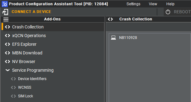

2. After completing the installation of PCAT and QUTS, you will find the new applications in your Windows system. To begin, open PCAT.
RTENOTITLE

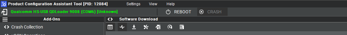

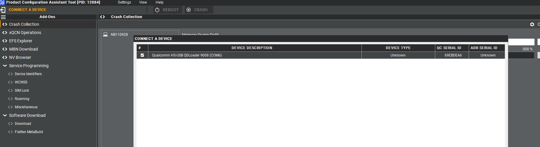

3. Open " PCATApp" Tool
4. Click " Connect A Device"
RTENOTITLE

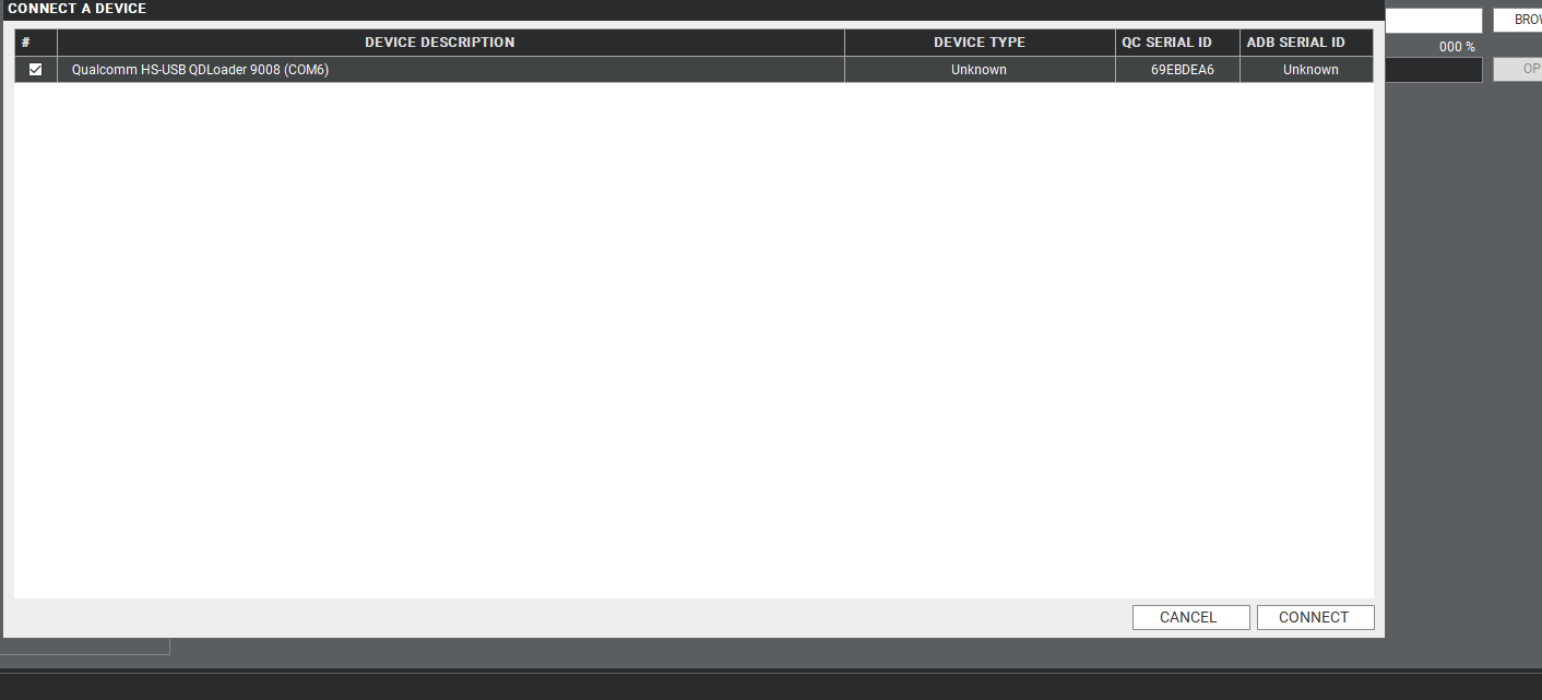

5. Select  "Qualcomm HS-USB QDLoader 9008 (COM6)
RTENOTITLE
6. Click " Connect "  device
RTENOTITLE
7. When you connected successfully , it will show  "green word" - Qualcomm HS-USB QDLoader 9008 (COM 6)
RTENOTITLE

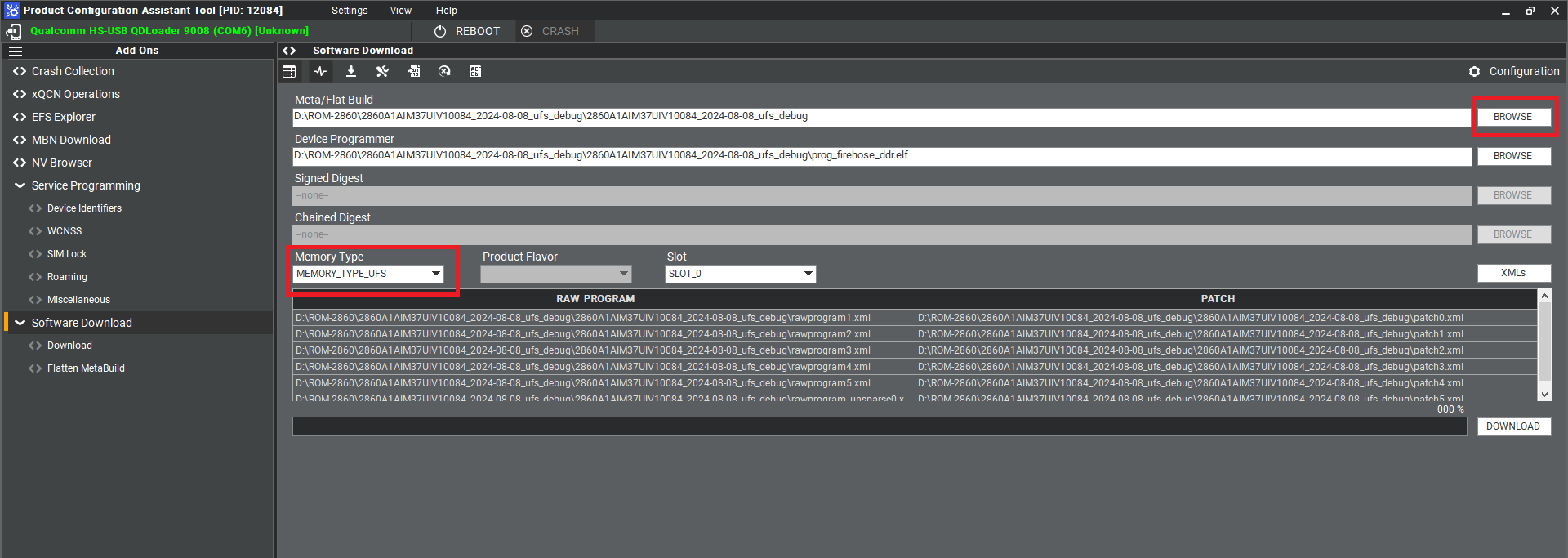

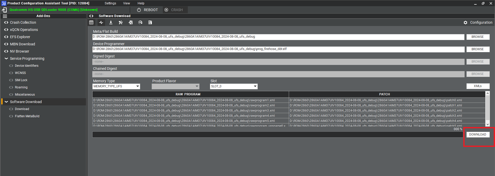

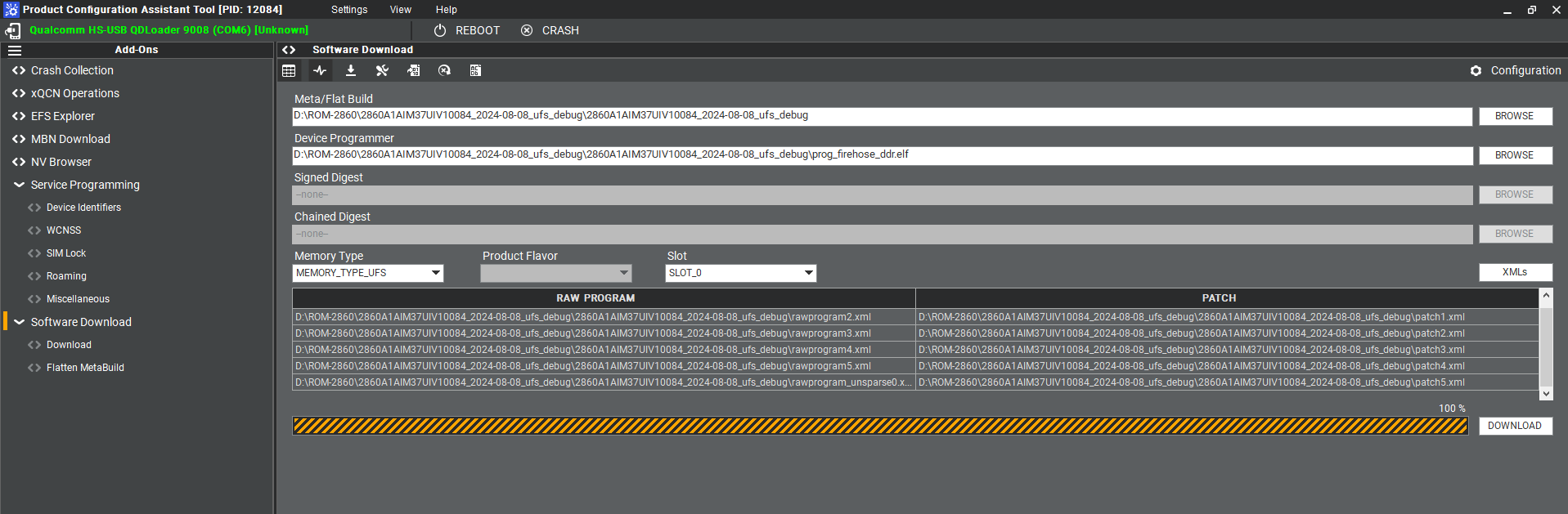

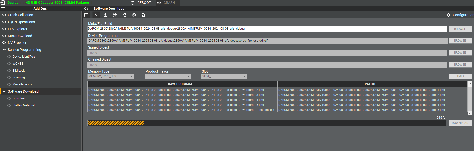

8. Select UFS Folder in PCAT Tool , the Tool will help load Files automatically and Select "MEMORY_TYPE_UFS"
9. Click " Download"
10. UFS Download Status
RTENOTITLE11. UFS Donwload compeleted
RTENOTITLE

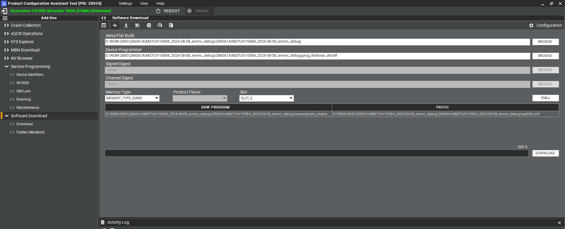

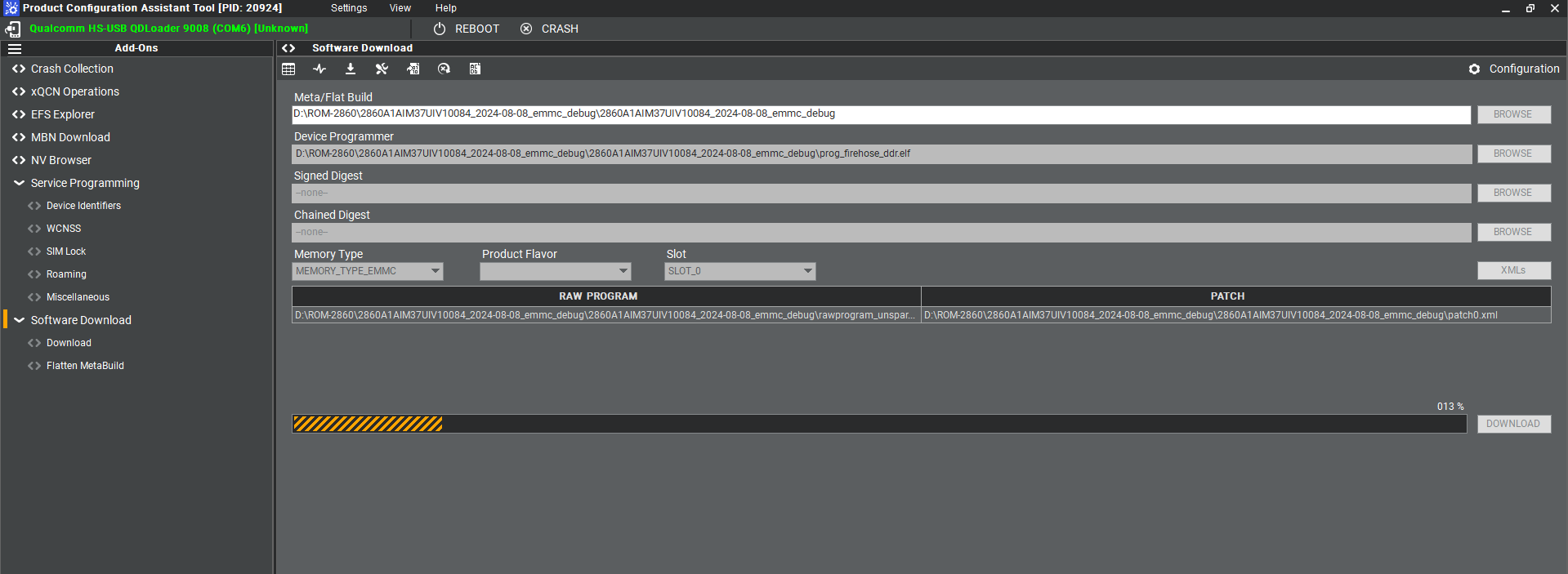

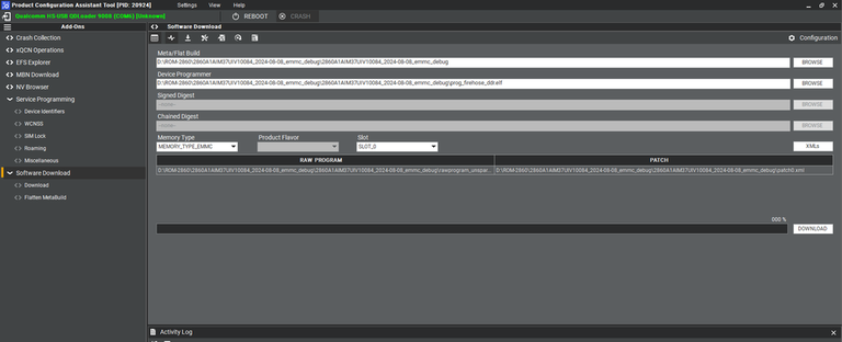

6. Select eMMC Folder.

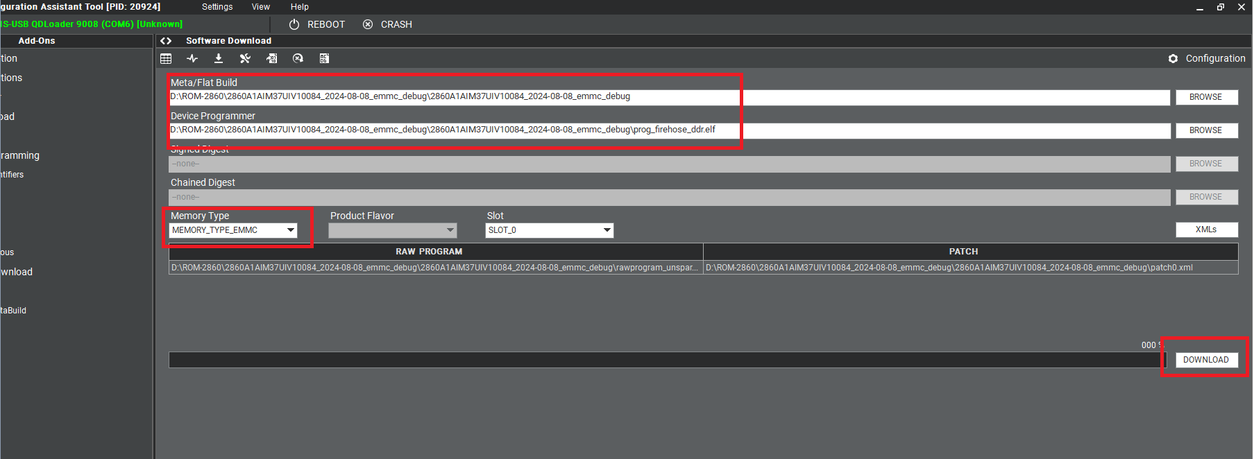

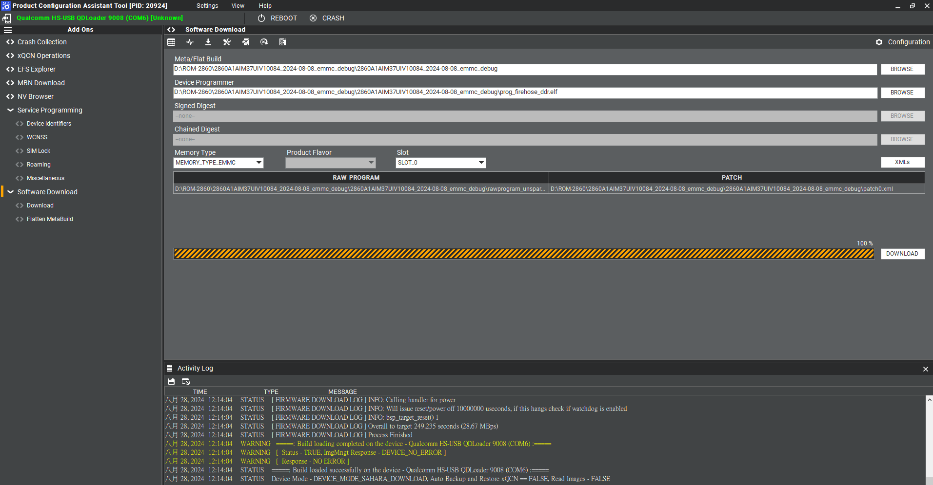

RTENOTITLE7. Make sure the setting ,then press " Download " button.
RTENOTITLE
8. eMMC downlaoad status
RTENOTITLE
'*9. eMMC D'*onwload compeleted
RTENOTITLE

READ64 image: 13 offset: 0x0 length: 0x40
READ64 image: 13 offset: 0x40 length: 0x3f0
READ64 image: 13 offset: 0x1000 length: 0x1000
READ64 image: 13 offset: 0x2000 length: 0x260
READ64 image: 13 offset: 0x3000 length: 0x1000
READ64 image: 13 offset: 0x4000 length: 0x1000
Update Primary Header with CRC of Primary Header.
LOG: INFO: Calling handler for patch
Zero Out Header CRC in Backup Header.
Update Backup Header with CRC of Backup Header.
LOG: INFO: Calling handler for setbootablestoragedrive
LOG: INFO: Using scheme of value= 1
partition 1 is now bootable
LOG: INFO: Calling handler for power
LOG: INFO: Will issue reset/power off 100 useconds, if this hangs check if watchdog is enabled
LOG: INFO: bsp_target_reset() 1
If you see the "partition 1 is now bootable" in your terminal window, the flash is successful.
