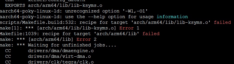

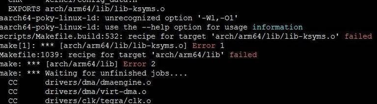

When you get error like below
RTENOTITLE run command then rebuild
 unset LDFLAGS
The kernel image file, Image, is located in the directory "./arch/arm64/boot/". Start building kernel modules
