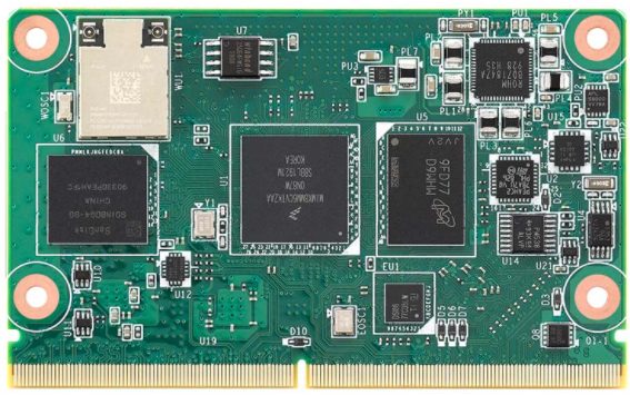

  • NXP i.MX 8M Mini processor with up to 4 Arm Cortex A53 cores
  • 1 x Arm Cortex-M4 core
  • Onboard LPDDR4 memory and eMMC
  • 1 x 4 lane MIPI-CSI,1 x Dual channel LVDS or 1 x Display Port
  • 4 x USB2.0, 1 x USB 2.0 OTG, 4 x UART, 4 x I2C, 12 x GPIO, 1 x PCIe2.0, 1x Gigabit LAN
  • Support OpenGL ES 2.0/1.1 by processors accelerators
  • Low power consumption design
  • Support Linux and Android BSP

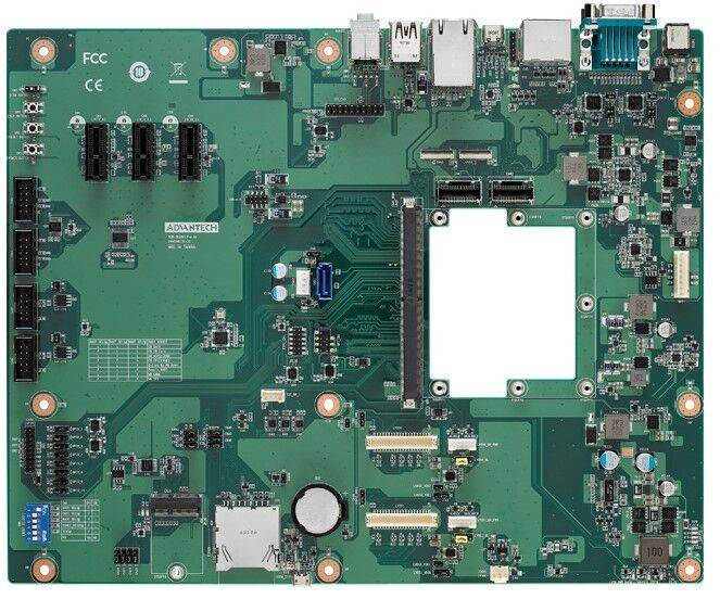

ROM-5721 接口布局圖 Board Dimension Layout​
ROM-DB5901 接口布局圖 Board Dimension Layout​

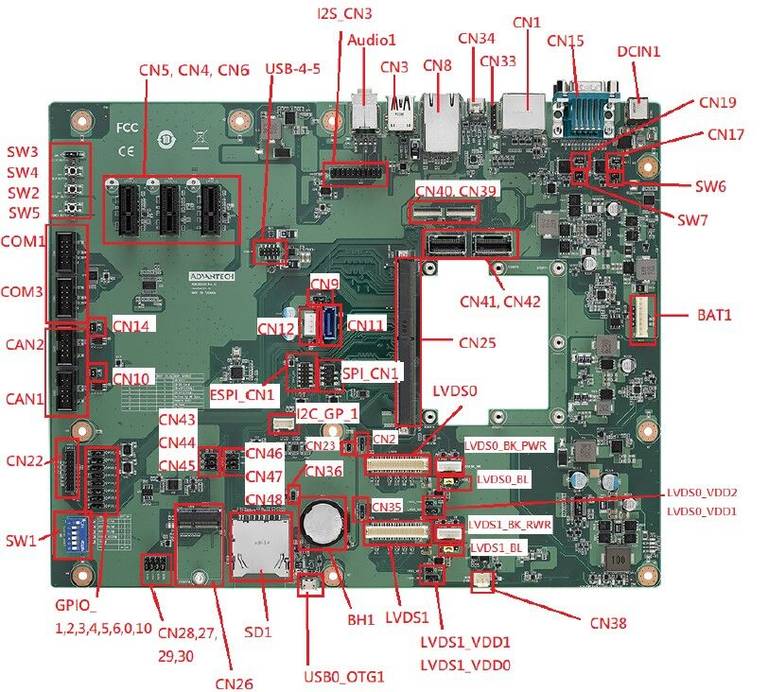

Internal I/O​
PositionDescriptionConnector Type
BAT1PIN Header for BatteryWAFER 8P 2.54mm 180D(M) DIP A2543WV2-8P
BH1RTC Battery HolderBATTERY HOLDER 24.923.48.9 CR2032 BH800.4GG
CAN1CANBus Port 1BOX HEADER 5x2P 2.54mm 180D(M) DIP 23N6960-10S10
CAN2CANBus Port 2BOX HEADER 5x2P 2.54mm 180D(M) DIP 23N6960-10S10
COM1COM Port 1BOX HEADER 5x2P 2.54mm 180D(M) DIP 23N6960-10S10
COM3COM Port 3 (Debug Port)BOX HEADER 5x2P 2.54mm 180D(M) DIP 23N6960-10S10
CN4PCIex1 Connector 1PCIEXPRESS 36P 180D(F) DIP 2EG01817-D2D-DF
CN5PCIex1 Connector 2PCIEXPRESS 36P 180D(F) DIP 2EG01817-D2D-DF
CN6PCIex1 Connector 3PCIEXPRESS 36P 180D(F) DIP 2EG01817-D2D-DF
CN11SATA ConnectorSerial ATA 7P 1.27mm 180D(M) DIP WATM-07DBN4A3B8
CN12SATA Power ConnectorWAFER 4P 2.5mm 180D(M) DIP 24W1161-04S10-01T
CN22GPIOx8 setsPIN HEADER 10x2P 2.0mm 180D(M) DIP 21N22050
CN25MXM 3.0 ConnectorMXM Conn. 314P 90D(F) SMD AS0B821-S78B-7H
CN26M.2 Key E SlotsNGFF 75P 0.5mm 90D(F) H=4.2mm SMD AS0BC21-S40BE
CN38FAN (Reserved)WTB Con. 3P 2.54mm 180D(M) DIP A2543WV0-3P-6T-5e
CN39MIPI-CSI1 (FPC, 4-LaneFPC 39P, 0.6mm, H0.9mm
CN40MIPI-CSI0 (FPC, 2-Lane)FPC 39P, 0.6mm, H0.9mm
CN41MIPI-CSI0 (Mini-SAS, 2-Lane)Mini SAS 36P/0.8mm/(M)/LCP/VA/G15u/ S/BK/W
CN42MIPI-CSI1 (Mini-SAS, 4-Lane)Mini SAS 36P/0.8mm/(M)/LCP/VA/G15u/ S/BK/W
ESPI_CN1ESPIPIN HEADER 6x2P 2.0mm180D(M) SMD 21N22050-12M00B
I2C_GP_1I2C Pin HeaderWAFER BOX 4P 2.00mm 180D(M) DIP 721-81-04TW00
I2C_CN3Audio Codec BoardPIN HEADER 2x10P 2.54mm 180D(M) DIP 21N22564
LVDS0LVDS0Wafer 2x20P/1.25mm/(M)/NY9T/VA/GFL/ S/WH/W
LVDS_BK_PWRLVDS0 Back LightWAFER BOX 5P 2.0mm 180D(M) DIP A2001WV2-5P
LVDS1LVDS1Wafer 2x20P/1.25mm/(M)/NY9T/VA/GFL/ S/WH/W
LVDS1_BK_PWRLVDS1 Back LightWAFER BOX 5P 2.0mm 180D(M) DIP A2001WV2-5P
SD1SD Card SlotSD CARD 9P 90D(F) SMD WK2192CS3D- 7H
SPI_CN1SPI Pin HeaderPIN HEADER 4x2P 2.54mm 180D(M) SMD 21N22564
SW2Reset ButtonTACT SW STS-091 SMD 4P H=3.8mm
SW4SLP ButtonTACT SW STS-091 SMD 4P H=3.8mm
SW5Power ButtonTACT SW STS-091 SMD 4P H=3.8mm
USB0_OTG1USB OTGMicro USB 5P/0.65mm/(F)/NY9T/GFL/ RA/S/BK/B
USB-4-5USB Port 4, Port 5PIN HEADER 2x5P 2.0mm 180D(M) SMD 21N22050

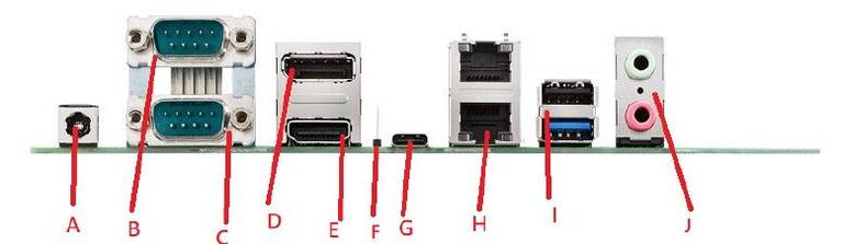

Rear I/O​
PositionDescriptionName
DCINDC JackA
CN15AUART Port 0B
CN15BUART Port 2C
CN1ADP PortD
CN1BHDMI PortE
CN33Type C Controller Programming Header (Reserved Only)F
CN34USB Type CG
CN8GbE Ethernet Connector PortH
CN3USB Port 1/ 2I
Audio1MIC Input/ Audio OutputJ

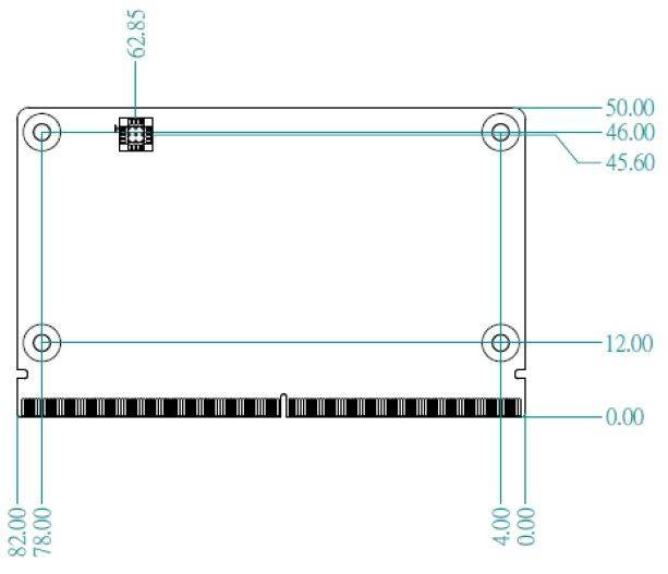

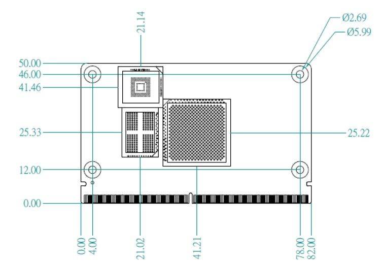

机械尺寸  ( Mechanical Characteristics)​
ROM-5721
