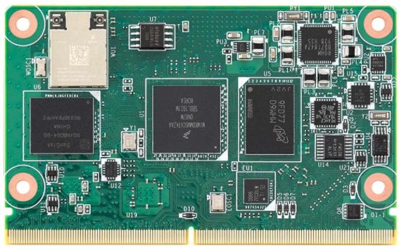

接口布局和尺寸(Layout and Sizes)​

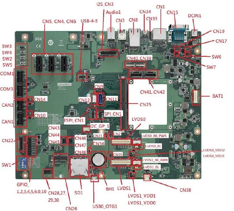

ROM-5721 接口布局圖 Board Dimension Layout​

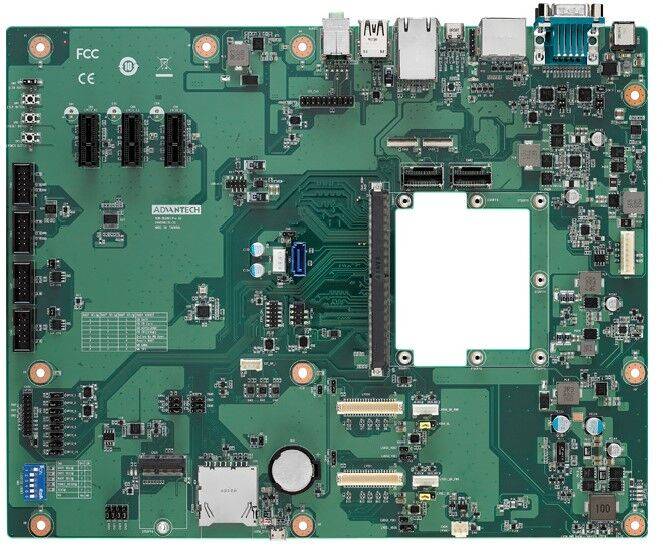

ROM-5721 Board Layout
ROM-5721 Carrier Board
ROM-DB5901 IO
主板内置插针式引脚排序方式 (Pin Header defination)​
Internal I/O​
ROM-DB5901 IO2
PositionDescriptionConnector Type
BAT1PIN Header for BatteryWAFER 8P 2.54mm 180D(M) DIP A2543WV2-8P
BH1RTC Battery HolderBATTERY HOLDER 24.923.48.9 CR2032 BH800.4GG
CAN1CANBus Port 1BOX HEADER 5x2P 2.54mm 180D(M) DIP 23N6960-10S10
CAN2CANBus Port 2BOX HEADER 5x2P 2.54mm 180D(M) DIP 23N6960-10S10
COM1COM Port 1BOX HEADER 5x2P 2.54mm 180D(M) DIP 23N6960-10S10
COM3COM Port 3 (Debug Port)BOX HEADER 5x2P 2.54mm 180D(M) DIP 23N6960-10S10
CN4PCIex1 Connector 1PCIEXPRESS 36P 180D(F) DIP 2EG01817-D2D-DF
CN5PCIex1 Connector 2PCIEXPRESS 36P 180D(F) DIP 2EG01817-D2D-DF
CN6PCIex1 Connector 3PCIEXPRESS 36P 180D(F) DIP 2EG01817-D2D-DF
CN11SATA ConnectorSerial ATA 7P 1.27mm 180D(M) DIP WATM-07DBN4A3B8
CN12SATA Power ConnectorWAFER 4P 2.5mm 180D(M) DIP 24W1161-04S10-01T
CN22GPIOx8 setsPIN HEADER 10x2P 2.0mm 180D(M) DIP 21N22050
CN25MXM 3.0 ConnectorMXM Conn. 314P 90D(F) SMD AS0B821-S78B-7H
CN26M.2 Key E SlotsNGFF 75P 0.5mm 90D(F) H=4.2mm SMD AS0BC21-S40BE
CN38FAN (Reserved)WTB Con. 3P 2.54mm 180D(M) DIP A2543WV0-3P-6T-5e
CN39MIPI-CSI1 (FPC, 4-Lane)FPC 39P, 0.6mm, H0.9mm
CN40MIPI-CSI0 (FPC, 2-Lane)FPC 39P, 0.6mm, H0.9mm
CN41MIPI-CSI0 (Mini-SAS, 2-Lane)Mini SAS 36P/0.8mm/(M)/LCP/VA/G15u/S/BK/W
CN42MIPI-CSI1 (Mini-SAS, 4-Lane)Mini SAS 36P/0.8mm/(M)/LCP/VA/G15u/S/BK/W
ESPI_CN1ESPIPIN HEADER 6x2P 2.0mm 180D(M) SMD 21N22050-12M00B
I2C_GP_1I2C Pin HeaderWAFER BOX 4P 2.00mm 180D(M) DIP 721-81-04TW00
I2C_CN3Audio Codec BoardPIN HEADER 2x10P 2.54mm 180D(M) DIP 21N22564
LVDS0LVDS0Wafer 2x20P/1.25mm/(M)/NY9T/VA/GFL/S/WH/W
LVDS_BK_PWRLVDS0 Back LightWAFER BOX 5P 2.0mm 180D(M) DIP A2001WV2-5P
LVDS1LVDS1Wafer 2x20P/1.25mm/(M)/NY9T/VA/GFL/S/WH/W
LVDS1_BK_PWRLVDS1 Back LightWAFER BOX 5P 2.0mm 180D(M) DIP A2001WV2-5P
SD1SD Card SlotSD CARD 9P 90D(F) SMD WK2192CS3D-7H
SPI_CN1SPI Pin HeaderPIN HEADER 4x2P 2.54mm 180D(M) SMD 21N22564
SW2Reset ButtonTACT SW STS-091 SMD 4P H=3.8mm
SW4SLP ButtonTACT SW STS-091 SMD 4P H=3.8mm
SW5Power ButtonTACT SW STS-091 SMD 4P H=3.8mm
USB0_OTG1USB OTGMicro USB 5P/0.65mm/(F)/NY9T/GFL/RA/S/BK/B
USB-4-5USB Port 4, Port 5PIN HEADER 2x5P 2.0mm 180D(M) SMD 21N22050

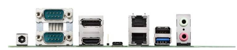

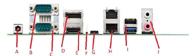

Rear I/O​
ROM-DB5901 Rear IO
PositionDescriptionName
DCINDC JackA
CN15AUART Port 0B
CN15BUART Port 2C
CN1ADP PortD
CN1BHDMI PortE
CN33Type C Controller Programming Header (Reserved Only)F
CN34USB Type CG
CN8GbE Ethernet Connector PortH
CN3USB Port 1/2I
Audio1MIC Input/Audio OutputJ

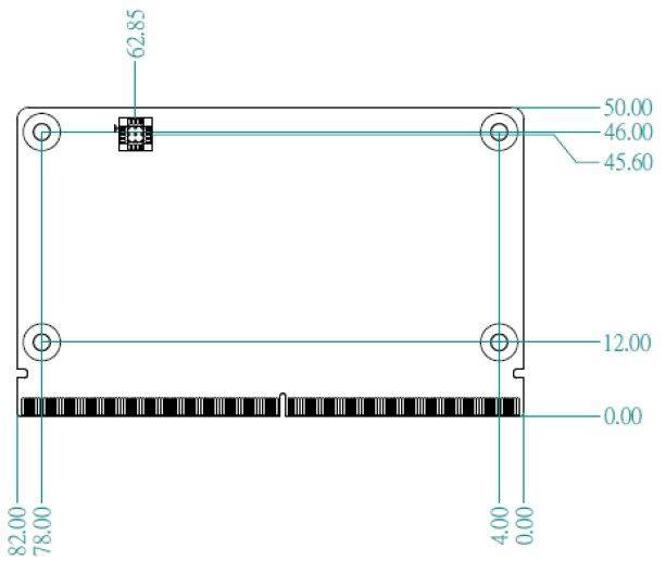

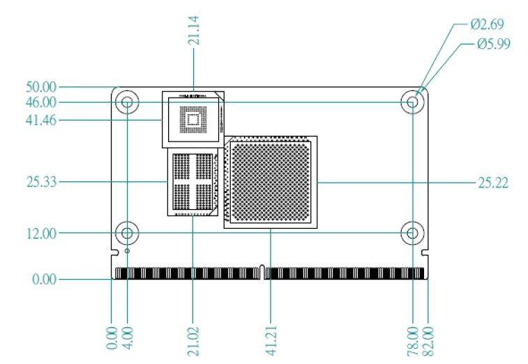

机械尺寸 (Mechanical Characteristics)​
ROM-5721 Mechanical Specifications 1
ROM-5721 Mechanical Specifications 2

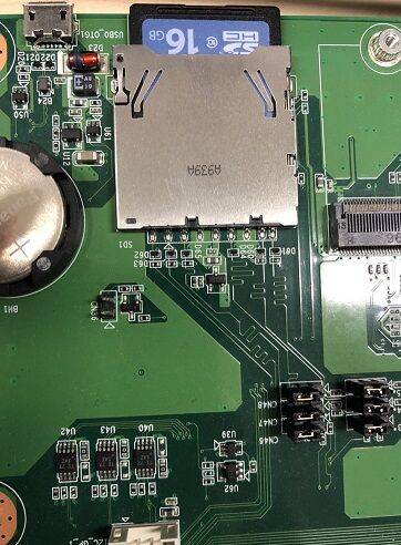

Step2: 將可開機的SD 卡插入底板SD卡卡槽 (Plug the SD card into Carrier board's SD card slot)
SD card slot

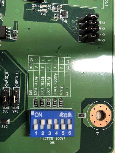

Step4: 確認開機選擇指撥開關 (Check the boot switch)
SD 卡開機模式 (SD boot mode):
SD boot switch

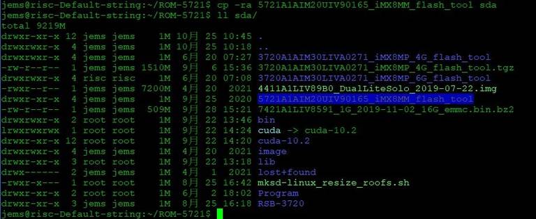

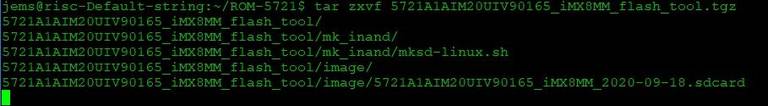

Step4: 解壓縮flash tools 檔案,並複製到U盤中 (Unzip the flash tools file, then copy to USB Disk)
解壓縮 (Unzip the file)
Unzip flash tools
複製檔案到U盤中 (Copy the flash file to USB Disk)
  1. 插入U盤到你的Ubuntu 電腦上 (Plug the USB Disk into your Linux PC)
  2. 檢視U盤在Ubuntu 系統代號 (Check the USB Disk's symbol in Ubuntu System)
Check USB disk symbol

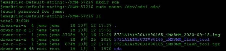

  1. 掛載U盤在Ubuntu 系統中 (Mount the USB Disk in Ubuntu System)
Mount USB disk
  1. 複製檔案到U盤 (Copy the file to USB disk)
Copy file to USB disk

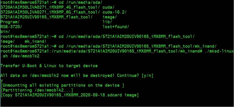

  1. 將U盤連接到ROM-5721系統, 進入flash tool下的mk_inand資料夾, 執行指令 ./mksd-linux.sh /dev/mmcblk2 燒錄image到eMMC
ROM-5721
SD card/dev/mmcblk1
eMMC/dev/mmcblk2
Flash eMMC
  1. 切換開機switch 1:on 2,3,4,5,6:off 來設定成從eMMC開機 (Change boot switch to "1:on 2,3,4,5,6:off" to boot from eMMC. Reboot system).

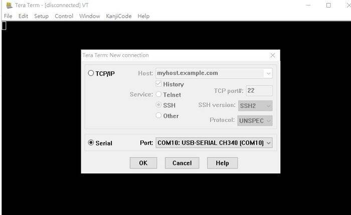

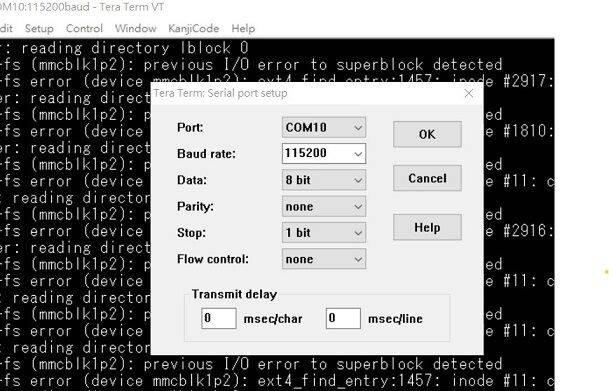

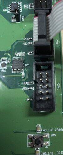

Debug 串口調試 (Debug port Setting)​
以 Tera Term 为例介绍如何使用串口调试功能
Baud Rate波特率:115200
Data 数据位:8
Parity 奇偶校验:无
Stop 停止位:1
Flow Control流控:无
Tera Term Tool
Tera Term setup 1
Tera Term setup 2

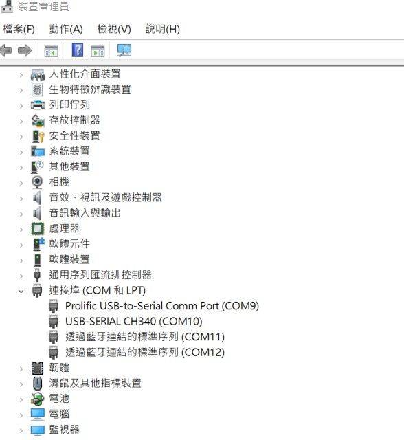

Check the Serial port in Device Manager (查看PC端的串口号):
if you can not identify the Serial device, please check your serial driver.
COM port in device manager
Debug port connection (串口連接)

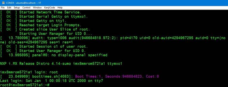

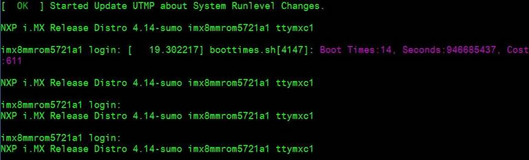

Log into Terminal Tool (进入串口调试终端):
Log into terminal

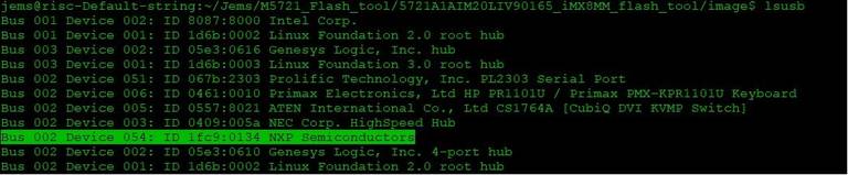

Download uuu tool from (ADV v20200619 · ADVANTECH-Corp/uuu · GitHub) or in the folder.
The "imx-boot-imx8mmrom5721a1-sd.bin-flash_evk" file be included in 5721A1AIM20LIV90XXX_iMX8MM_misc.tgz. XXX is the version.
Connect USB cable to USB OTG port.
Change boot switch to "4:on 1,2,3,5,6:off" to boot from force recovery mode.
UUU recovery boot switch
Type command below to flash eMMC:
UUU flash eMMC command

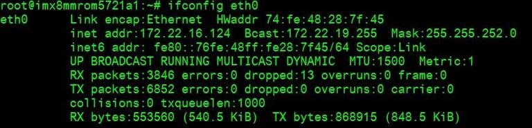

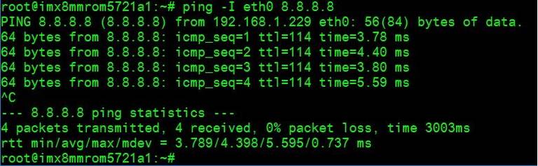

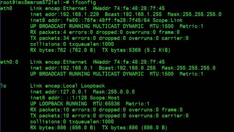

乙太網路使用方法(Ethernent Testing Method)​
Command: ifconfig
ifconfig output
Command: ping -I eth1 8.8.8.8 or ping -I eth0 8.8.8.8
Ping test

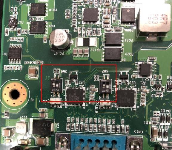

SW7 Setting (SW7設置)
SW7 setting
MODE1  MODE0
0 0 LOOPBACK
0 1 RS232
1 0 RS485
1 1 RS422

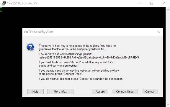

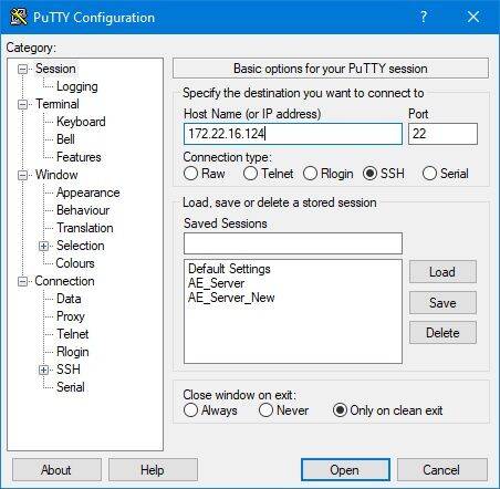

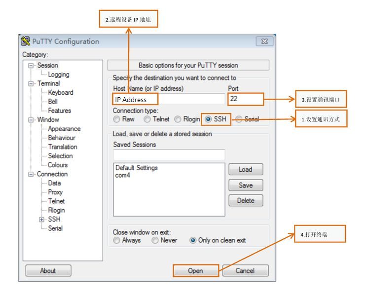

Windows下SSH访问及文件传输​
SSH Remote Log into Device
  • SSH远程登录,以putty选择putty.exe(或者使用Xshell、SecureCRT等类似软件)
  • 需要设置远程设备的IP、通讯端口(默认22)、通讯方式,登录后验证用户名密码
SSH setting detail
SSH login 1
SSH login 2
SSH console

# 64 bytes from 8.8.8.8: icmp_seq=1 ttl=54 time=2.10 ms
# 64 bytes from 8.8.8.8: icmp_seq=2 ttl=54 time=2.10 ms

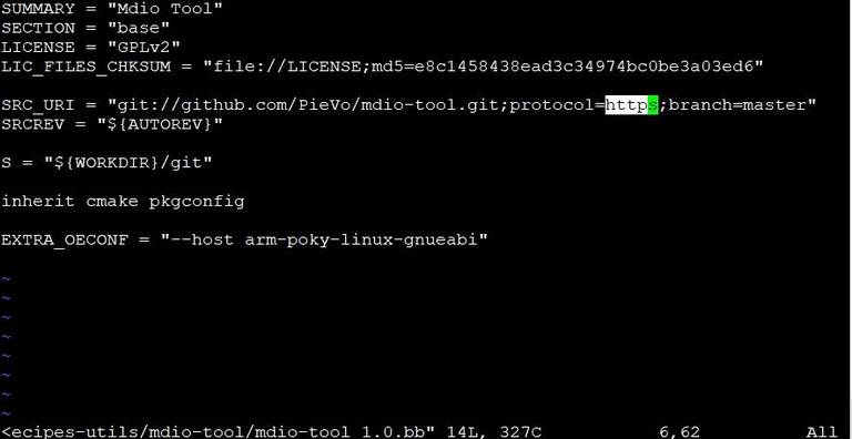

Build error with git protocol​
ERROR: ExpansionError during parsing .../mdio-tool_1.0.bb
fatal: remote error: The unauthenticated git protocol on port 9418 is no longer supported.
Modify mdio-tool_1.0.bb:
SRC_URI = "git://github.com/PieVo/mdio-tool.git;protocol=https;branch=master"
