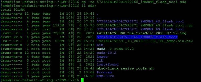

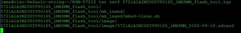

Step4: 解壓縮flash tools 檔案,並複製到U盤中(Unzip the flash tools file , then copy to USB Disk)
解壓縮(Unzip the file )

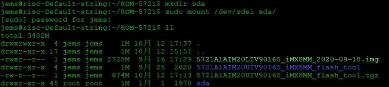

複製檔案到U盤中 (Copy the flash file to USB Disk)

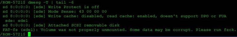

  1. 插入U盤到你的Ubuntu 電腦上 (Plug the USB Disk into you Linux PC
  2. 檢視U盤在Ubuntu 系統代號 (Check the USB Disk's symbol in Ubuntu System)
  3. 掛載U盤在Ubuntu 系統中 (Mount the USB Disk's in Ubuntu System)
  4. 複製檔案到U盤(Copy the file to USB disk)

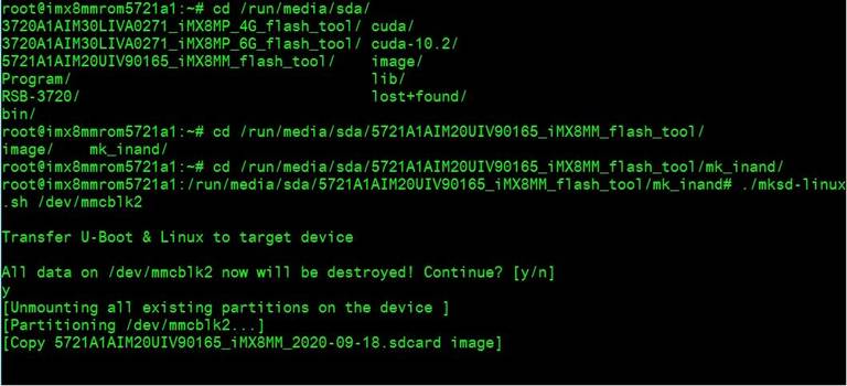

  5. 將U盤連接到ROM-5721系統, 進入flash tool下的mk_inand資料夾, 執行指令./mksd-linux.sh /dev/mmcblk2燒錄image到eMMC (Connect USB Disk to ROM-5721 system, browser to mk_inand folder and execute flash shell script "./mksd-linux.sh /dev/mmcblk2"
ROM-5721
SD card/dev/mmcblk1
eMMC/dev/mmcblk2

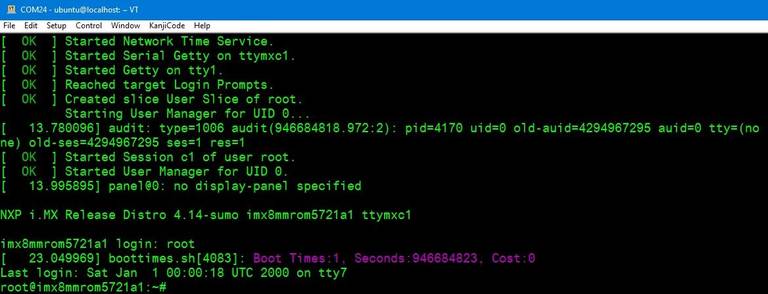

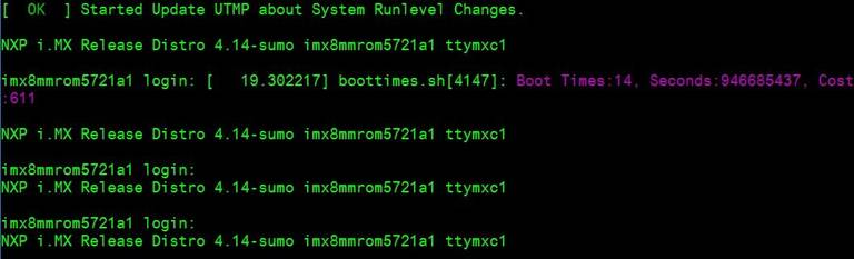

Debug 串口調試 (Debug port Setting)​
以 Tera Term  为例介绍如何使用串口调试功能
   Baud Rate波特率:115200
Data 数据位:8
Parity 奇偶校验:无
  Stop 停止位:1
Flow Control流控:无
Tera Term Tool
Check the Sriel port in Device Manager (查看PC端的串口号):
if you can not identify the Serial device , please check your serial driver.
Debug port connection (串口連接)
Log into Terminal  Tool (进入串口调试终端):

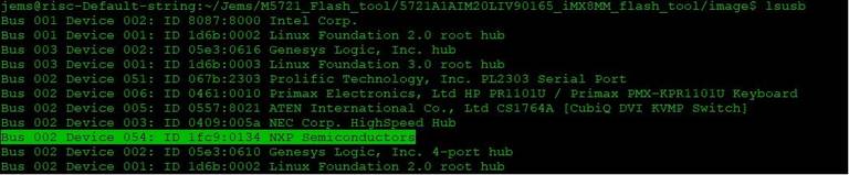

UUU 使用方法(USB Connection (OTG port))​
Download uuu tool from (Release [ ADV v20200619 · ADVANTECH-Corp/uuu · GitHub]) or in the folder.
The “imx-boot-imx8mmrom5721a1-sd.bin-flash_evk” file be included in 5721A1AIM20LIV90XXX_iMX8MM_misc.tgz. XXX is the version.
Connect USB cable to USB OTG port.
Change boot switch to "4:on 1,2,3,5,6:off" to boot from force recovery mode.
Type command below to flash eMMC:

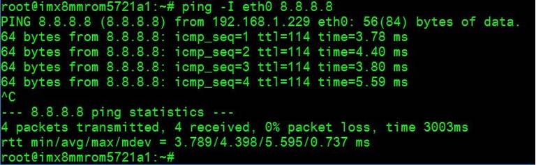

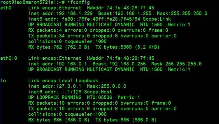

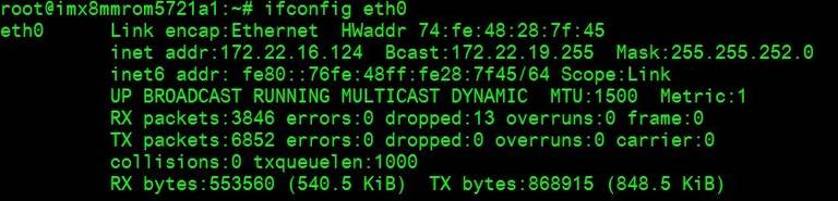

Command : ifconfig
Command: Ping - I eth1 8.8.8.8  or Ping - I eth0 8.8.8.8

查看主板IP位址 ( Chech IP Address ): ​
        Command : ifconfig

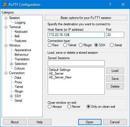

Windows下SSH访问及文件传输​
SSH Remote Log into Device
  • SSH远程登录,以putty选择putty.exe(或者使用Xshell、SecureCRT等类似软件)
  • 需要设置远程设备的IP、通讯端口(默认22)、通讯方式,登录后验证用户名密码

網路Ping測試(Ping Network Testing)​
     ping 8.8.8.8
PING 8.8.8.8 (8.8.8.8) 56(84) bytes of data.
64 bytes from 8.8.8.8: icmp_seq=1 ttl=54 time=2.10 ms
64 bytes from 8.8.8.8: icmp_seq=2 ttl=54 time=2.10 ms

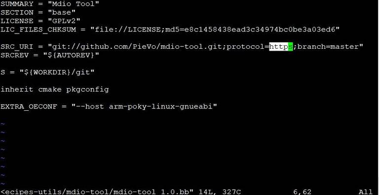

  • Build error with git protocal:
ERROR: ExpansionError during parsing /home/adv/adv-release-bsp/sources/meta-advantech/meta-tools/recipes-utils/mdio-tool/mdio-tool_1.0.bb
fatal: remote error: The unauthenticated git protocol on port 9418 is no longer supported. Please see https://github.blog/2021-09-01-improving-git-protocol-security-github/ for more information.
Modify: "/home/adv/adv-release-bsp/sources/meta-advantech/meta-tools/recipes-utils/mdio-tool/mdio-tool_1.0.bb" file to
SRC_URI = " git://github.com/PieVo/mdio-tool.git;protocol= https ;branch=master"
