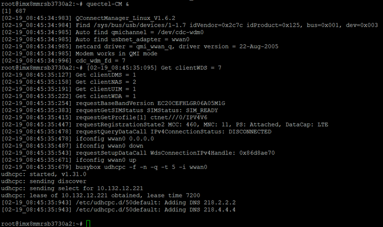

1. Insert SIM card, restart.
# quectel-CM &

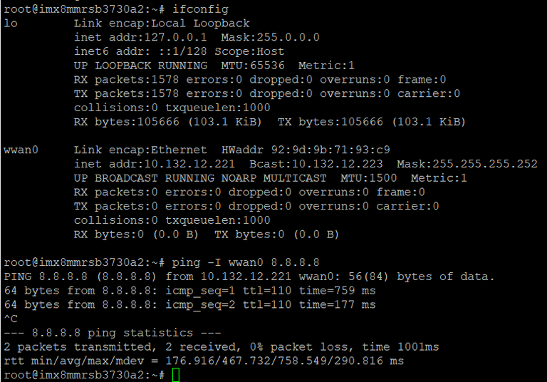

2. Wait for the IP address to appear. Test network.
# ping -I wwan0 8.8.8.8
PING 8.8.8.8 (8.8.8.8) 56(84) bytes of data.
64 bytes from 8.8.8.8: icmp_seq=1 ttl=54 time=2.10 ms
64 bytes from 8.8.8.8: icmp_seq=2 ttl=54 time=2.10 ms
