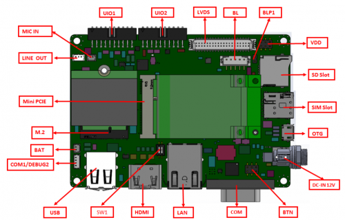

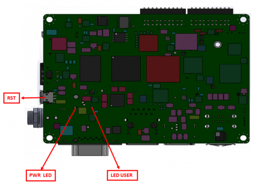

接口布局圖 Board Layout​
RSB-3730 Board Layout
RSB-3730 Board Layout 1

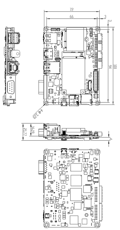

接口尺寸 Board Dimension​
RSB-3730 Board Dimension

Connector List​
ConnectorDescription
COM1/DEBUG2Debug CONN
BATRTC CONN
M.2M.2 CONN
LINE OUTLINE OUT CONN
MIC INMIC IN CONN
UIO1UIO1
UIO2UIO2
LVDSLVDS CONN
SDSD slot
SIMSIM slot
OTGOTG
DCINDC-IN JACK
USB1USB CONN
HDMIHDMI CONN
COMCOM CONN
RSTRST CONN
LEDLED
Mini PCIEMini PCIE CONN
LAN1RJ45 LAN
