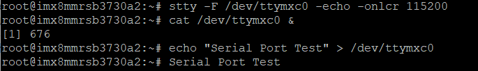

RS232- Loopback Test
# stty -F /dev/ttymxc0 -echo -onlcr 115200
# cat /dev/ttymxc0 &
# echo "Serial Port Test" > /dev/ttymxc0

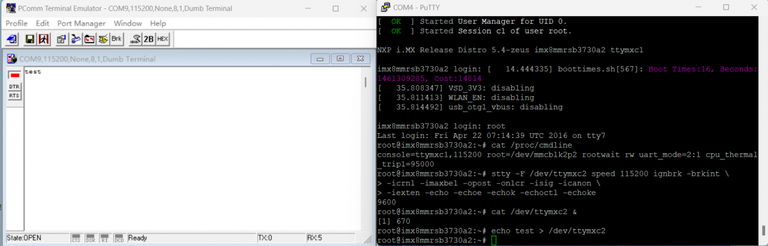

RS-485 Test
Test RS-485 with Adam-4520I. Connect Adam-4520I to PC with DB9 cable.Connect Adam-4520I to COMX DB9.
# stty -F /dev/ttymxc2 speed 115200 ignbrk -brkint \
-icrnl -imaxbel -opost -onlcr -isig -icanon \
-iexten -echo -echoe -echok -echoctl -echoke
# cat /dev/ttymxc2 &
# echo test > /dev/ttymxc2
Receive “test” on PC terminal.
