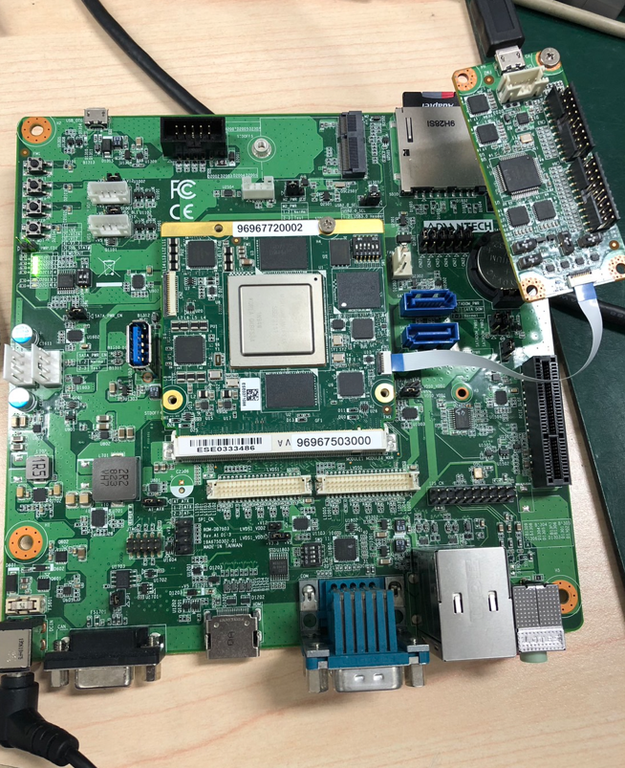

接口布局和尺寸(Layout and Sizes)
ROM-7720 接口布局圖 Board Dimension Layout
ROM-DB7503 接口布局圖 Board Dimension Layout

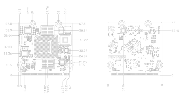

机械尺寸 ( Mechanical Characteristics)
ROM-7720

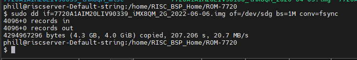

Step0: 檢查SD卡在Linux 環境的代號 (check SD card symbol in Linux system)
Step1: 創造一張可開機的SD 卡 (Create a bootable SD card)

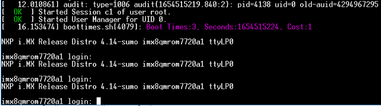

Step 4:打開電源 和 終端機 (Turn on the Power & Terminal)

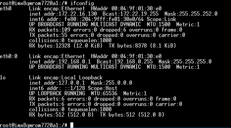

乙太網路使用方法(Ethernent Testing Method)
Command : ifconfig
Command: Ping - I eth1 8.8.8.8 or Ping - I eth0 8.8.8.8

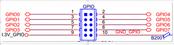

GPIO使用方法(GPIO Operating Method)
| GPIO | command |
| 1/2 | 488/489 |
| 3/4 | 353/354 |
| 5/6 | 298/299 |
| 7/8 | 300/301 |

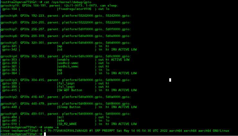

GPIO
$ function test_gpio_pair() {
cd /sys/class/gpio
local GO=$1 GI=$2
echo gpio$GO output to gpio$GI
echo $GI > export; echo $GO > export
echo out > gpio$GO/direction; echo in > gpio$GI/direction
echo 1 > gpio$GO/value; echo "$GO:$(<gpio$GO/value) ==> $GI:$(<gpio$GI/value)"
echo 0 > gpio$GO/value; echo "$GO:$(<gpio$GO/value) ==> $GI:$(<gpio$GI/value)"
echo $GI > unexport; echo $GO > unexport
cd - > /dev/null
上表的GPIO18 對應到下圖的 GPIO07,注意: 並非插槽針腳的編號
| ROM-DB7503-SCA1E w/ ROM-7720 | i.MX8 | pinmux | IMX_GPIO_NR(bank, pin) (480 - (bank * 32) + (pin & 0x1f)) |
| GPIO0 | M40_GPIO0_00 | IMX8QM_M40_GPIO0_00_LSIO_GPIO0_IO08 | 488 |
| GPIO1 | M40_GPIO0_01 | IMX8QM_M40_GPIO0_01_LSIO_GPIO0_IO09 | 489 |
| GPIO2 | FLEXCAN2_RX | IMX8QM_FLEXCAN2_RX_LSIO_GPIO4_IO01 | 353 |
| GPIO3 | FLEXCAN2_TX | IMX8QM_FLEXCAN2_TX_LSIO_GPIO4_IO02 | 354 |
| GPIO4 | ENET1_RGMII_TXC | IMX8QM_ENET1_RGMII_TXC_LSIO_GPIO6_IO10 | 298 |
| GPIO5 | ENET1_RGMII_TX_CTL | IMX8QM_ENET1_RGMII_TX_CTL_LSIO_GPIO6_IO11 | 299 |
| GPIO6 | ENET1_RGMII_TXD0 | IMX8QM_ENET1_RGMII_TXD0_LSIO_GPIO6_IO12 | 300 |
| GPIO7 | ENET1_RGMII_TXD1 | IMX8QM_ENET1_RGMII_TXD1_LSIO_GPIO6_IO13 | 301 |
GPIOCHIP info(Yocto3.0):

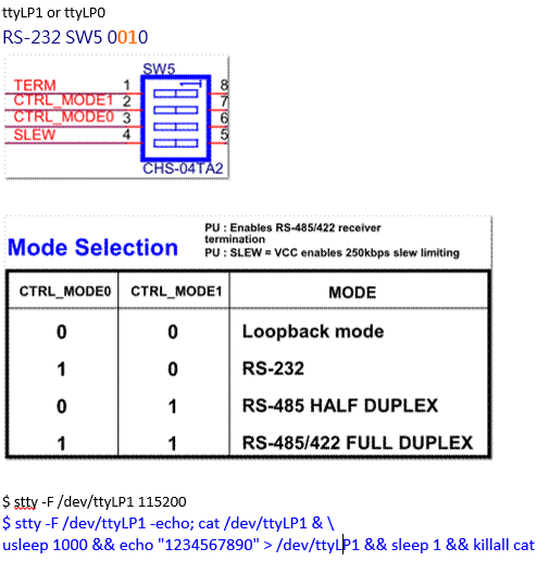

串口使用方法(Serial Port Operating Method)
RS-232 Test

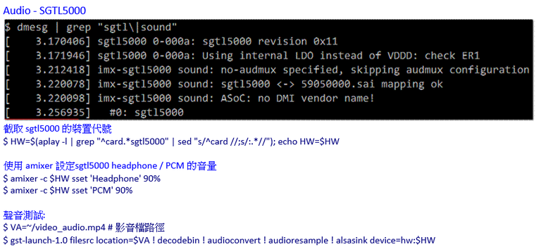

Audio Test:
Audio - SGTL5000
Get sgtl5000 device
$ HW=$(aplay -l | grep "^card.sgtl5000" | sed "s/^card //;s/:.//"); echo HW=$HW
Use amixer ,and set sgtl5000 headphone / PCM volume
$ amixer -c $HW sset 'Headphone' 90%
$ amixer -c $HW sset 'PCM' 90%
Voice Testing:
$ VA=~/video_audio.mp4 # video file
$ gst-launch-1.0 filesrc location=$VA ! decodebin ! audioconvert ! audioresample ! alsasink device=hw:$HW

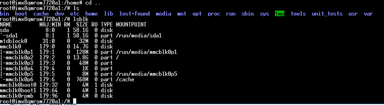

查看内存容量(Check Memory Capacity)
root@imx8qmrom7720a1:/# busybox free -m
total used free shared buffers cached
Mem: 1792540 563488 1229052 17504 18460 139496
-/+ buffers/cache: 405532 1387008
Swap: 0 0 0
查看存储容量(Check Storage Capacity)
root@imx8qmrom7720a1:/# busybox df -h
Filesystem Size Used Available Use% Mounted on
/dev/root 12.8G 2.3G 9.9G 19% /
devtmpfs 394.6M 4.0K 394.6M 0% /dev
tmpfs 875.3M 0 875.3M 0% /dev/shm
tmpfs 875.3M 16.5M 858.8M 2% /run
tmpfs 875.3M 0 875.3M 0% /sys/fs/cgroup
tmpfs 875.3M 4.0K 875.3M 0% /tmp
tmpfs 875.3M 500.0K 874.8M 0% /var/volatile
/dev/mmcblk0p5 7.7M 45.0K 7.3M 1% /run/media/mmcblk0p5
/dev/mmcblk0p1 127.7M 23.9M 103.8M 19% /run/media/mmcblk0p1
/dev/sda1 58.1G 9.5G 48.6G 16% /run/media/sda1
/dev/mmcblk0p6 739.9M 776.0K 685.4M 0% /cache
tmpfs 175.1M 88.0K 175.0M 0% /run/user/0
