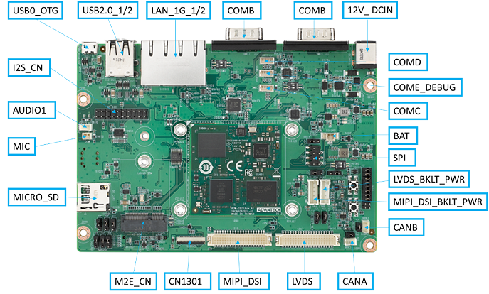

接口布局和尺寸(Layout and Sizes)
ROM-2820 接口布局圖 Board Dimension Layout​

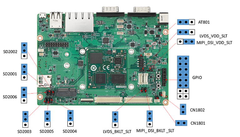

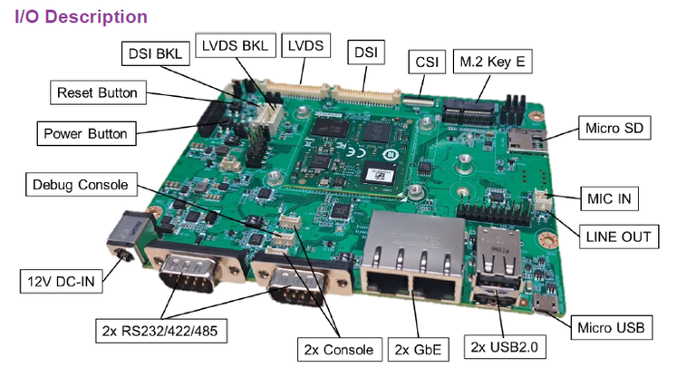

主板内置插针式引脚排序方式 (Pin Header defination)​
Internal I/O, Jummper/Switch List:​
PositionDescription
[AT801]AT/ATX select header
[AUDIO1]Line Out Connector
[BAT601]Battery Connector

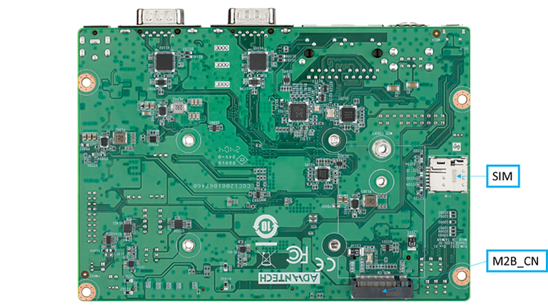

[CN1301]Camera FPC connector
[CN1801]CANA terminal resistor enable jumper
[CN1802]CANB terminal resistor enable jumper
[CANA]CAN Bus Connector
[CANB]CAN Bus Connector
[COMA]RS232/422/485
[COMB]RS232/422/485
[COMC]COM A port wafer
[COMD]COM D port wafer
[COME_DEBUG]Debug console wafer
[CN1601]RJ45 1x2
[DCIN701]12V DCIN connector
[DSI]DSI connector
[DSI_BKLT_PWR]DSI blacklight wafer
[DSI_BKLT_SLT]DSI blacklight power select
[DSI_VDD_SLT]DSI VDD power select
[GPIO]GPIO header
[I2S_CN]Audio expander pin header
[LVDS]LVDS connector
[LVDS_BKLT_PWR]LVDS blacklight wafer
[LVDS_BKLT_SLT]LVDS blacklight power select
[LVDS_VDD_SLT]LVDS VDD power select
[M2B_CN]M2 Key B connector
[M2E_CN]M2 Key E connector
[MIC]MIC Connector
[SD_CARD]Micro SD slot
[SD2001]SDIO device select jumper
[SD2002]SDIO device select jumper
[SD2003]SDIO device select jumper
[SD2005]SDIO device select jumper
[SD2004]SDIO device select jumper
[SD2006]SDIO device select jumper
[SIM]SIM card connector
[SPI]SPI pin header
[SW1001]Boot select switch
[SW1002]Reset button
[SW1003]Power button
[SW1104]COMA UART setting switch
[SW1103]COMB UART setting switch
[USB1201]USB2.0 2x1 Connector
[USB0_OTG1]Micro USB Connector

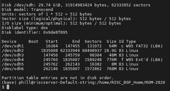

Step0: 檢查SD卡在Linux 環境的代號 (check SD card symbol in Linux system)
RTENOTITLE

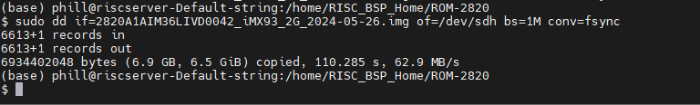

Step1: 創造一張可開機的SD 卡 (Create a bootable SD card)
Command :
sudo dd if=2820A1AIM36LIVD0042_iMX93_2G_2024-05-26.img of=/dev/sdh bs=1M conv=fsync
RTENOTITLE

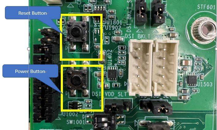

Step 5:  按下Power 開關 (Turn on Power , open terminal , then press the Power Button )
SW1003 : PWR_Button , SW1002: Reset_Button

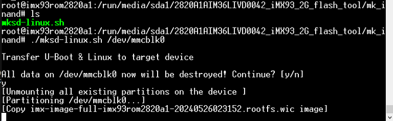

     4. 進入flsah tool下的mk_inand資歷夾, 執行指令./mksd-linux.sh /dev/mmcblk0燒錄image到eMMC(Connect USB Disk to ROM-2820 system, extract the flash tool and browser to mk_inand folder and execute flash shell script "./mksd-linux.sh /dev/mmcblk0"
解壓縮後如果沒有mksd-linux.sh檔案, 可以到以下連結下載並複製到mk_inand資料夾下(If there is no mksd-linux.sh file in mk_inand directory. Please download from the link below and place it in mk_inand directory:
下載 mksd-linux.sh​
ROM-2820Device node
SD card/dev/mmcblk1
eMMC/dev/mmcblk0
RTENOTITLE

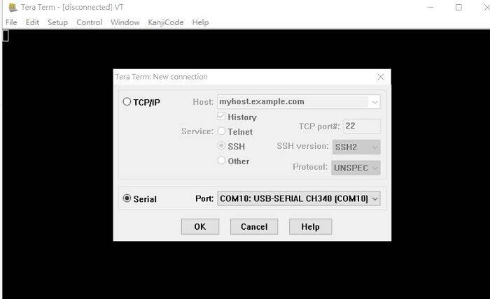

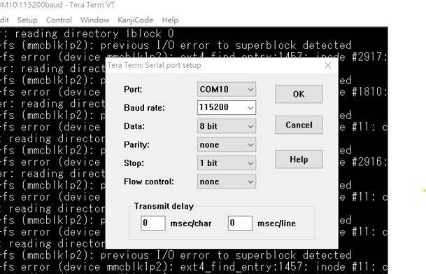

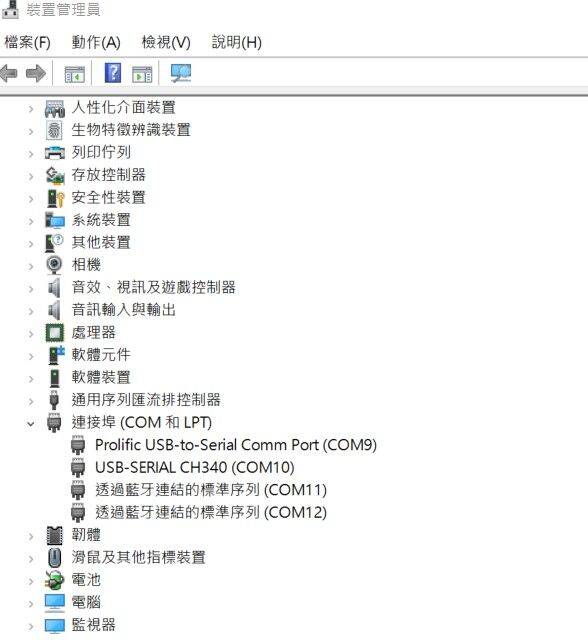

Debug 串口調試 (Debug port Setting)​
以 Tera Term  为例介绍如何使用串口调试功能
Tera Term Tool
RTENOTITLE
RTENOTITLE
Check the Sriel port in Device Manager (查看PC端的串口号):
if you can not identify the Serial device , please check your serial driver.
RTENOTITLE
Debug port connection (串口連接)
Log into Terminal  Tool (进入串口调试终端):
RTENOTITLE

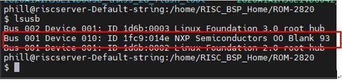

Recovery by UUU Tool  使用方法(Mirco USB Connection (OTG port))​
Connect Mirco USB cable to USB OTG port.
RTENOTITLE
Change boot switch to "SW1001 " to boot from force recovery mode.
RTENOTITLE
Serial download:1on , 2 off
Download uuu tool from link below:
Releases · nxp-imx/mfgtools (github.com)
The uuu verison we tested is 1.4.193: uuu
uuu (Universal Update Utility) for nxp imx chips -- libuuu_1.4.193-0-ge56424c

Connect OTG to Ubuntu System(x86 PC)  , make sure the device was identified
RTENOTITLE

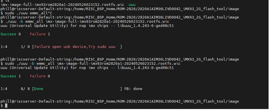

Type command below to flash eMMC:
tar -xvzf 2820A1AIM36LIVD0042_iMX93_2G_flash_tool.tgz
cd 2820A1AIM36LIVD0042_iMX93_2G_flash_tool/image/
sudo ./uuu -b emmc_all imx-image-full-imx93rom2820a1-20240321094239.rootfs.wic
RTENOTITLE

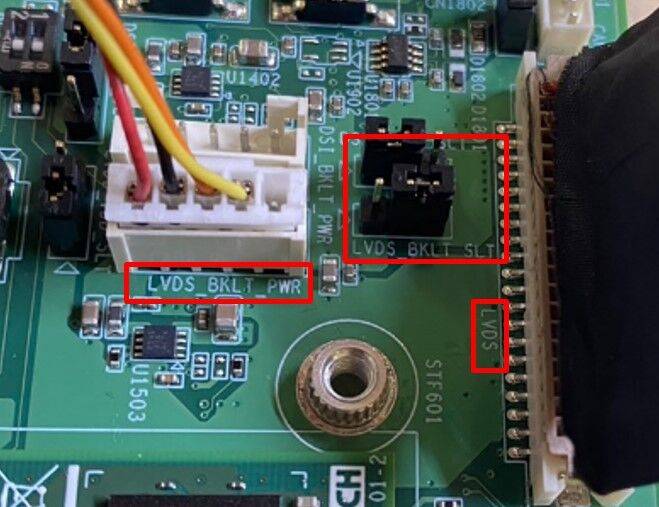

LVDS​
Single Channel LVDS: G070VW01 (VDD: 3.3V, Backlight Power: 12V)
Step 1: Connect G070VW01 LVDS panel with the LVDS cable. Connect this to the LVDS. Connect the Backlight cable to LVDS_BKLT_PWR.
Step 2: Connect another 12V adapter to the DC-Jack on the backlight cable.
Step 3: Power on RSB-2820 and the extra 12V adapter.

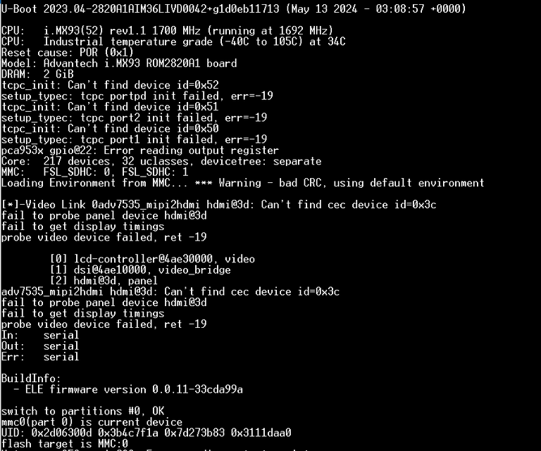

Step 4: Press enter after boot. The system will stop at u-boot as demonstrated below, enter the command in red and press enter.
RTENOTITLE
(LVDS_BPLT_SLT : 2&3 jumper short)
Normal Boot
Hit any key to stop autoboot:  0
=> setenv fdtfile imx93-rom2820-a1-lvds.dtb
=> saveenv
=> boot

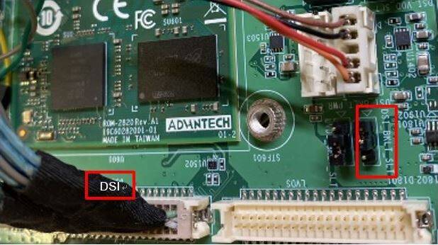

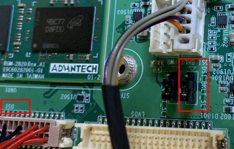

MIPI DSI​
Single Channel LVDS: G101UAN02.0 (VDD: 3.3V, Backlight Power: 12V)
Step 1: Connect G101UAN02.0 LVDS panel with the LVDS cable. Connect this to theLVDS. Connect the Backlight cable to DSI_BKLT_PWR.
RTENOTITLE
(DSI_BKLT_SLT: 2&3 jumper short)
Normal Boot
=> setenv fdtfile imx93-rom2820-a1-auog101uan02.dtb
=> saveenv
=> boot

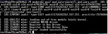

Step 3: Install driver by below command.
modprobe moal mod_para=nxp/wifi_mod_para.conf
RTENOTITLE

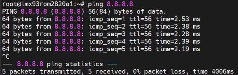

# pppd connect 'chat -v -s -t 10 "" "AT" "" "ATDT*99#" "CONNECT" ""' user username password password /dev/ttyUSB2 460800 nodetach crtscts debug usepeerdns defaultroute &
# ping 8.8.8.8
64 bytes from 8.8.8.8: icmp_seq=1 ttl=56 time=222 ms

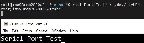

  • RS-232 Loopback Test (eg. COMA: ttyLP0):
Step 1:. Connect loopback with COMA(ttyLP4)&COMB(ttyLP5)
Step 2: Run test command.
stty -F /dev/ttyLP4 -echo -onlcr 115200
cat /dev/ttyLP4 &
echo "Serial Port Test" > /dev/ttyLP4

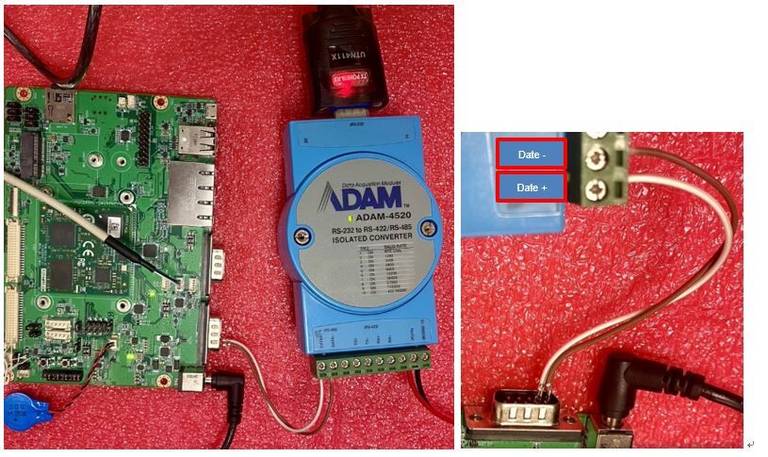

RS-485​
RS-485 Test:
Step 1: Test RS-485 with Adam-4520. Connect Adam-4520 with COMA with DB9 as the following(COMA(ttyLP4)&COMB(ttyLP5))
Adam-4520 RX- ROM-2820 COMA DB9 Pin  1,
Adam-4520 RX+ ROM-2820 COMA DB9 Pin  2,
Adam-4520 TX- ROM-2820 COMB DB9 Pin   1,
Adam-4520 TX+ ROM-2820 COMB DB9 Pin  2
RTENOTITLE
Step 3: Run below command:
stty -F /dev/ttyLP0 speed 115200 ignbrk -brkint -icrnl -imaxbel -opost -onlcr -isig -icanon -iexten -echo -echoe -echok -echoctl -echoke
cat /dev/ttyLP0 &
echo "Serial Test" > /dev/ttyLP0
Step 2 :Create the following file and save it as rs485.sh
#!/bin/sh
i2cset -y -f 4 0x21 0x00 0x10
i2cset -y -f 4 0x21 0x01 0x01
i2cset -y -f 4 0x21 0x02 0xdf
i2cset -y -f 4 0x21 0x03 0xfd
i2cset -y -f 4 0x21 0x04 0x00
i2cset -y -f 4 0x21 0x05 0x00
i2cset -y -f 4 0x21 0x06 0xcf
i2cset -y -f 4 0x21 0x07 0xfc
# sudo chmod 775 rs485.sh
# ./rs485.sh
# stty -F /dev/ttyLP4 -echo -onlcr 115200
# cat /dev/ttyLP4 &
# echo "Serial Port Test" > /dev/ttyLP4
Step 4: You need to open two terminals: one to connect to the debug port of the ROM2820, and the other to connect to the Adam-4520.
Step 5:You can send data from the ROM2820's debug port to the Adam-4520, and you can also input text from the Adam-4520's terminal using the keyboard so that the ROM2820's debug port can receive it.
RTENOTITLE

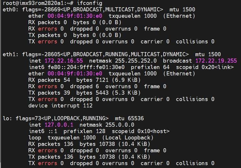

乙太網路使用方法(Ethernent Testing Method)​
Command : ifconfig
RTENOTITLE
Command: Ping - I eth1 8.8.8.8  or Ping - I eth0 8.8.8.8
RTENOTITLE

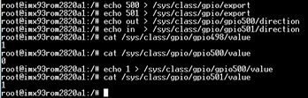

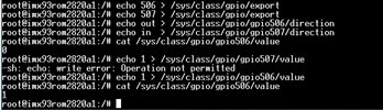

GPIO loop test:
Connect GPIO pin#3 and GPIO pin#4
root@imx93rom2820a1:/# echo 498 > /sys/class/gpio/export
root@imx93rom2820a1:/# echo 499 > /sys/class/gpio/export
root@imx93rom2820a1:/# echo out > /sys/class/gpio/gpio498/direction
root@imx93rom2820a1:/# echo in > /sys/class/gpio/gpio499/direction
root@imx93rom2820a1:/#cat /sys/class/gpio/gpio498/value
0
root@imx93rom2820a1:/# echo 1 > /sys/class/gpio/gpio498/value
root@imx93rom2820a1:/# cat /sys/class/gpio/gpio498/value
1
RTENOTITLE
Connect GPIO pin#5 and GPIO pin #6
root@imx93rom2820a1:/# echo 500 > /sys/class/gpio/export
root@imx93rom2820a1:/# echo 501 > /sys/class/gpio/export
root@imx93rom2820a1:/# echo out > /sys/class/gpio/gpio500/direction
root@imx93rom2820a1:/# echo in > /sys/class/gpio/gpio501/direction
root@imx93rom2820a1:/# cat /sys/class/gpio/gpio500/value
0
root@imx93rom2820a1:/# echo 1 > /sys/class/gpio/gpio500/value
root@imx93rom2820a1:/# cat /sys/class/gpio/gpio501/value
1
RTENOTITLE
Connect GPIO pin#7 and GPIO pin#8
root@imx93rom2820a1:/# echo 502 > /sys/class/gpio/export
root@imx93rom2820a1:/# echo 503 > /sys/class/gpio/export
root@imx93rom2820a1:/# echo out > /sys/class/gpio/gpio502/direction
root@imx93rom2820a1:/# echo in > /sys/class/gpio/gpio503/direction
root@imx93rom2820a1:/# cat /sys/class/gpio/gpio502/value
0
root@imx93rom2820a1:/# echo 1 > /sys/class/gpio/gpio502/value
root@imx93rom2820a1:/# cat /sys/class/gpio/gpio503/value
1
RTENOTITLE
Connect GPIO pin#9 and GPIO pin#10
root@imx93rom2820a1:/# echo 504 > /sys/class/gpio/export
root@imx93rom2820a1:/# echo 505 > /sys/class/gpio/export
root@imx93rom2820a1:/# echo out > /sys/class/gpio/gpio504/direction
root@imx93rom2820a1:/# echo in > /sys/class/gpio/gpio505/direction
root@imx93rom2820a1:/# cat /sys/class/gpio/gpio504/value
0
root@imx93rom2820a1:/# echo 1 > /sys/class/gpio/gpio504/value
root@imx93rom2820a1:/# cat /sys/class/gpio/gpio505/value
1
RTENOTITLE
Connect GPIO pin#11 and GPIO pin#12
root@imx93rom2820a1:/# echo 506 > /sys/class/gpio/export
root@imx93rom2820a1:/# echo 507 > /sys/class/gpio/export
root@imx93rom2820a1:/# echo out > /sys/class/gpio/gpio506/direction
root@imx93rom2820a1:/# echo in > /sys/class/gpio/gpio507/direction
root@imx93rom2820a1:/# cat /sys/class/gpio/gpio507/value
0
root@imx93rom2820a1:/# echo 1 > /sys/class/gpio/gpio506/value
1
RTENOTITLE
