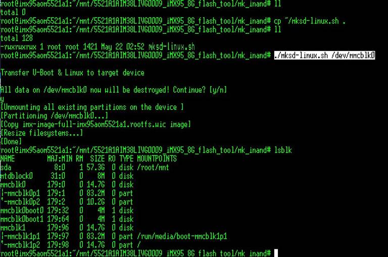

  1. 將U盤連接到AOM-5521系統, 進入flsah tool下的mk_inand資歷夾, 執行指令./mksd-linux.sh /dev/mmcblk0燒錄image到eMMC(Connect USB Disk to AOM-5521 system, browser to mk_inand folder and execute flash shell script "./mksd-linux.sh /dev/mmcblk0"
如果mk_inand資料夾下沒有mksd-linux.sh檔案, 請到以下連結下載並複製到mk_inand下(Please download the mksd-linux.sh file from the link below if there is no script file in mk_inand deiectory)
Download mksd-linux.sh in <https://github.com/ADVANTECH-Corp/RISC_tools_scripts/blob/mickledore/imx8/mksd-linux.sh>
AOM-5521
SD card/dev/mmcblk1
eMMC/dev/mmcblk0
# ./mksd-linux.sh /dev/mmcblk0
RTENOTITLE
  1. 切換開機switch 1:on 2,3,4,5,6:off來設定成從eMMC開機(Change boot switch to "1:on 2,3,4,5,6:off" to boot from eMMC. Reboot system).

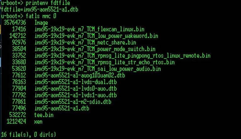

Display Setting (ROM-5722)​
Ex:
list dtb files in u-boot:
=> fatls mmc 0
RTENOTITLE
=> setenv fdtfile imx95-aom5521-a1-lvds0-auo.dtb
U-boot Command :
  • Display
    • HDMI (default)
      • imx95-aom5521-a1.dtb
    • LVDS
      • g070vw01(LVDS0)
        • imx95-aom5521-a1-lvds0-auo.dtb
      • g070vw01(LVDS1)
        • imx95-aom5521-a1-lvds1-auo.dtb
      • g215hvn01(DUAL LVDS)
        • imx95-aom5521-a1-lvds-dual.dtb
    • DSI
      • auog101uan02(DSI)
        • imx95-aom5521-a1-auog101uan02.dtb
  • Camera
    • OV5640 (default)

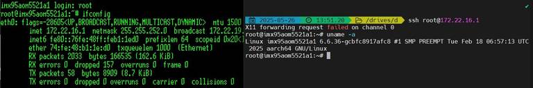

乙太網路使用方法(Ethernent Testing Method)​
Command: ifconfig
Command: Ping - I eth1 8.8.8.8  or Ping - I eth0 8.8.8.8
AOM-5521_eth0
AOM-5521_eth1

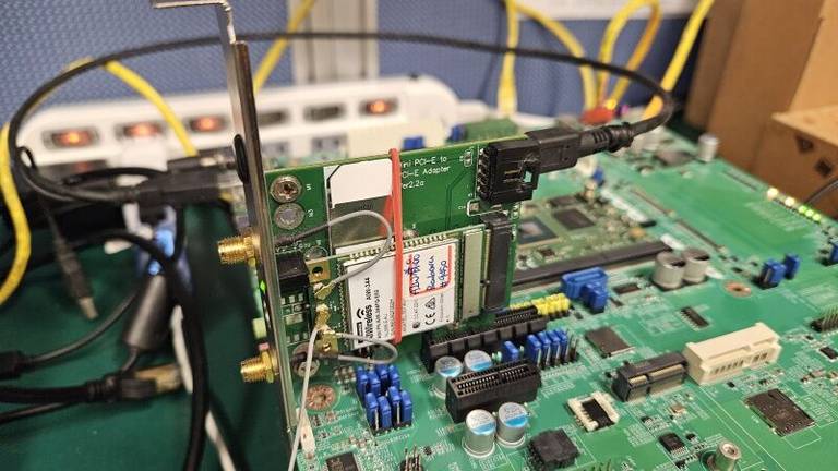

WiFi使用方法(WIFI Testing Method)​

Load dtb file in u-boot:
=> setenv fdtfile imx95-aom5521-a1-m2-sdio.dtb; boot

4G使用方法(4G Testing Method)​
Test with AIW-344(Full-size mPCIe USB interface): Connect to PCIe x4 slot and mini USB to TypeA

**查看主板IP位址 ( Chech IP Address ):**​
        Command: ifconfig
Windows下SSH访问及文件传输​
SSH Remote Log into Device
  • SSH远程登录,以putty选择putty.exe(或者使用Xshell、SecureCRT等类似软件)
  • 需要设置远程设备的IP、通讯端口(默认22)、通讯方式,登录后验证用户名密码
