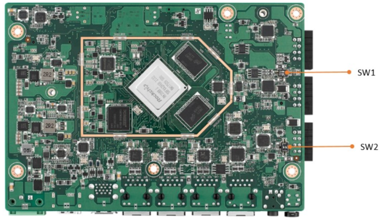

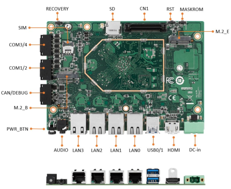

ASR-A501接口布局图 Board Dimension Layout​

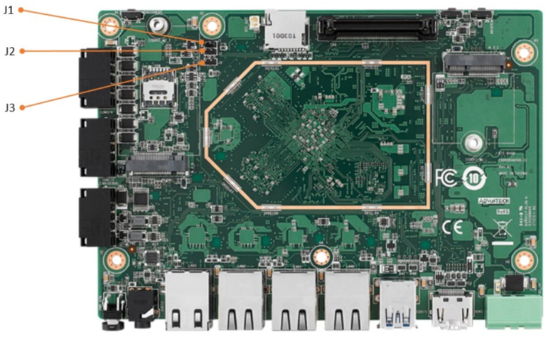

Jumper List
PositionDescription
[SW1]COM2/4 485 Terminal
[SW2]CAN FD Terminal
[J1]USB0 OTG Mode selection,default USB3.0 host
[J2]ATX/AT Mode Selection,defa
