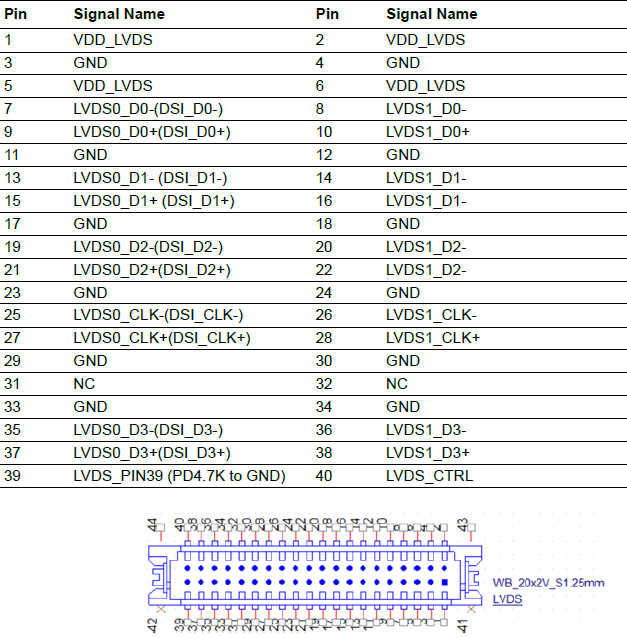

LVDS Connector (LVDS)
RSB-3730 provides a LVDS 20x2-pin board-to-board connector for one port single channel 24 bit LVDS or one port dual channel 24bit LVDS,or four lanes MIPI DSI by bom option.

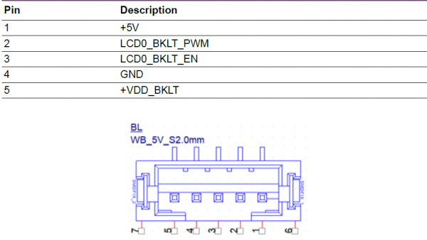

LVDS Inverter Power Connector (BL)
For avoid to damage LCD panel, please make sure set a right voltage level before power on while connecting a LVDS panel (refer to jumper setting description for BL and LCD datasheet that you will use).
