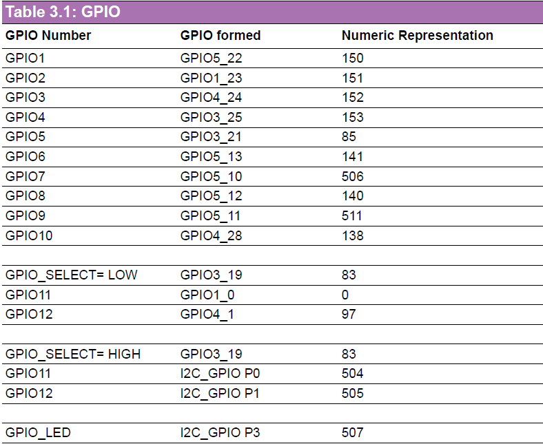

The IMX8MM bank/bit notation for GPIOs must be formed as "GPIO<GPIO_bank>_<gpio_bit>". The numeric value of GPIO is calculated as follows:
gpio_bit : 0~31 E.g. GPIO5_22 becomes 150
“GPIO11” and “GPIO12” can be controlled by the CPU or by the i2c extended gpio based on the high and low levels of “GPIO_SELECT”.
