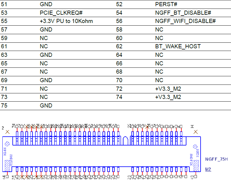

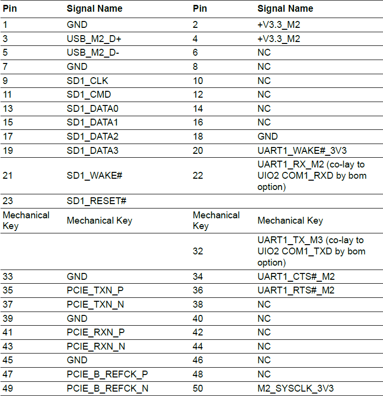

RSB-3730 supports socket1 connectivity type 2230 S1&S2&S3 key E M.2 interface. The detailed pin-define as below.
