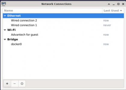

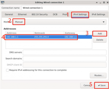

  1. Click “Applications” -> “Settings” -> “Advanced Network Configration”.
2. Double-click “Wired Connection 1” to configure it.

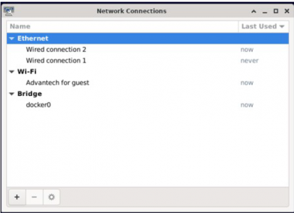

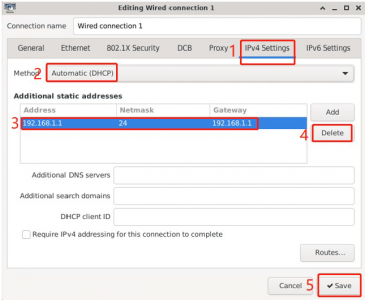

1. Click “Applications” -> “Settings -> “Advanced Network Configration”.
