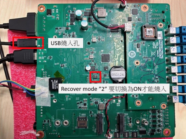

  1. Enter recovery mode
    Set the recovery switch (position 2) to ON and press the power button.
    AFE-R750 recovery switch
  2. Connect the board to a Linux host via the USB flash cable and confirm detection:
    lsusb
    # Bus 001 Device 024: ID 0955:7223 NVIDIA Corp.
