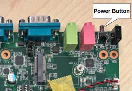

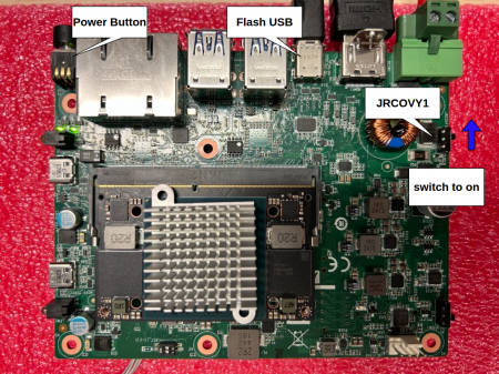

  1. Change the JRCOVY1 switch to ON and press the power button to enter recovery mode.
  2. Connect a Linux host to the AIR-021 with the USB flash cable and verify the device is detected:
    lsusb
    # Bus 001 Device 024: ID 0955:7223 NVIDIA Corp.

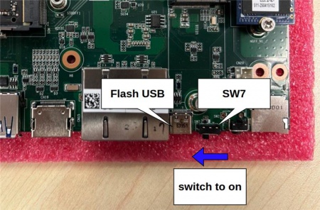

  1. Change the SW7 switch to ON and press the power button to enter recovery mode.
    DS-015 recovery switch
  2. Connect a Linux host with the USB flash cable and confirm the device is detected:
    lsusb

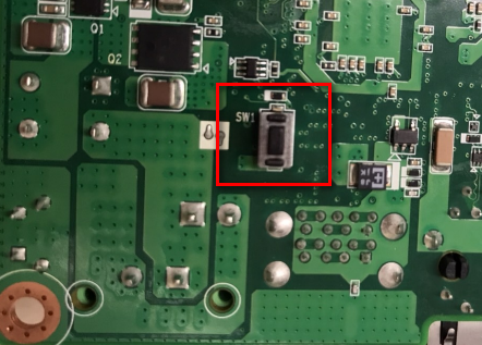

  1. Press the SW1 button while powering on EPC-R7300, or run the following command from the device to enter recovery mode:
    sudo reboot --force forced-recovery
    EPC-R7300 recovery switch

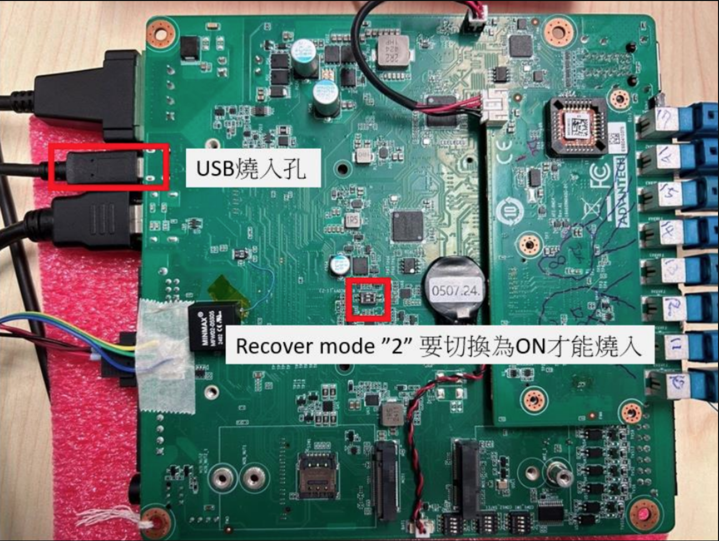

    AFE-R750 recovery switch
    lsusb
  3. Unpack the release tarball and enter the flashing tools:
    sudo tar -zxvf AFE-R750_XXX.tar.gz
    cd Linux_for_Tegra
