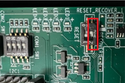

  1. Enter recovery mode
    Toggle SW2 to ON and press the power button.
    AIR-030 recovery switch
