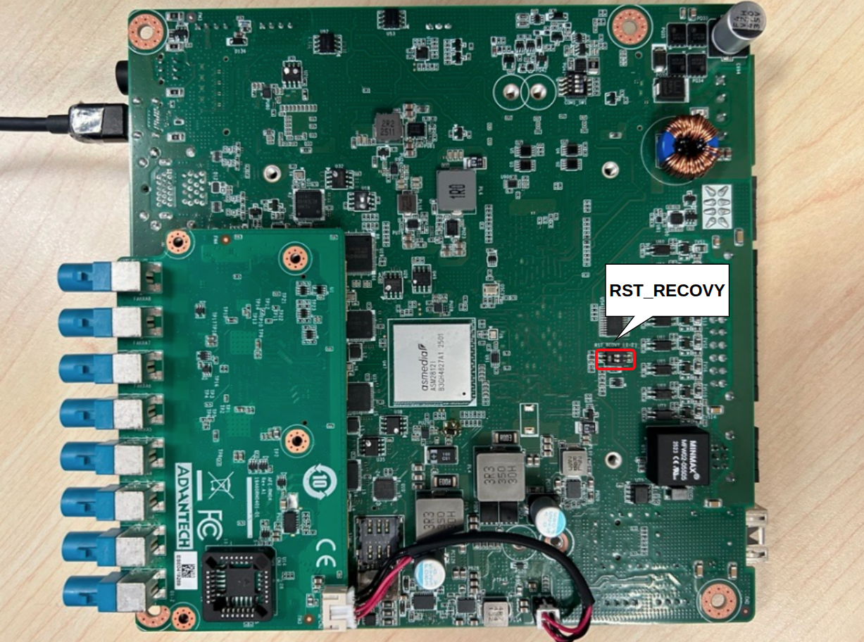

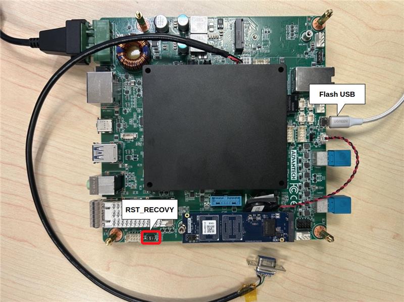

Recovery mode & wiring​
  1. Set the RST_RECOVY "2" DIP switch to ON and power on the board.
  2. Connect the host PC to the AIMB-294 recovery USB Type-C port.
  3. Verify detection:
    lsusb
    # Bus 001 Device 024: ID 0955:7223 NVIDIA Corp.

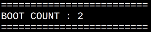

  • Boot-count cycling: install the helper once, then remove the counter file when you want to reset the tally.
    cd /home/ubuntu
    sudo ./bootCount.sh # install service (first boot only)
    # ... device will power cycle after 20 seconds automatically ...
    rm bootCount.tt # reset counter if needed

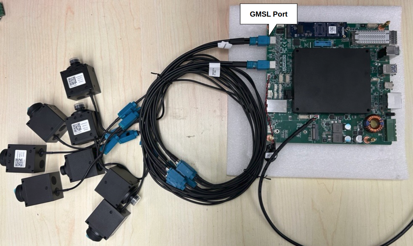

Camera / GMSL validation​
AIMB-294 GMSL camera wiring
cd /tools/approcam/gmsl
sudo ./set_approcam_gmsl.sh # install driver
cd /home/ubuntu
sudo ./enable-approcamera.sh # preview IMX335 stream

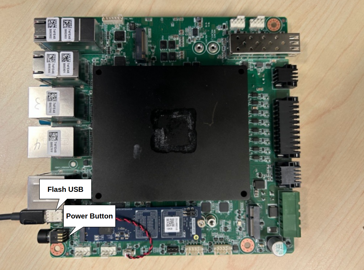

  1. Toggle the RST_RECOVY "2" switch to ON and press the power button.
  2. Connect a USB Type-C cable between the host and ASR-A702.
  3. Confirm detection with lsusb (NVIDIA 0955:7223).
ASR-A702 recovery switches ASR-A702 recovery wiring

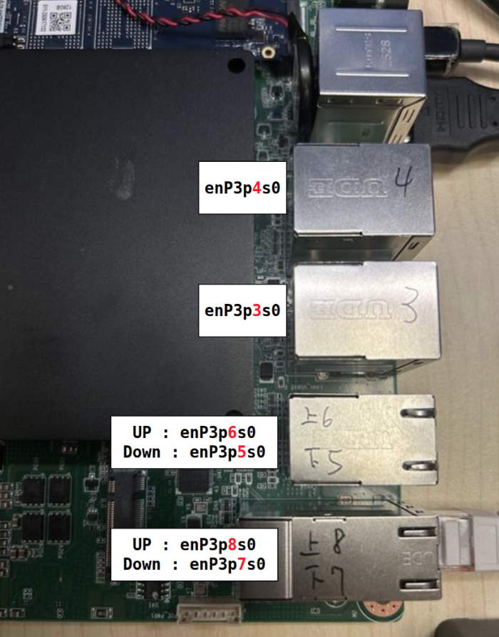

MAC address programming (Intel I226)​
One-time operation. Each NIC only accepts a MAC address once. Double-check the value before flashing.
  1. Download and copy the I226 flash tool to the device.
  2. Extract and program each interface:
sudo tar zxvf LAN_I226_ASR-A702.tar.gz
cd LAN_I226_ASR-A702/I226_Flash_Tool
sudo su
./EepromAccessTool
setpci -s 0003:03:00.0 COMMAND=0003
./EepromAccessTool -nic=1 -f=FXVL_125C_V_2MB_2.36.1.bin -mac=<MAC1>
# repeat nic=2..6 using COMMAND=0004..0008 and MAC2..MAC6
ASR-A702 I226 mapping

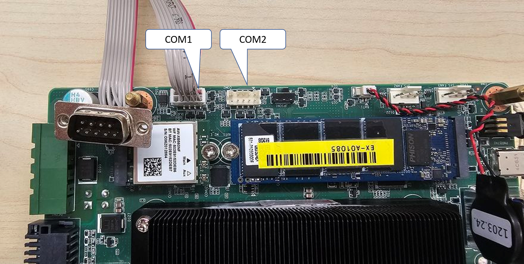

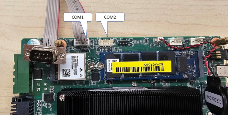

UART mapping​
  • Thor COM1: /dev/ttyAMA9
  • Thor COM2: /dev/ttyAMA10
ASR-A702 COM port sysfs mapping

  • UART mode switching: COM1 (/dev/ttyAMA9) and COM2 (/dev/ttyAMA10) can be toggled among RS-232/422/485. Adjust jumpers per the ASR A702 Development diagrams and rerun your UART test scripts.
