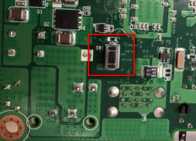

  1. Enter recovery mode
    Press SW1 while powering on, or run:
    sudo reboot --force forced-recovery
