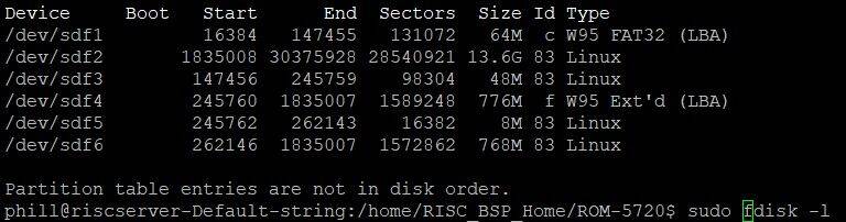

Step0: 檢查SD卡在Linux 環境的代號 (check SD card symbol in Linux system)
Check SD card symbol

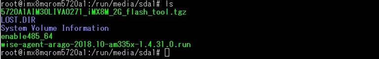

Step 5: Yocto 系統會自動掛載 U盤 在 /run/media/sda1 下
Auto mount USB
並拷貝 5720A1AIM30LIVA0271_iMX8M_2G_flash_tool.tgz 到根目錄 (copy the file into Yocto system)
cp -a 5720A1AIM30LIVA0271_iMX8M_2G_flash_tool.tgz /

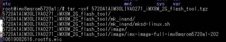

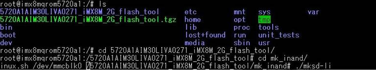

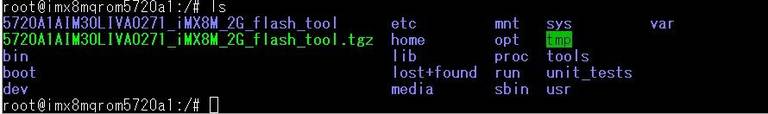

在Yocto 系統中解壓縮 (Unzip the file in Yocto system on ROM-5720)
Unzip flash tool
Copy and unzip

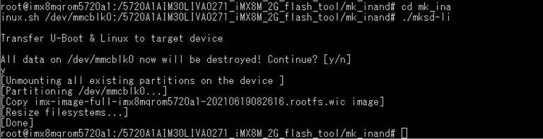

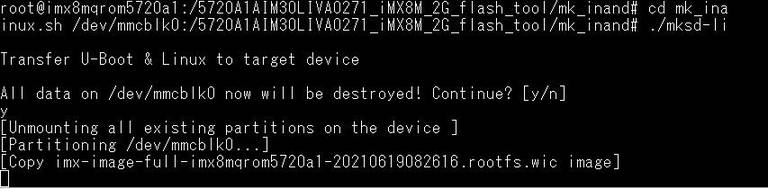

Step 6. 燒錄eMMC 鏡像 (flash image into eMMC flash by flash tool file)
./mksd-linux.sh /dev/mmcblk0
Flash eMMC start
Flash eMMC progress
Step 7. 結束燒錄後, 請改變撥碼開關至 1 on, 其他 off (eMMC開機模式) (Finish the flash process, please change the switch (SW1) to 1 on, others off)
Flash eMMC finish

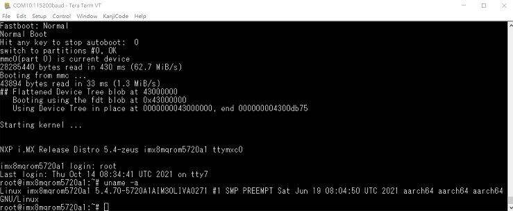

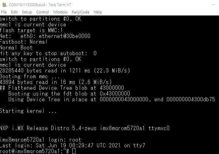

Step 8. 重新上電開機 (Turn on the power, then check the Debug message)
Boot from eMMC

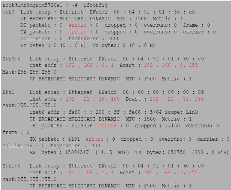

Command: ifconfig
ifconfig output

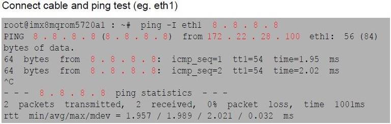

Command: ping -I eth1 8.8.8.8
Ping test

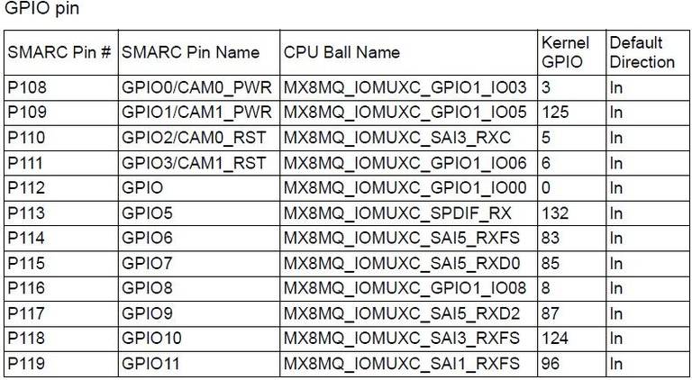

GPIO使用方法(GPIO Operating Method)​
GPIO loopback test
# Loop-back Test (Take GPIO4 and GPIO5 as examples)
# Step 1: Connect GPIO4 and GPIO5
# Step 2: Export GPIO interface
echo 0 > /sys/class/gpio/export
echo 132 > /sys/class/gpio/export
# Step 3: Set direction
echo out > /sys/class/gpio/gpio1/direction
echo in > /sys/class/gpio/gpio2/direction
# Step 4: Read value and set output value then check
cat /sys/class/gpio/gpio2/value
# 1
echo 0 > /sys/class/gpio/gpio1/value
# 0
