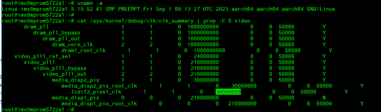

Check the LVDS output clock:
cat /sys/kernel/debug/clk/clk_summary | grep -C 5 video
